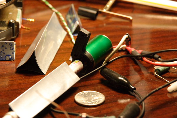

Picture below is one of my first prototypes without homing magnet.
Setup was iMac (itunes with test tones and sweeps, eq off) -> simple few watt amp salvaged from a old computer speaker system (altec lansing) -> HDD head engine. Playing 10khz-17khz tones are clearly audible, higher not anymore. Not sure it was the amp failing, or my ears, or just that it didn't output anymore.
Sound: the bearing allowed for to much forward/backward motion. That had a negative impact on sound and spl's in the low/mid region. Using frequency sweep there where 4 big resonance peaks audible. Disassembled the prototype, tested with only the HDD. same result. So it was the engine that gave that uneven spl output.
What my prototype did learn me so far is that due to it's construction it could handle much greater power to make bigger air "moves". Also that you have to be careful about generating surface vibrations, which creates sound like the NXT speaker technology. The last has a very negative influence in the sound (cancellation). Because when the above
applies. The biggest delta p happens when the triangle is moving fastest (Greatest angular acceleration) and not when it's standing still at each end of the rotation. But other speakers have the highest delta P at it's outward position. So you could talk of a kind of phase difference when Planot and pistionic speakers are compared.
The surface vibrations seems to cancel out the sound due to the phase difference. I could hear differences listening close to the diagram when the ear was held near the point (cleaner sound) or held near the flat side (NXT kinda sound). Because of restrictions in available material, i used a wooden rectangular rod instead of triangle.

All ready started building a new prototype. Gone try the push/pull with normal speaker spider first. But at first sight, the rotation angle is gone be quite low.
Here some pictures:
Speaker donor
Removed cone and added a crossbar; gone add a rod to it later that connects to the diagram later:
Frame: Old Ikea CD holder.
Added the diagram rotor; only have to figure out how to attach the driver somewhere in the middle.
Close up of the cheapest bearing made of 5,5 cm skewer and filed with oil. Runs quit well. Only have to replace the bottom one because it's splintert when it was cut. Result is that there is a scrapping noise if it starts to turn. Also this solution would not be the longest lasting option out there. If i have to money, i would like to try the altmann bearing, which is gone cost me about €113 ($158).

BLDC motors anyone?
The mention of magnet motors gave me the idea of using brushless motors for a planot-like prototype. I'll be the first to say that my attempt is nothing like planot and the poor results are my own doing. Just wanted to share in the hopes of inspiring someone else.
Being into mini RC, I had an old Mamba motor to try this out. The motor is a three phase motor. As such there are three sets of coils, only two sets were used.
In the attached pic the motor (green can) is attached to a motor mount. The shaft is attached to a pinion gear which is attached to plastic pen tube, over the tube is the triangle formed from a soda can. For testing the motor mount was vise-griped to table. Used an old JVC 100 watt receiver to power it. Volume passed half-way would trip the JVC. Not unexpected since it is a motor and impedance is badly mismatched. The motor is also busted, that is some of the windings are shorted, had to continually re-orient the shaft to get better sound.
The BAD:
Efficiency was to say dismal compared to conventional speaker. Hardly any sound when listening even 1 inch away. Sound was mostly midrange and badly equalized at that. The low end can only be heard and felt from the table, nothing from the triangle. To ease removal and testing, the triangle was not glued on. This contributed to the poor performance.
The Good:
Using larger size triangles did improve volume. On low to moderate volume, the triangle kept orientation for the most part, thus a "surround/spider" magnet set was not used. Pressing the pen tube (triangle removed) against the backside of my ear, produced much better sound, the response favored the lowend but mid and highs were present. Stanglely enough biting down on the pen tube was also audible, very weird sensation hearing music through your mouth! I could sense (both tactile methods ear/mouth) 15hz-13khz with a sharp drop at the high end.
Thoughts:
Sound from BLDC motors is possible at least in a tactile way. Stereo Tactile headphones using BLDC is certainly doable, hmmm wonder if a there is a patent in that idea.
Yes, ideally I should have used two motors one at each end, but I had only one.
Need to scale up. The motor and triangle used are small, both are about 20mm across.
The planot speaker seems to be using an air core(ironless coil), which could be an important factor that both conventional speakers and BLDC motors cannot match.
The BAD:
The Good:
Thoughts:
More on BLDC:
http://www.allegromicro.com/en/Products/Design/compumot/a17a19.pdf
