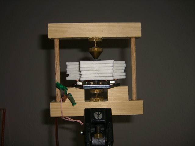

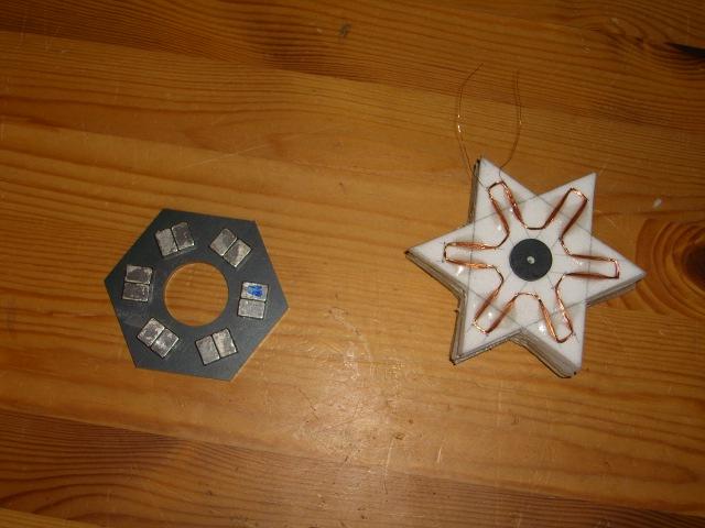

Here is my implementation of a pivoting speaker:

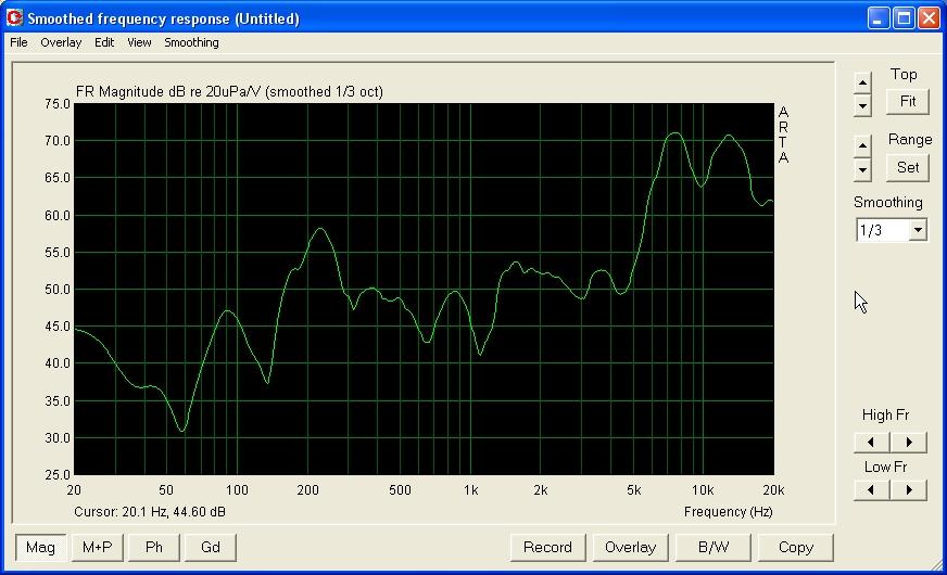

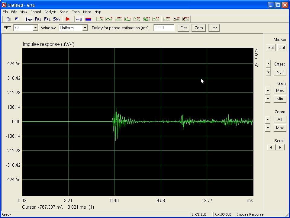

I find the interpretation a bit tricky. Is the break in the frequency response around 5kHz a result of the acoustic short circuit (which would be the proof that the Planot-principle doesn´t work) or is it the breakup frequency above which there are running waves through the Rohacell star?
Measuring from different locations while playing a continuous tone could show you if the dip is resulting from a cancellation in-air after leaving the driver.
Playing a sweep on a nearby loudspeaker and then measuring the current induced on the coil (basically using the driver as a microphone) may reveal some resonances of the driver itself.
Looking at your implementation, I have a few questions:
What is the total mass of your coil?
What is the total mass of your magnets?
It almost appears that they may be of comparable magnitude, but I am seeing only one surface of the magnets.
I don't think you can disprove the "Planot principle" based on your results with a shape other than that outlined by its inventor.
I measured from different positions and there wasn´t much difference. The mass of the star is 10g, the mass of the coil is near to nothing and the magnets are 5mm thick and rest on 5mm thick iron.
