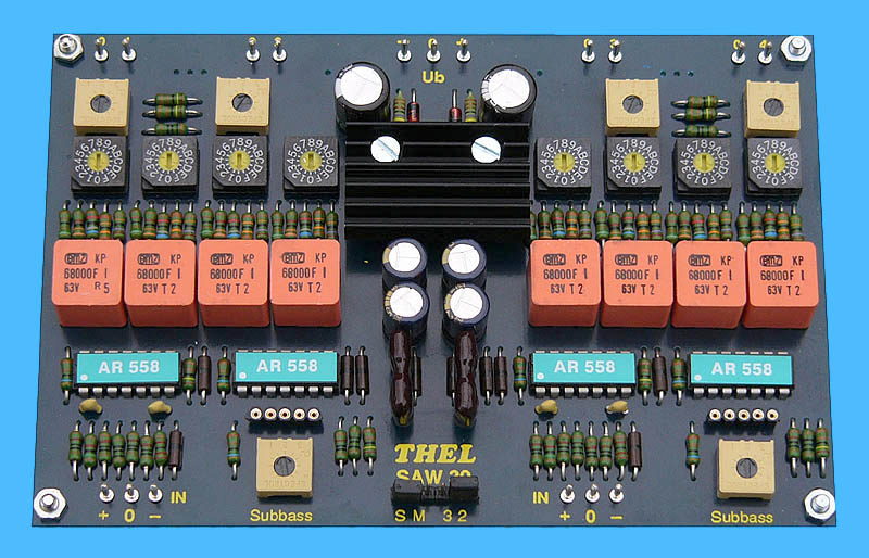

The filter. Thel supplies PCB units.
Just build the in a cabinet and voilà
My filter looks exactly like that internally. Dual mono power supply that is big enoug to drive a small power stage. 😎

I went to the thel site and while it looks like they have some interesting (Velleman type) stuff, all the language was intelligible, though it did make me think of tall pretty blondes on the side of a ski slope. 🙂
