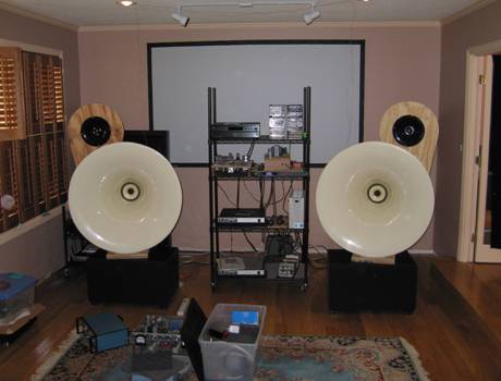

I am using a BSS 366T Omnidrive Compact Plus
It sounds better to my ear than the unmodified Behringer 2496 that I originally used.
Having said that, the BSS unit has more bands that can be used than the Behringer.
If you're using 48DB slopes or 52DB (the BSS offers 52DB NTM slope) you run out of bandwith on the Behringer and can go a lot further with the BSS.
Some really critical listeners prefer the 52 DB slopes in my system.
Active is the way to go, tough to do 48DB at 95 hz passive.
Removing the bands above 956 hz and below 95 hz really bring life to the Lowthers in the Azurahorns
don't forget, you're also removing the bandwidth from the amps.
Am triamping - tube amps on top two levels still not in, using Crowns for now.
NHT1259 Subs
Azurahorns - Lowther DX4s
DDS ENG 90 -1 pro - I inch Wave guide with 1 inch radian compression driver.

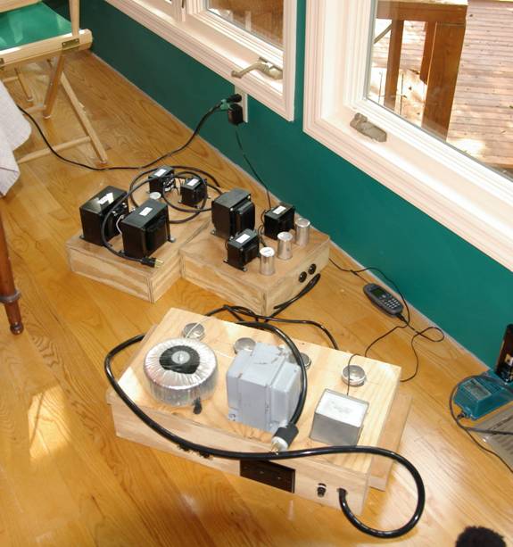

Heard it triamped with tubes on the top two for the first time last weekend.
Had a group of Dixie Bottleheads in that brought a couple of homebrew tube amps with them.
When the tri-ampied tube amps went on-line - everybody got very quiet - listening. Ususally, these guys are yacking so much you can't hear the music.
I would say it's a hit

Essentially I have three seperates.
Two horns and a sealed sub.
While I realize this is DIY forum, IMHO I want to be listening to stuff before I die _grin_. No way I have time to build one, or even time to get into modding A DCX 2496.

Crossover points
Crown amp takes the sealed subs up to 94.4 hz then 52DB cross to
GM70 75th on the Azurahorns with Lowther DX4's the at 964 52DB cross yp
transitioning an amp for Radian 475PB 1" compression drivers up.
A good rule of thumb is to limit horns (other units also?) to a range no more than a decade. IE 96 to 960 or say 200 to 2000
While I should theoretically limit the radian to 10K, I'm not worry about it at this point - I can't hear over that anyhow _grin_
Attached a pic of the filament supply and power supply for the GM70 amp, will attach a pic for the signal chassis if I can figure out how to reduce the size
