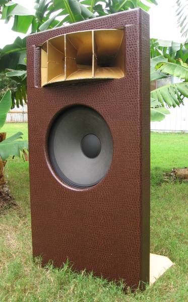

Below is a photo of an open baffle project that I'm working on now. That's a Selenium 15" and an Altec 811 horn. Should be similar to the Silver Iris.

Maybe you should keep it inside, it looks eerily like a tombstone to me outdoors in the open grass

dweekie said:Maybe you should keep it inside, it looks eerily like a tombstone to me outdoors in the open grass
It is! It marks the grave of small drivers and boxy sounding speakers!!
