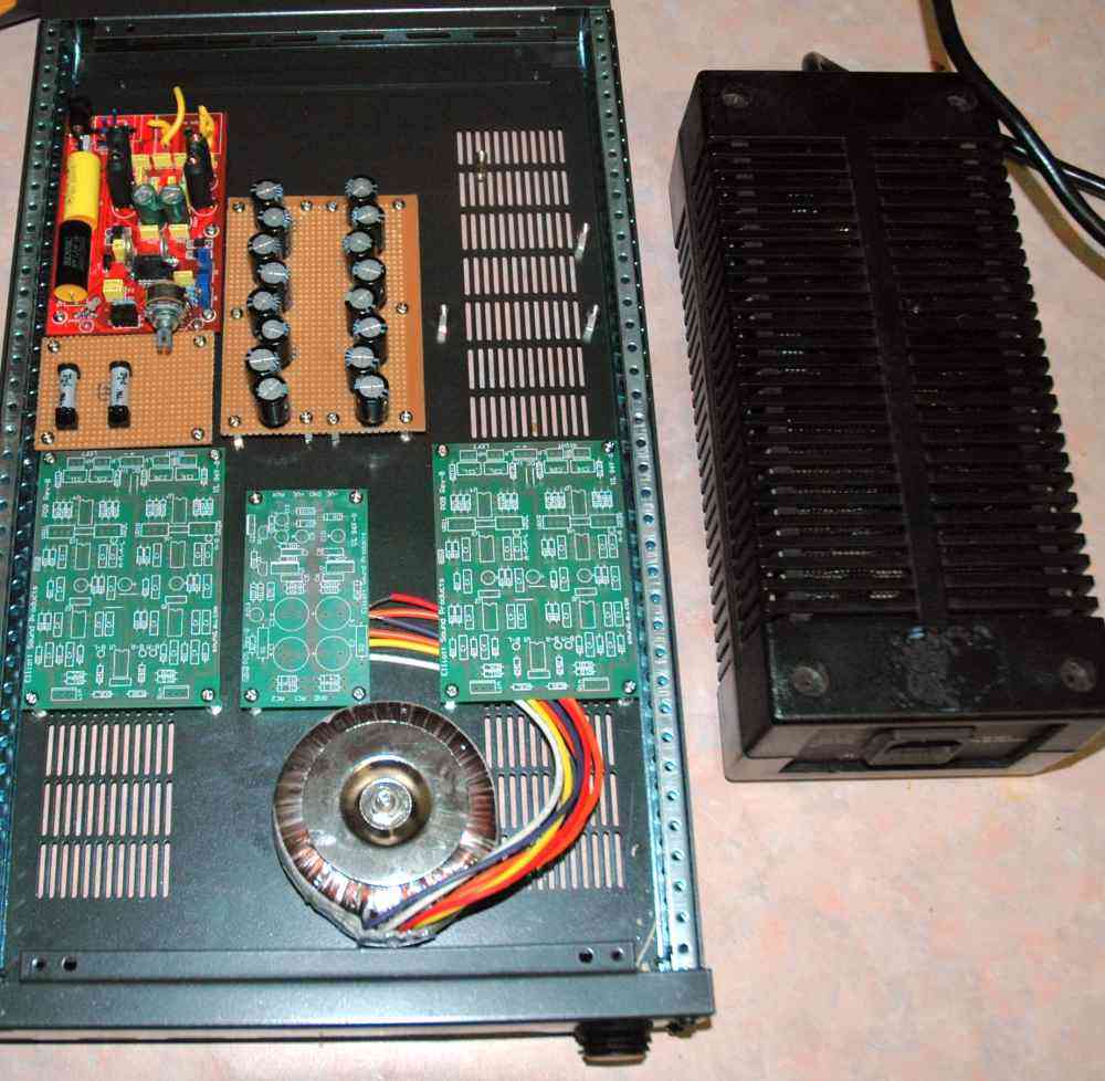

Just to bring it back on topic, I put a few hours into my amp today, Two trends TA10.1 boards with active crossovers.
At the front the transformer and supply board for the crossovers.
The little vero-board in between the crossover board and the amp are muting relays, the input capacitors will be moved to this board as well.
In the middle are two capacitor banks on one moard, each bank is 8000 uF of ultra low ESR capacitors which will be connected via a short wire link straight onto the track on the underside of the trends board in between the trends's power supply caps.
Next to it is the 10 amp continuous SMPS I will be using.
I've used a 1U rack case sideways. A little bit too small but it just fits. I've left room for a big toroid in the front left if I find one, I can then have a 12V discrete supply. there is enough real estate on the capacitor board for some regulators.
The other trends amp is in its original case, note the standoffs ready to mount it. The mounting holes in the board are all over the place.
