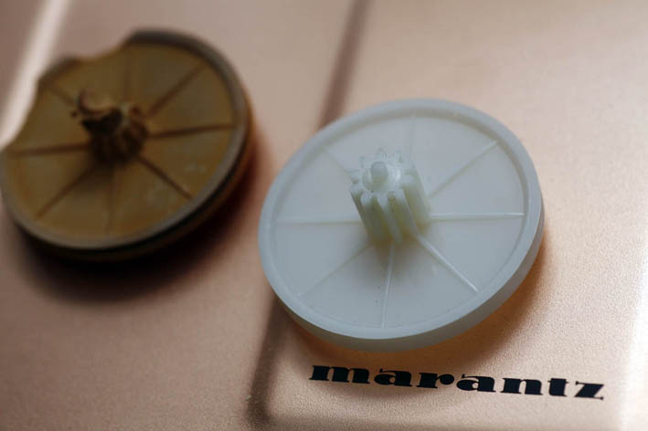

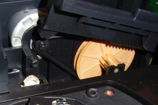

Philips CDM4 / Marantz CD52 tray gear wheel
Same here. I can tell you that the Marantz CD52 uses a CDM-4 chassis and associated tray gear. The CDM-9 gear is not compatible.
Philips no longer supply CDM-4 parts, but the CDM-9 gear wheel is available for those who need one. Part no. 33192. www.chsinteractive.co.uk.
Has anybody come across a CDM-4 gear wheel? Picture attached.
Mike
Mike

Marantz / Phillips CD Tray gears
Gentlemen/Ladies :
As I review the various posts to the threads concerning obvious
manufacturing/design flaws in the tray gears of CDM-4 and
CDM-9 players it really irritates me that no single response
has ever been received from anyone associated with Marantz
or Phillips. The answer to our requests for this cheap plastic
part is that it no longer is in stock or available. You would think that with the numerous posts requesting help in trying to find a source for these gears that someone/anyone from these
companies would have the decency to suggest a path to repairing
these units which many of us have upgraded and do not wish to
trash just because these firms have abdicated their responsibilities to provide for their customers. When we parted with our money to buy these units the least we could/should
expect is that with the knowledge these firms had with the
failure rate of these gears that a source of replacements would
be made available. My Marantz CD-72 has been defective since the mid 90's and it only survives because a local repair shop
cobbled together a fix for the gear. Saul Marantz is turning in
his grave as he observes this forum. D & M Holdings, you should be ashamed.

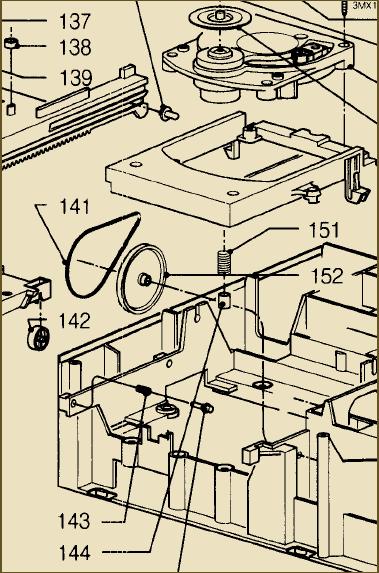

If someone could supply a Philips # like 4822-xxx-xxxxx or position # from the schematic I might be able to find out.
/Hugo

CDM-4 spare parts
Does anyone know where I can find the following CDM-4/19 spare parts:
1) part number 300 40005: it is the pivot plate identified by number 52 in the disassembly diagram in the Rotel 855 service manual.
2) part number 013 40001: the small ball near the centering ring, identified by number 1 in the disassembly diagram
Those parts can also be used and picked from a broken unit.
Thank you.
Best regards.
Paul

Tray Gear For Marantz CD-72 player CDM-4 transport
hi folks
i have found the tray gear for marantz cd-72 in ebay ,free shipping.great news.the seller also has the tray gear for cdm-9.
Item number: 160082024331 anyone who want to repair their cd-player can go to have a look
