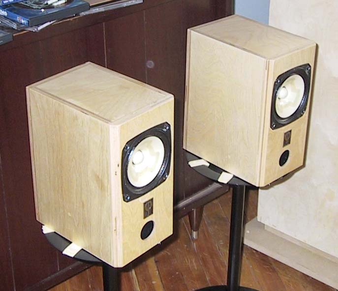

And they don’t have to be big boxes. I learned some valuable lessons from the original mFonken. It took 2 failures before we got it right. The first one was really boxy. No change in driver or alignment.

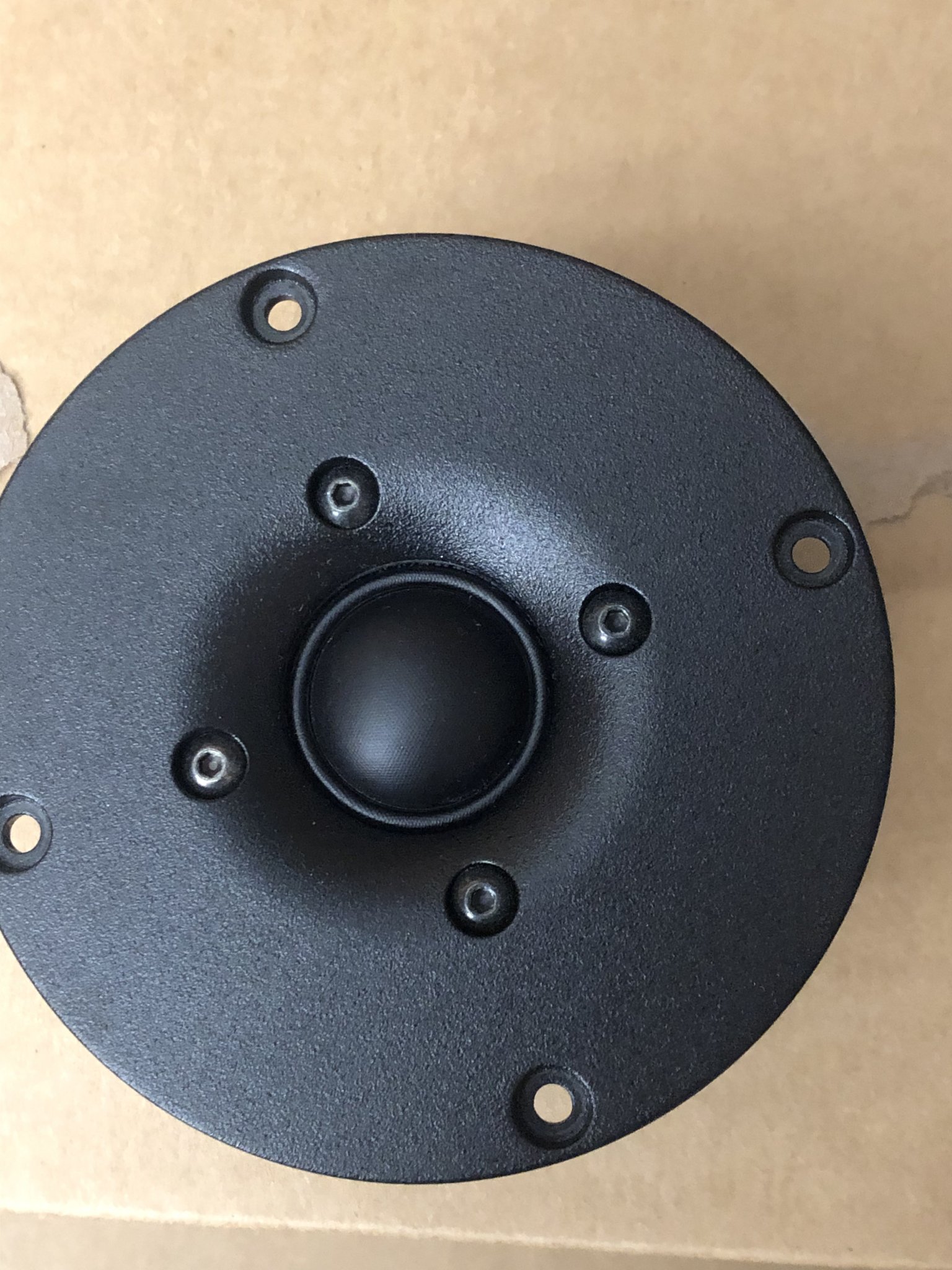

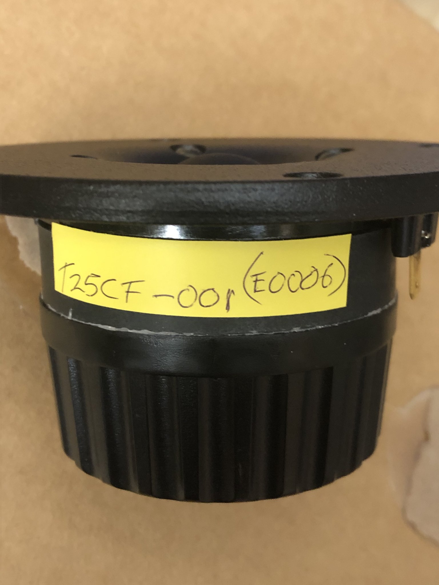

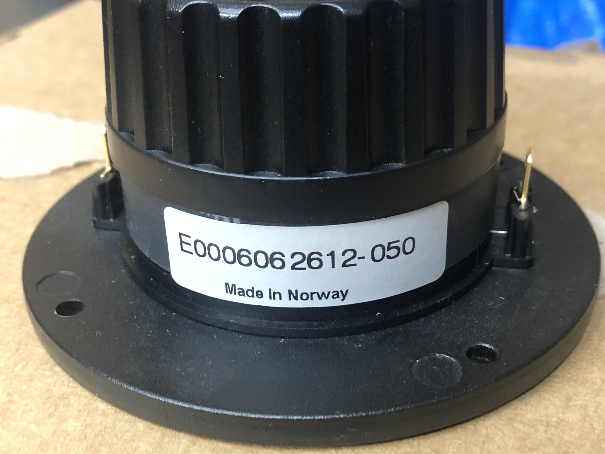

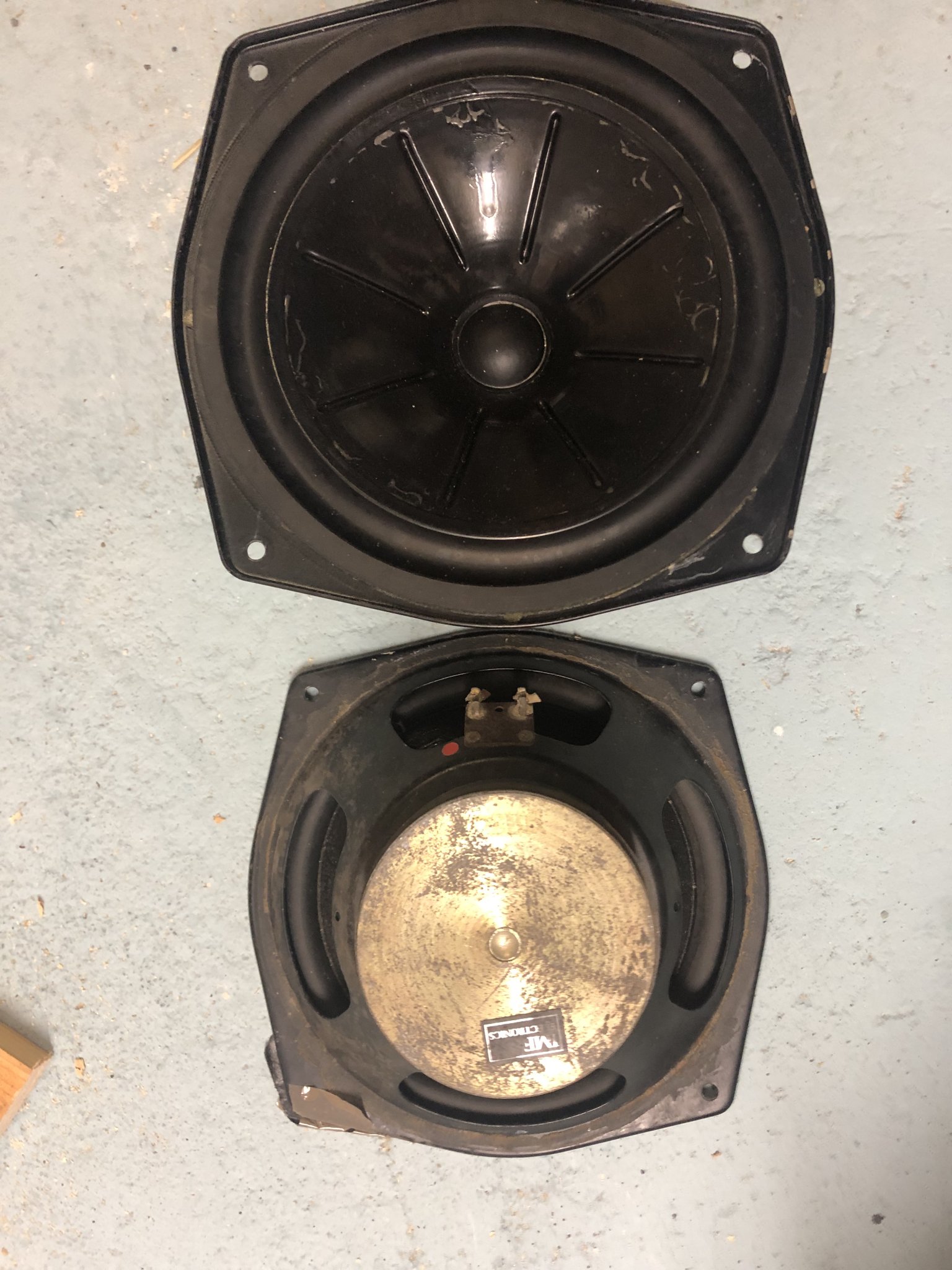

Looking for advice on building a speaker using these units. A SEAS tweeter e0006062612-050 from an ATC 100 speaker and a couple of old IMF units - I am guessing mid/bass the cone is 18cm in dia and the overall width is 21cm. I was thinking of a small transmission line design.

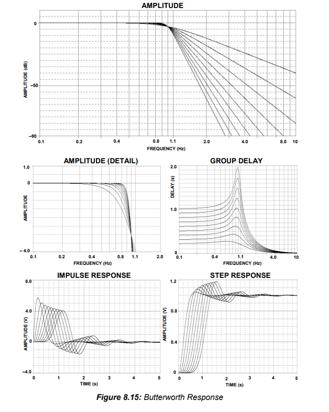

I think @Boden is right though. If you look at filter tables, you'll notice for a given name such as Butterworth, its Q of 0.707 only applies to the 2nd order. A 4th order would have something like 0.54 and 1.3 cascaded, and the step and impulse responses do start to ring, even though the top of the FR plot looks perfectly flat.
What can also be deceiving is that, graphed over time the scale has to be linear, so the ringing appears to fade a lot faster than it would on a log scale.
Link: Analog Chapter8
I am fully aware of this.
I guess it's just how to use the word "ringing", because seen from a system control perspective, nobody would call that ringing.
Just a little bit over overshoot.
Btw, the Q of 0.707 still applies to the higher order transfer functions as well.
But you're correct that it's being created by two other Q factors.
The total Q is still the same though, also because this has to satisfy the fact that for a Q of 0.707, the f0 (resonance freq) is at exactly -3dB.
This is independent of the order of the filter.
