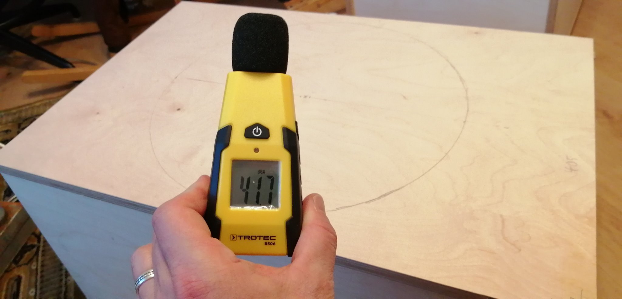

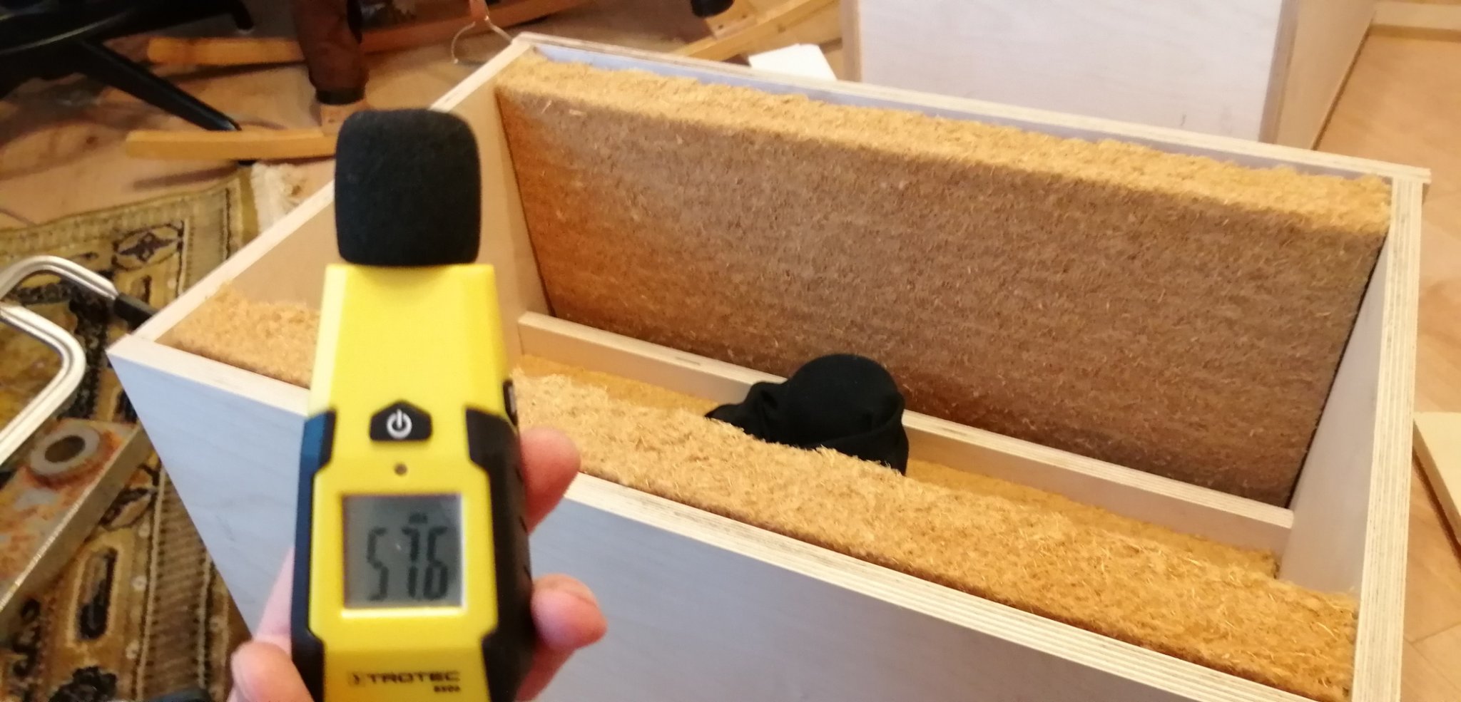

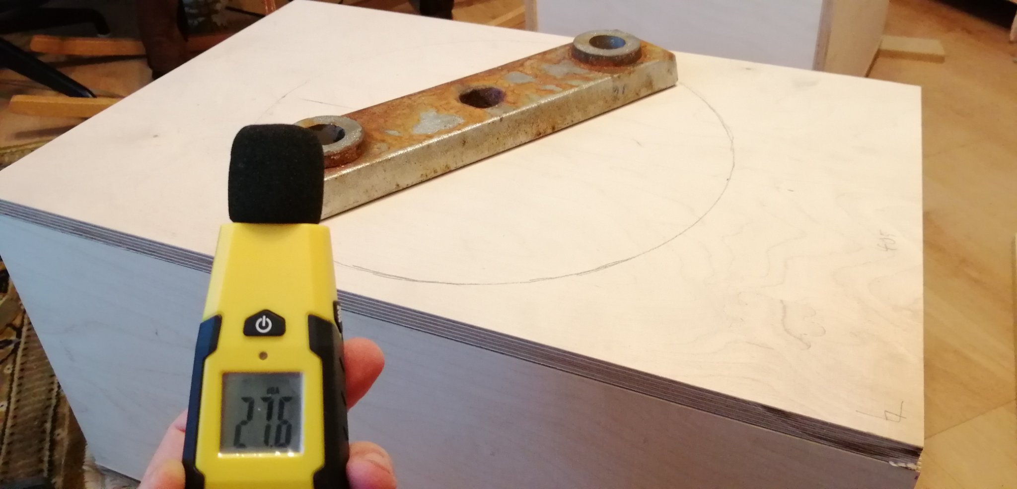

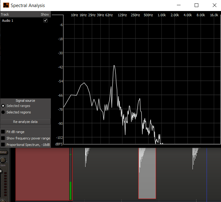

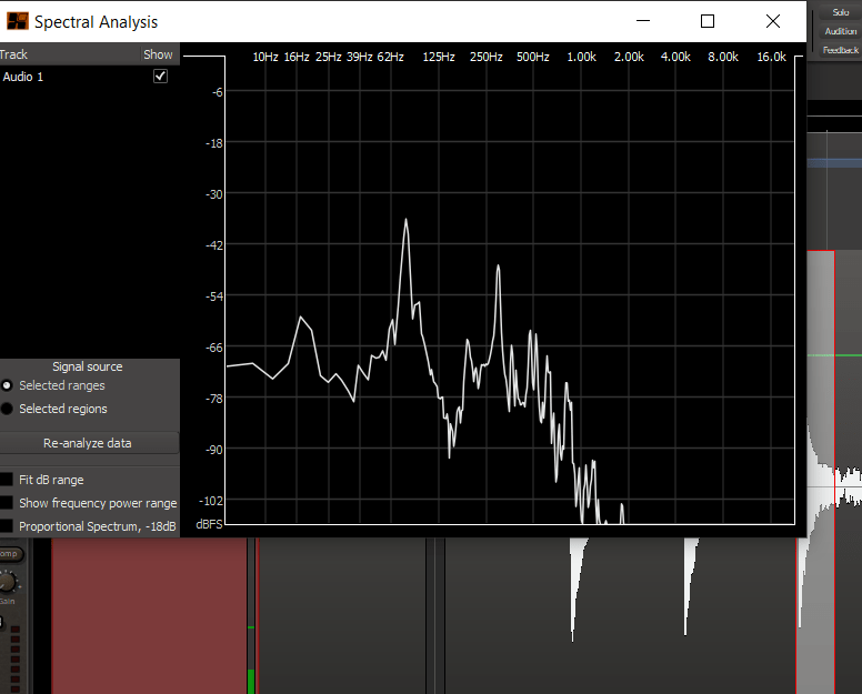

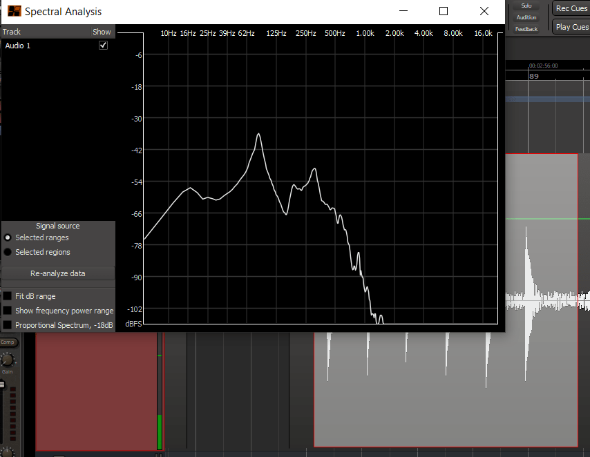

Here is example of knuckle test of another box. The driver itself works as "mic", sensin vibrations from the box while I'm knuckle tapping back panel of the box. This is ~50l closed box with some bracing in but no damping:

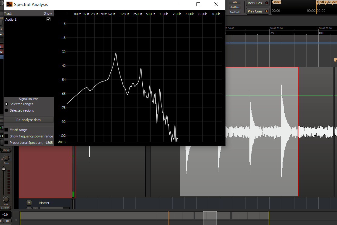

And then the same test, but now there is extra plywood glued with viscoelastic adhesive inside the box making some CLD to the walls, also some 5cm thick insulation as damping on all walls basically:
Its not very scientific test, not very controlled or calibrated, but an indication that things got better and not worse 😀

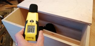

Here is another set of very unscientific test of the box without much bracing yet, empty box with BT speaker playing noise inside of the box and lid on top before hole was cut for driver. With the empty box, sound transmitted quite clearly through, almost like no box at all, well, the lid is not sealed so... Anyway, to give some indication about relative levels, how much damping material affects what comes out from a box.
Subjectively, a box can "ruin" midrange performance being nasty unintended sound source in a system radiating sound to various directions with various frequency response, possibly with high Q peaks and so on. Grabs attention from music to an issue, not fun at all 🙂 Subjectively there is quite big difference in "box sound" with more or less effort to dampen it. It's quite obvious that (at least large) box has a sound which can be an issue, but also can be manipulated to be less obvious.

ps. here spectral analysis spanning multiple knocks giving some kind of average I think. It shows that effect of my CLD and damping effort was mostly on higher frequencies around 1kHz and up. Very little effect on ~200-300Hz resonance/noise if comparing to system main resonanse around 80Hz. I'm not sure if I should compare to the main resonance or to absolute level, perhaps to absolute level.
Its always the lowest resonance which is least affected with any treatment and needs special care. It's also most within pass band, at least closest to pass band, and its the most problematic one. These analysis indicate I should do something about it, test more, add bracing or something, dampen the peak, it very likely still contributes to a box sound.

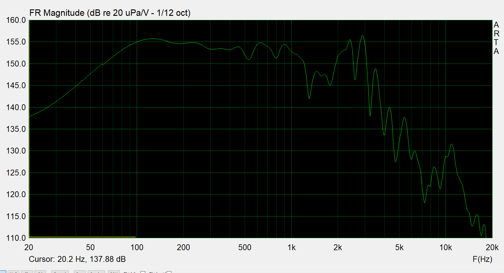

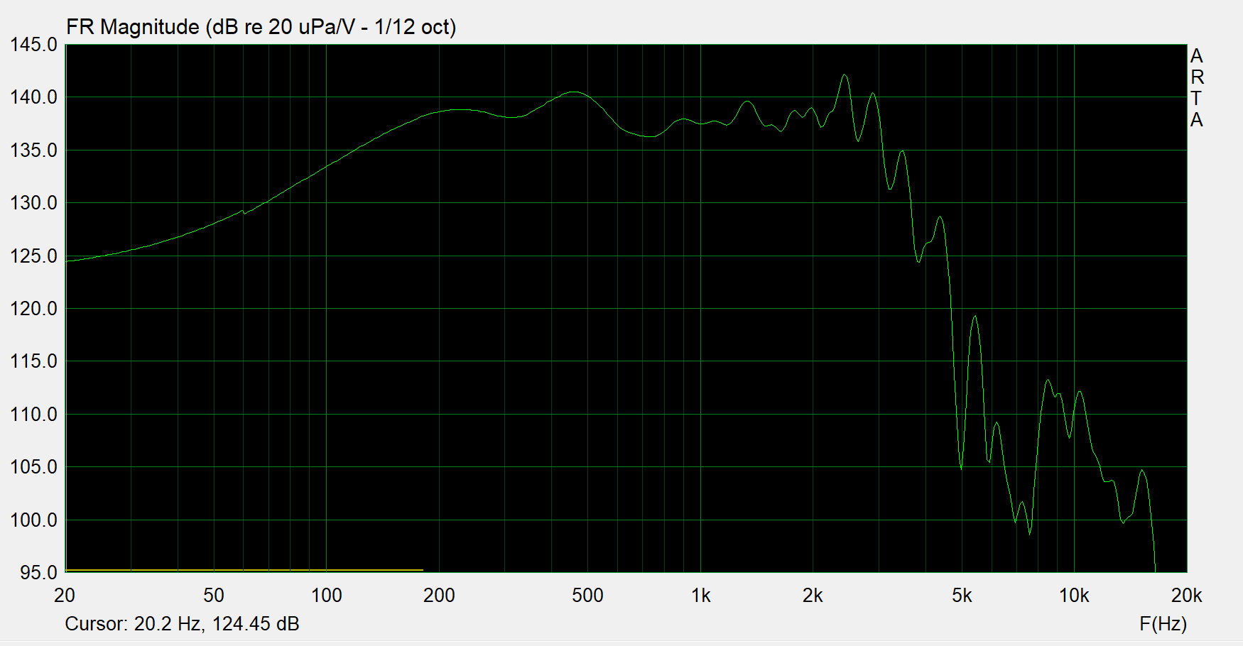

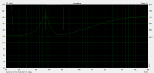

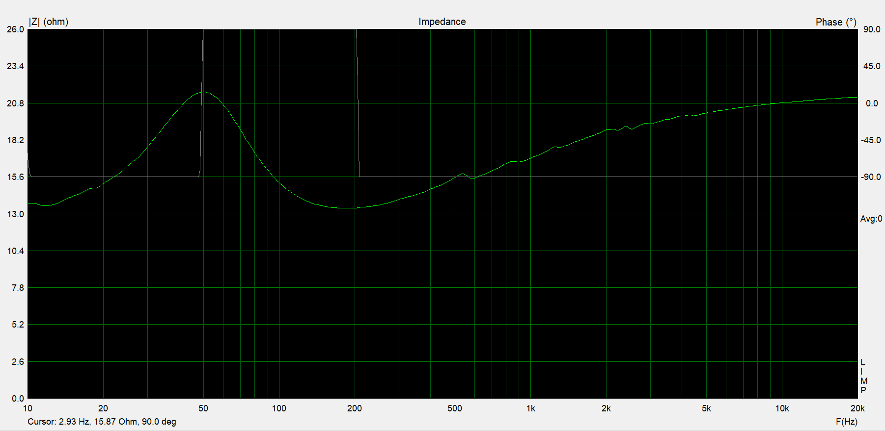

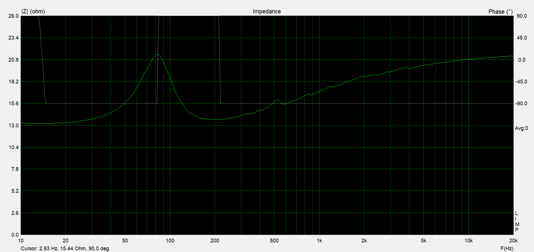

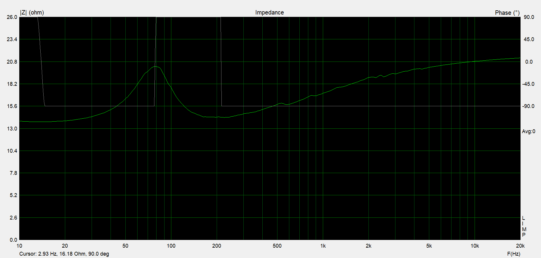

For completeness here some quick impedance plots, which seem to have some issues as its too high and phase is poop, but perhaps work for comparison between:
Nearfield and 1m measurement with 5.5ms gate to get any resolution, it could be that the ~300Hz dip is due to room reflection already, or from the box resonance. Anyway, resolution is poor with so short windowing. Levels not calibrated.
edit.

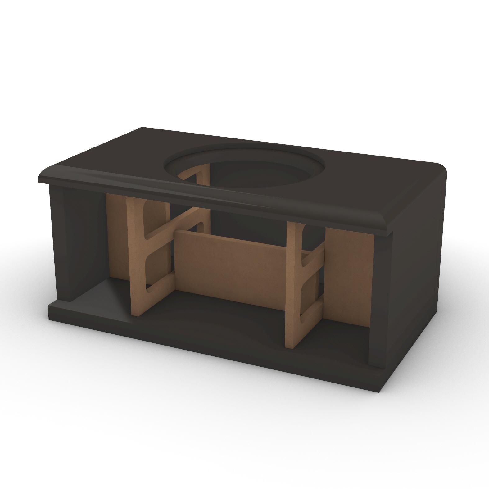

For damping higher frequencies you need to DAMPEN the walls. Elastic layer + stiff layer is a good way to do so. I also like to glue metal sheets (weight) with a thick layer of elastic floor glue in the box.
To shift the low frequency resonances you need STIFF walls! Bracing from one side to the other. And a lot of them so you only have small eares left which are able to resonante -> high frequencies.
One more argument against 2 way speakers - it's always beneficial to use different building technologies for midrange and low frequency driver.
Back to topic - sealed subwoofers are often small -> to make a stiff box is relatively easy. And it's easy to fill with damping material cause you don't have to take care about a port or line resonance - just dampen it.
Here my last design, I use 6 of these in my home cinema. Just fill the "chambers" with sheep wool, done. You could easily even add more stiffening without compromise in airflow - but that was already fine for my use 🤓
