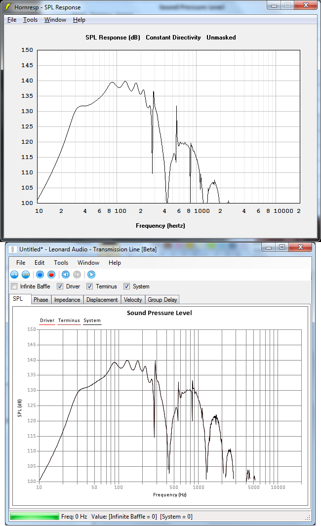

I finally got some time to compare tl.app to Hornresp for front loaded horn design. It's a fairly complex 4 segment horn with an offset driver, and obviously a sealed rear chamber but I didn't bother with a front chamber on this - that would just amount to a 5 segment horn anyway. I tried to make sure every single input was exactly the same in both programs, including making sure the rear chamber was the correct geometry and not masking rear chamber resonances in the hornresp sim.
This isn't a good horn design, so don't get hung up on that, the sole purpose of this excercise was to compare the output of both programs. They are pretty close, almost dead on in the 80 - 200 hz range, with tl.app response drooping a bit below 80 hz and a bit stronger above 200 hz as compared to hornresp.
I'm going to review my inputs again with a fine tooth comb to make sure the differences are not due to an error on my part, but even if not, I'd say these results are very acceptable. I can provide the hornresp export data and the tl.app project file upon request if anyone wants to check my work.
Hi just a guy,
Possible reasons for the differences:
1. The TL program appears to be using a simple "straight line" approximation for the horn mouth acoustical impedance at high frequencies.
2. Perhaps the TL program is making assumptions on directivity and is showing the on-axis pressure response, rather than the power response?
Kind regards,
David

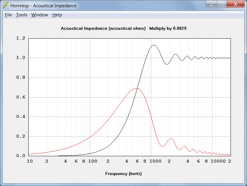

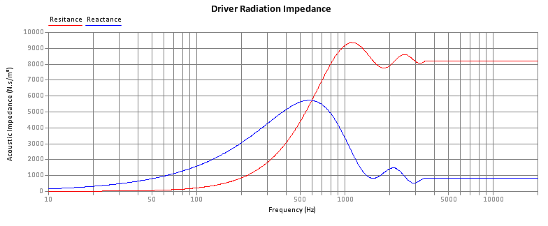

Is this something we can manually account for by adding or subtracting a small segment at the end of the line?
Hi just a guy,
The simplifying approximation made in the TL program when calculating horn mouth acoustical impedance at high frequencies cannot be manually accounted for. I haven't checked to see how much of an affect it has on the accuracy of the overall results, though - perhaps the difference is not worth worrying about anyway 🙂.
Kind regards,
David
