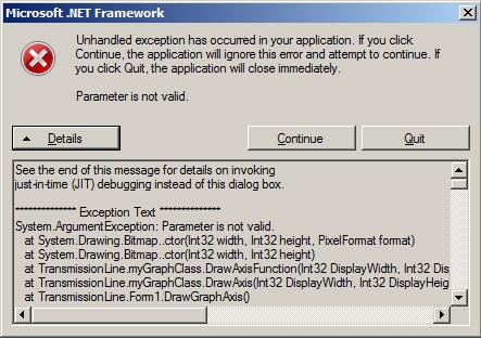

I get an error to when minimising and maximising, but can continue without problems. Running win7 64bit.

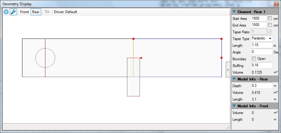

1. Ability to easily move the driver around.
This would require the ability to slide and resize adjoining branch lengths in the same way you can slide and resize elements OR the ability to create an offset driver with segments instead of branches.
In the pic below, the segment split line that defines the port location in this mltl is orange, so the port can be dragged anywhere between the driver location line and the far end of the mltl. I would like to be able to move the driver around in the same fashion without having to manually edit the lengths of both segment 1 and segment 2.
As far as I'm concerned this is incredibly important, otherwise it's still easier to use MJK's worksheets for mltl simulation, which is by far the most common alignment I simulate. I regularly go through 100 or more iterations of driver and port location to find the best spot, the reward for which is nearly ruler flat response with very little stuffing required.
