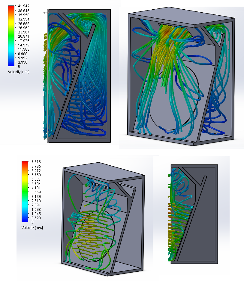

With flow you can check for "strange" airflows in the system... I think it's a great tool for optimizing airflow in the box and get rid of all kind of vortices (noise?)...using "flow" instead of Acoustic Modeling? - not the same domain at all

that's really something to see the Karlson type modeled - thank you very much - how would you interpret what its doing? fwiw I've seen them make a vortex in the front chamber when smoked is introduced - there's low pressure at the bottom of the front coupler and high at the top - I assume the wings are included in this sim (?) can it tell something about the cone damping when pulsed like on a drum beat?
Physical air flow (as in an air-conditioning duct) is not the same as sound vibrations propagating along an acoustic transmission line - where the net air flow is zero. To produce an air flow, you would need to replace the loudspeaker driver with a fan 🙂.
Perhaps he should lookup Bruce Thigpen 😉Physical air flow (as in an air-conditioning duct) is not the same as sound vibrations propagating along an acoustic transmission line - where the net air flow is zero. To produce an air flow, you would need to replace the loudspeaker driver with a fan 🙂.
But when you look at a speaker, the cone moves and pushes air. And when a sine wave is played you have a constant movement of the cone, right?
So my theory was that if you look at a one-way movement of the cone (so a few milliseconds of movement) you have a constant stream of air.
And this simulation shows how this air 'flows' in the inside of the box

But David, you think it can't be used for showing this?With flow you can check for "strange" airflows in the system... I think it's a great tool for optimizing airflow in the box and get rid of all kind of vortices (noise?)...
Yes, the wings are included like on the other image from that post. But they are hidden for a better view. I can't answer your other question..that's really something to see the Karlson type modeled - thank you very much - how would you interpret what its doing? fwiw I've seen them make a vortex in the front chamber when smoked is introduced - there's low pressure at the bottom of the front coupler and high at the top - I assume the wings are included in this sim (?) can it tell something about the cone damping when pulsed like on a drum beat?

The pictures of the Karlson are quite interesting. Are you reversing the direction of the flow when looking at the front versus the back?
Would you be able to do another set of simulations for the Keystone TH by Art (weltersys)? I have a drawing here: http://www.diyaudio.com/forums/subwoofers/185588-keystone-sub-using-18-15-12-inch-speakers-10.html in Posts #94/97. The important element is the shape and location of the opening, the Keystone. The simulations in Hornresp and AkAbak have not quite looked the same as the measured results. Maybe looking at the flow will shed some light on this.

Acoustic wave propagation isn't flow
you don't have flow - you have fractional inch to maybe few inch air molecule motion that immediately reverses
this is very significant for the result - very limited "momentum" effects, vorticity is practically zero for acoustic wave propagation - flow effects like streamlines, don't have steady unidirectional forces persisting over long enough time to develop in acoustic waves

The first image is when the woofer moves inwards, the next one is when the woofer moves outwards. I'm busy tonight and the rest of the weekend, so i think i could get it done monday eveningHi Michelp89,

So where does the air which leaves the port come from? 😛you don't have flow - you have fractional inch to maybe few inch air molecule motion that immediately reverses
I know that the movement is not a lot. It moves just a few milliseconds. But the molecules moves by the cone has to go somewhere. So this small amount of air pushes towards the other molecules. Which goes on and on and on. At least, that was my theory, I could be wrong.
Oscillation is not continuous flow
Acoustic Impedance is not flow resistance in the time, velocity, frequency and dimension range we see in speakers, boxes
as an example in continuous flow from an orifice you would get entrained air moving over the exterior surface adding to the flow - this effect can become big in "Coanda Effect"
in loudspeaker Acoustics the amplitude of air motion is small, keeps reversing too quickly for such large flow structures to develop

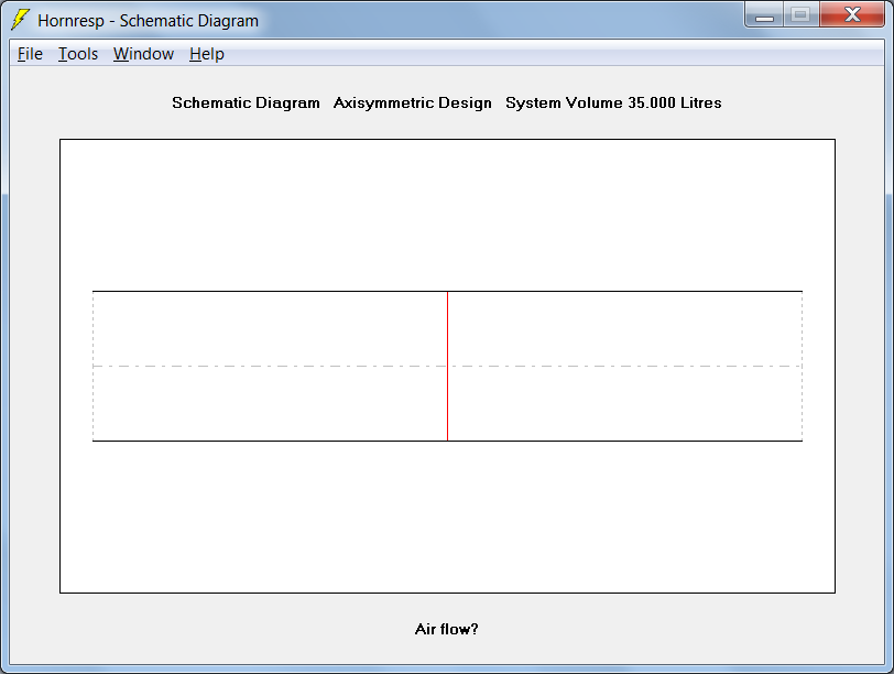

The tool can certainly be used to show air stream flows in enclosures - provided of course that the air is actually flowing 🙂. Unfortunately, the tool is not really applicable to loudspeakers, for the reasons given earlier.
The following example may help to clarify things:
Consider the simple acoustic system shown in the attachment. The red line is the driver diaphragm, located half-way along a circular cross-section duct. Assuming that air cannot pass through the diaphragm (which is usually the case), there is no way that a net air flow can be generated along the duct just by vibrating the diaphragm. That is why you need a fan instead 🙂
Kind regards,
David

Very interesting. I really like the approach to simulate the speaker behavior by using some FEM-simtools. But as already mentioned you need an "sonic" / oscilating airstream. Which is far more complicated then a steady "DC" flow. Of course the speaker will cause a flow but due to the compressible behavior of air (and the geometry of the enclosure) it will have a frequency dependent characteristic.
According to your pictures I guess it is a steady state simulation which means there is no time (respectively frequency) dependent characteristic distinguishable and it shows only the settled airstream for a certain inlet velocity. (For example: You could use this to analyse ..airstream noise of a bassreflex pipe due to turbulences - see B&W Speakers) but not for your purpose).
This is a multi-physics approach so you could use "Comsol Multiphysics" (commercial) - it has a very simple example sound radiation simulation for a oscillating diaphragm (but still not as easy as it may appears). Or Elmer (freeware) or ... OpenFoam (freeware) but for this I think it is maybe too difficult - but it would generate the best results. Then you have to couple several partial differential equations (in c++) of different fields...possible but tough.
(raising the difficulty level: you could also add the box resonances to the simulation 😀 )
