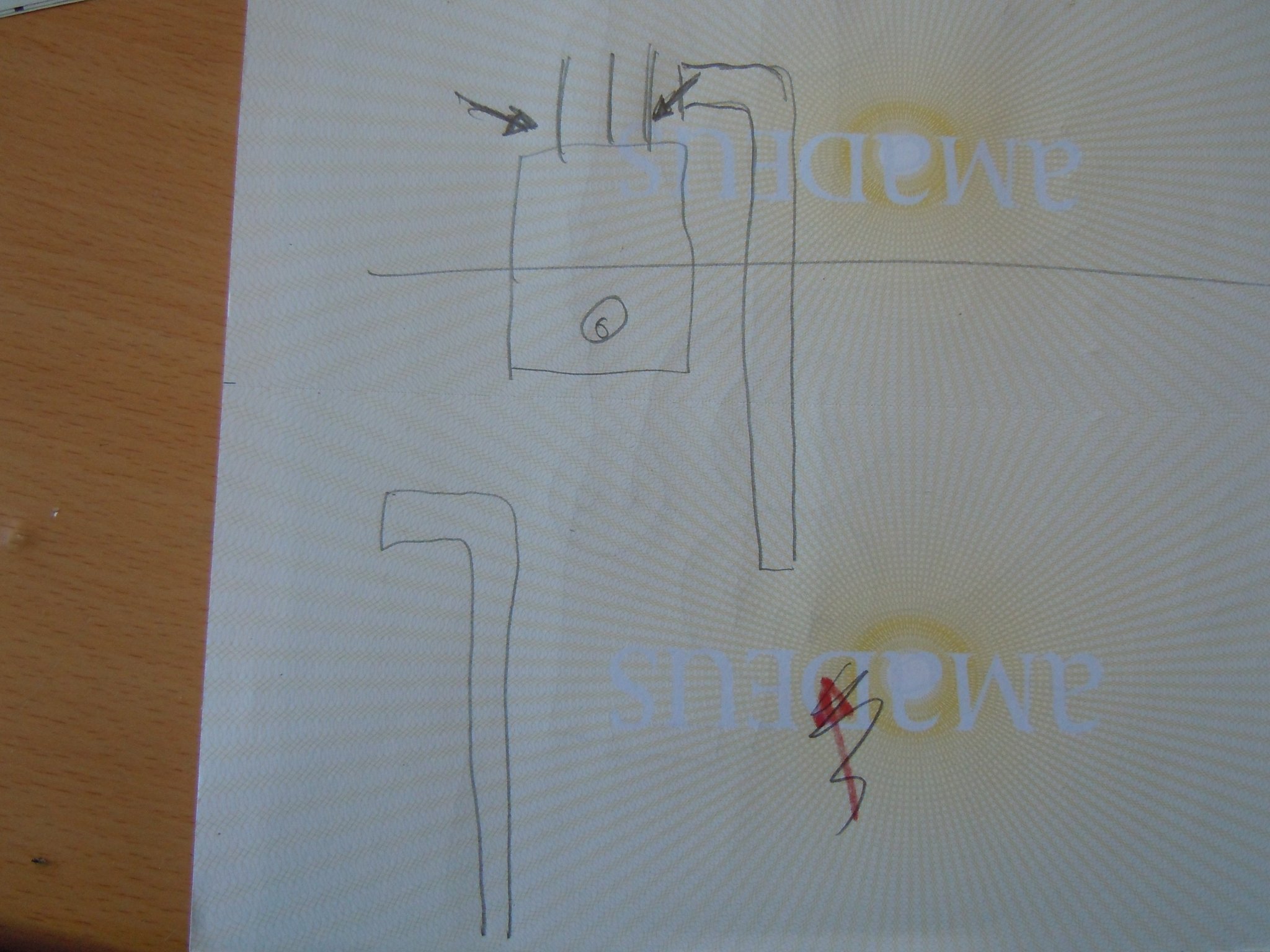

Transistors stuck to heatsink
I have soaked transistors with plain Iso Alcohol, it worked.
82 V DC at output means big trouble, see the transistors and drive circuit with a meter, check the supply and trace it to the transistors.
Unfortunately, some computer CPU thermal compounds are known to be adhesive, who puts silicon pads AND thermal compound?
That means somebody has attempted repairs, maybe.
That is another can of worms.
You may find references to stuck coolers in computer forums, the compounds applied with a syringe are famously sticky, and maybe you find how they were removed.
I would check if the transistors are blown, and as there seem to be SMD parts, it may not be worth the effort to fix it up, as it is it came free of cost.
Blown transistors means you cut off the leads, remove PCB, and use brute force if needed to remove the stuck parts.
And that will still need finding out what blew them in the first place.

When measuring, as best I can from leads above, there is no difference in the resistance.
And in order to remove P1, I need the circuit board off the heatsink.
Which, brings me right back to the transistors that are stuck…

What are the DC voltages at the output device gates?
How about DCV at the gate of Q2? The output devices may all be ok.
How about holding off on the demolition for now, and thinking instead.
Wonder if C3 or Z2 may be shorted.
What about switch TB101, it appears to turn off the input stage current sources.
Who knows what that is supposed to be for, maybe a thermal shutdown?

First, have you measured each of the four power supply DC voltages +73 +60 -73 -60
with respect to the negative speaker output terminal (ground)?
And with the AC power cord unplugged, measure the resistance of each thermistor TH1, TH2.

Voltages update…
Using speaker ground.
On the right channel, I am getting 123vdc from the 60v b+, and 137vdc from the 73vdc b+
On the left channel, I am getting -7vdc from the 60vdc b+, and 4.28vdc from the 73vdc b+
Checking voltage at gate of Q2.
I am seeing -38vdc on the right channel, and -7vdc on the left channel.
