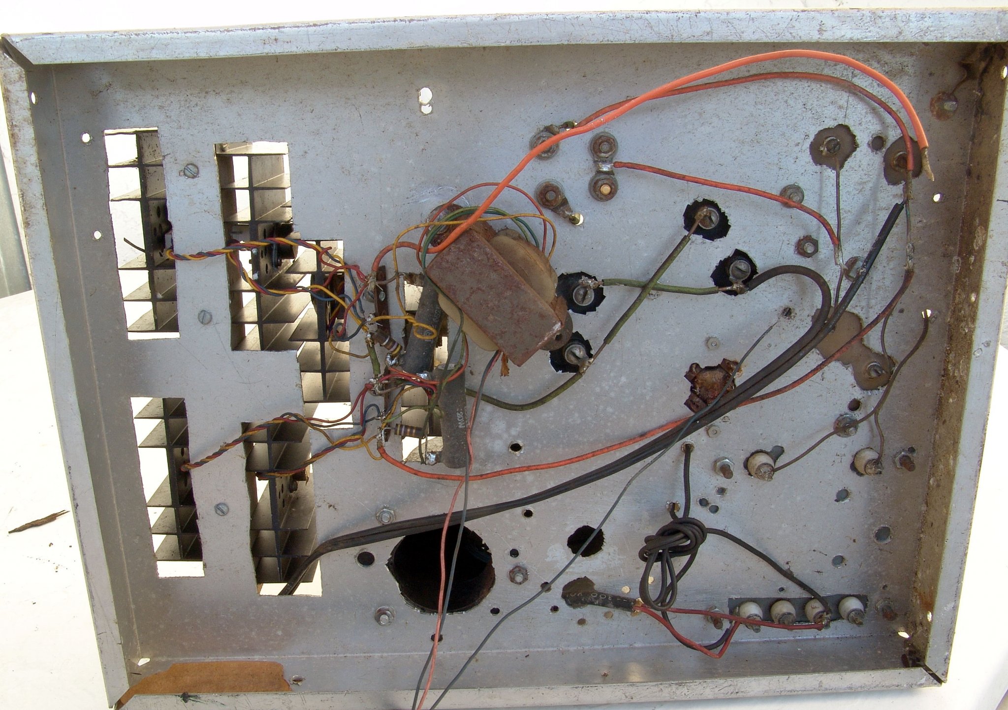

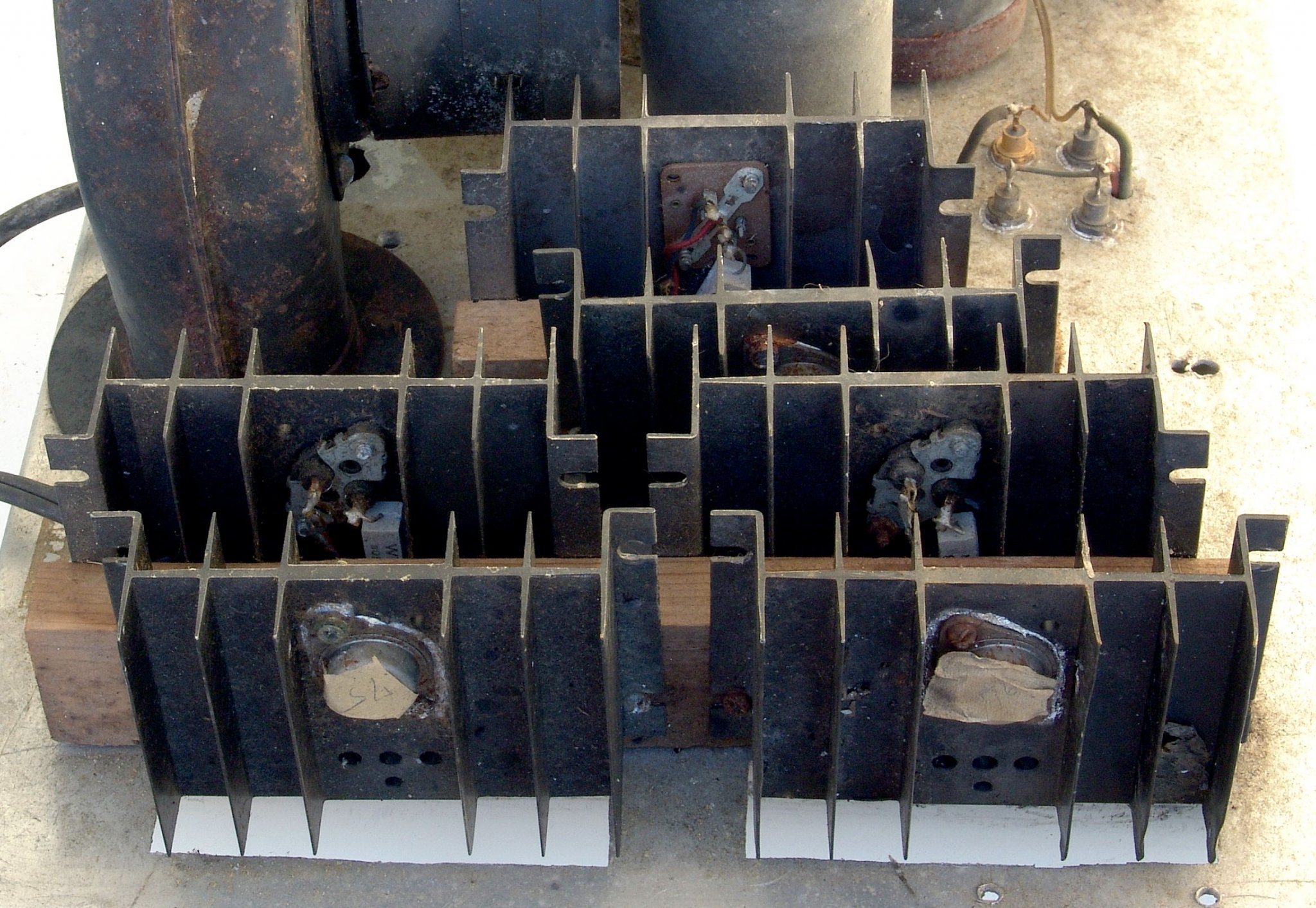

I was wandering through a local surplus shop in the late 60's when I spotted a tray full of RCA house numbered TO-3 transistors (39414 with a 1967 date code). I asked what they were, and the reply was "2N3055." Of course, every surplus TO-3 NPN was a 2N3055 back then. I bought a couple and subjected them to some testing, and cut one open, then went back and bought them all for about 60 cents each. I still have some in a box somewhere. While still in high school (1969), I built a monster "booster" amp with 6 of them cooled with a blower running on a B+ of about 100 volts. It used the transformer driven totem-pole circuit commonly seen with 2N2147's. The amp was used for guitar and PA duty and driven with a tube type guitar amp. The amp never died, but eventually wound up in a storage shed that got demolished by a hurricane in 2006. I let the waterlogged amp dry out and plugged it in. It blew the line fuse, so I jumped the fuse and tried again. This caused one of the electrolytics to spew, so I stripped out the heat sinks with transistors, and tossed the rest. The transistors are still good. Remember that this was built by a 16 year old kid with a hand drill and a nibbling tool.

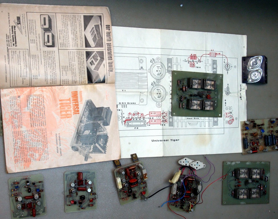

I had built one channel of the Lil Tiger in high school. It was the output section in the first complete transistor guitar amp I ever made. The wimpy Radio Shack power transformer and small 6 inch speaker allowed it to survive everything I threw at it. A few years later I started my career at Motorola, where they gave us free transistors for filling out a sample request form. Myself and our self proclaimed " Motorola audio club" made clones of every Tiger amp in existence except the Tigersaurus. We didn't build it because we couldn't find a suitable power transformer. We, the "Motorola Computer Club," also cloned the SWTPC 6800 computer, but that's a different story.Geez the 70's flew past and all I had to show for it was my "plastic" lil Tiger amp, one channel. Didnt understand a thing - yeah, you had to use C cup washers and thermal grease; I did it because they said so and it was underscored. Mention something like SOA and my eyes would glaze over. But I thought the bigger versions of the Tiger amps were cool; they had output level meters.

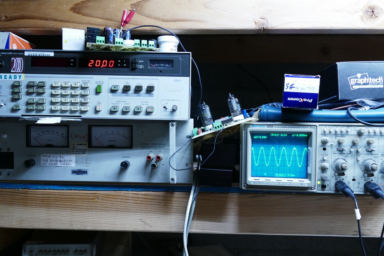

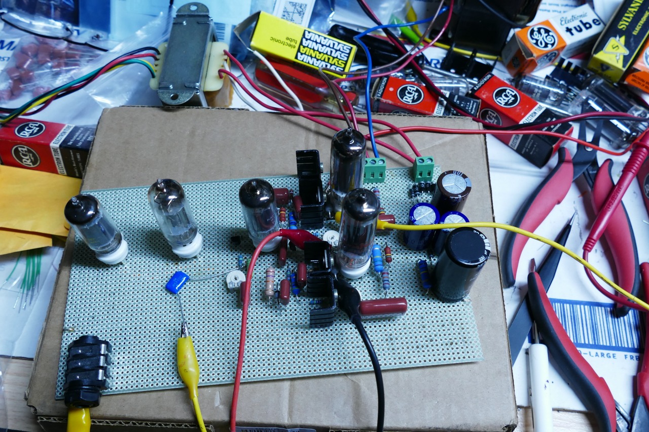

I never built anything with 6BM8's, but a pair of 50C5's in push pull can crank out 20 watts forever using UNSET technology in push pull. This is an unfinished little guitar amp breadboard. The Triad N-68X is the power transformer. The OPT is partly visible among the tube boxes (follow the blue wire). I let it run at 20 watts for an overnight meltdown test. The next morning the power reading on the 8903A read 20.03 instead of 20.00. THD at 20 watts (edge of clipping) is under 3%. It remains under 1% below 5 watts without any feedback.Pair of those in push pull still puts out more than a single ended 50C5. Ive had recievers with those that produced a satisfying sound, even if you can’t take over the world with it.
I still have some Jimpak 6800 and 6502!I had built one channel of the Lil Tiger in high school. It was the output section in the first complete transistor guitar amp I ever made. The wimpy Radio Shack power transformer and small 6 inch speaker allowed it to survive everything I threw at it. A few years later I started my career at Motorola, where they gave us free transistors for filling out a sample request form. Myself and our self proclaimed " Motorola audio club" made clones of every Tiger amp in existence except the Tigersaurus. We didn't build it because we couldn't find a suitable power transformer. We, the "Motorola Computer Club," also cloned the SWTPC 6800 computer, but that's a different story.
Those BM8’s are starved for heater power. Same heater power as the EL84, but it also has to supply the triode so you can’t get as much current out of the pentode. Relatively high quality, but single digit watts from a pair. Those 50C5’s run hotter ‘n hell - to get as much power density out of 110 volts DC as it can muster. And they don’t sound too bad doing it. Doesn’t surprise me you can coax twenty watts out of two of them.
