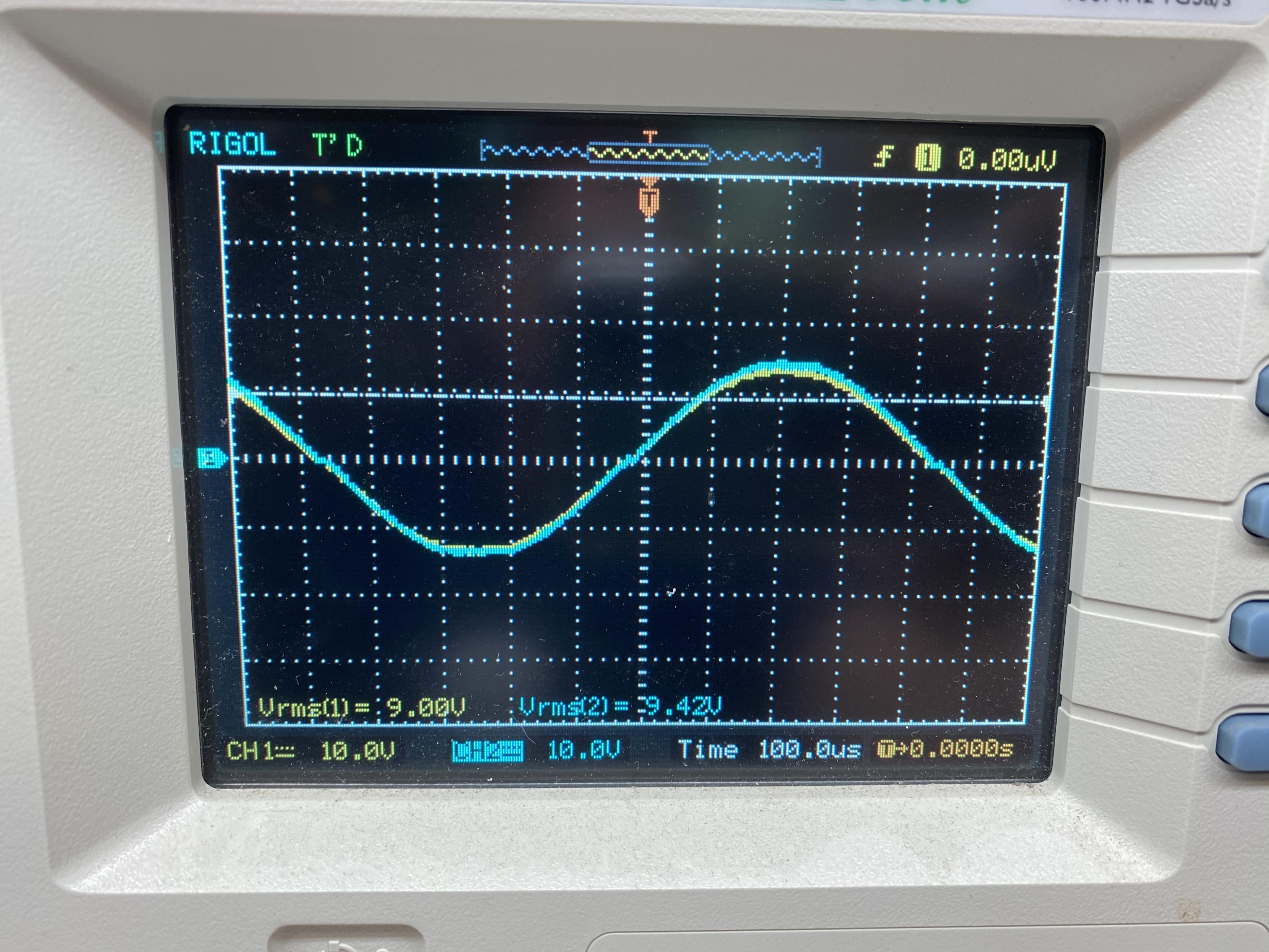

Not sure what I can tell you now, but the test of "conduction" of Q1207
could have been answered by checking the voltage on R1211 as said.
The difference between channels you noted here is no indication of fault.
The observation that there was clipping in neg voltage only led me to
contemplate about where it happens in the circuit, but it was a guess only.
If you can power up both channels without harm we may be able to find
the reason of malfunction with some more test results - voltage checks.

Very good, I really do appreciate the assistance you’ve provided, a literal life saver! I can power up both channels at the same time, the voltages I have checked are fairly similar in all the places I checked. Maybe I should turn up the volume until a good amount of that clipping on the bottom side of the waveform and then test voltages? The dummy loads are 1000w rated resistors on heatsinks so they could likely take the abuse.
If all else fails I was thinking of just swapping like five components at a time between each board and stop one the issue shows itself lol.
One thing I questions and maybe you can answer. How come it makes more clean power on lower voltage/current?

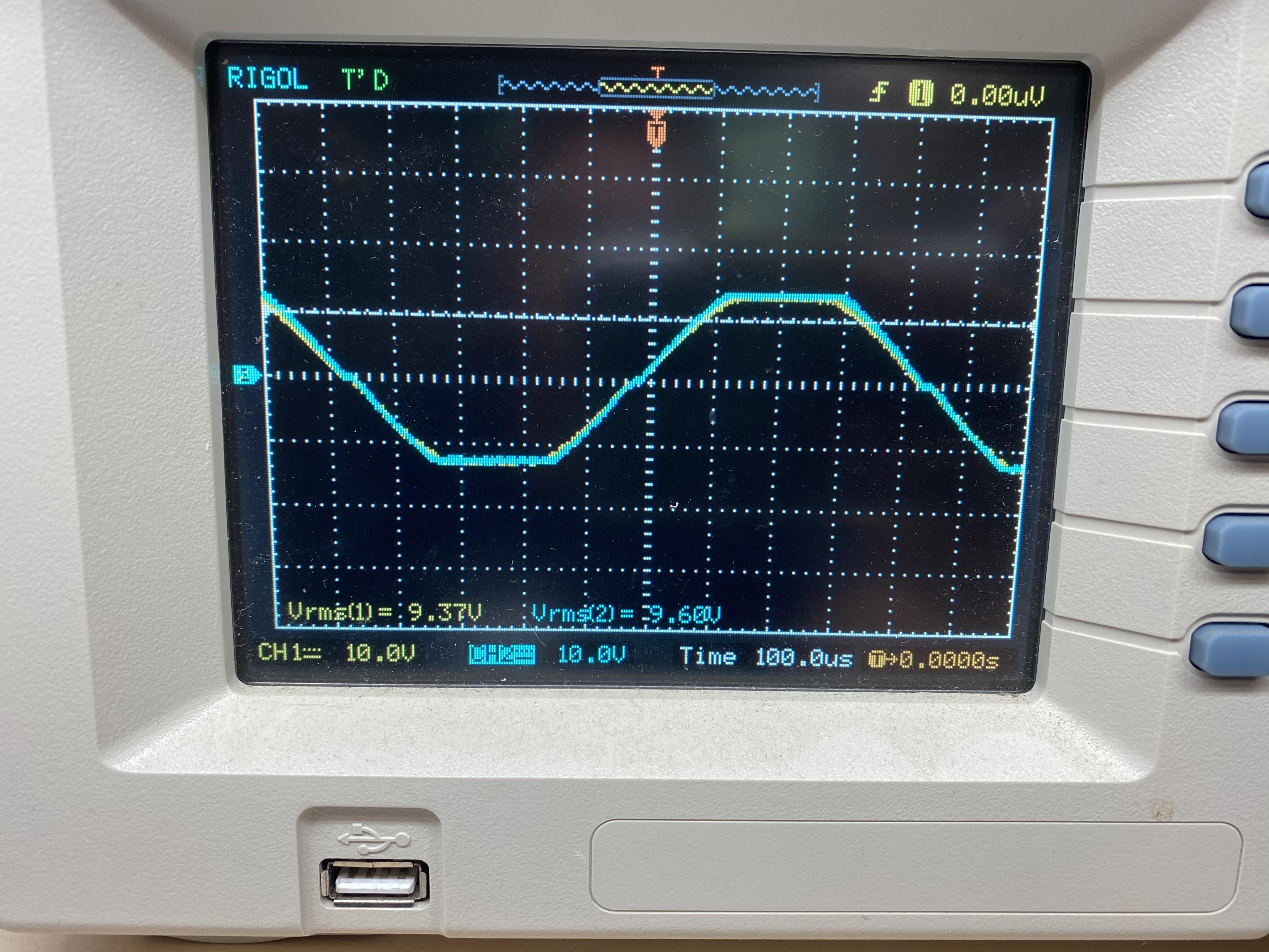

Plugged into the wall on line voltage the bad channel starts the clipping on the bottom of the waveform at 5v which is just over 3 watts.
Plugged into the variac and dim bulb tester it makes more. I have the variac set at 119v and once through the dim bulb tester the receiver is seeing 106V when it is powered up. On that lower voltage both channels clip equally on both the top and bottom of the wave. They both produce a clean 9.2V before any clipping, so 10-1/2 watts.
So just don’t know how that works, on more voltage and current you only get 3 watts, but on less wattage and current you get 10.5 watts.
I’m going to continue on, but if you have any place you think I should check first let me know.

We need more dc voltage checks, starting with the supply.
Yes, under load and at a level where clipping is clearly seen.
Is it true that the clipping occurred without load also ?
Check R1231 again and move the wiper in this case after the
initial position has been marked, watch the scope.
This applies only if your observation is true : fault is on driver
board. Check R1307, Q1303, Q1305, maybe CR1303 otherwise.

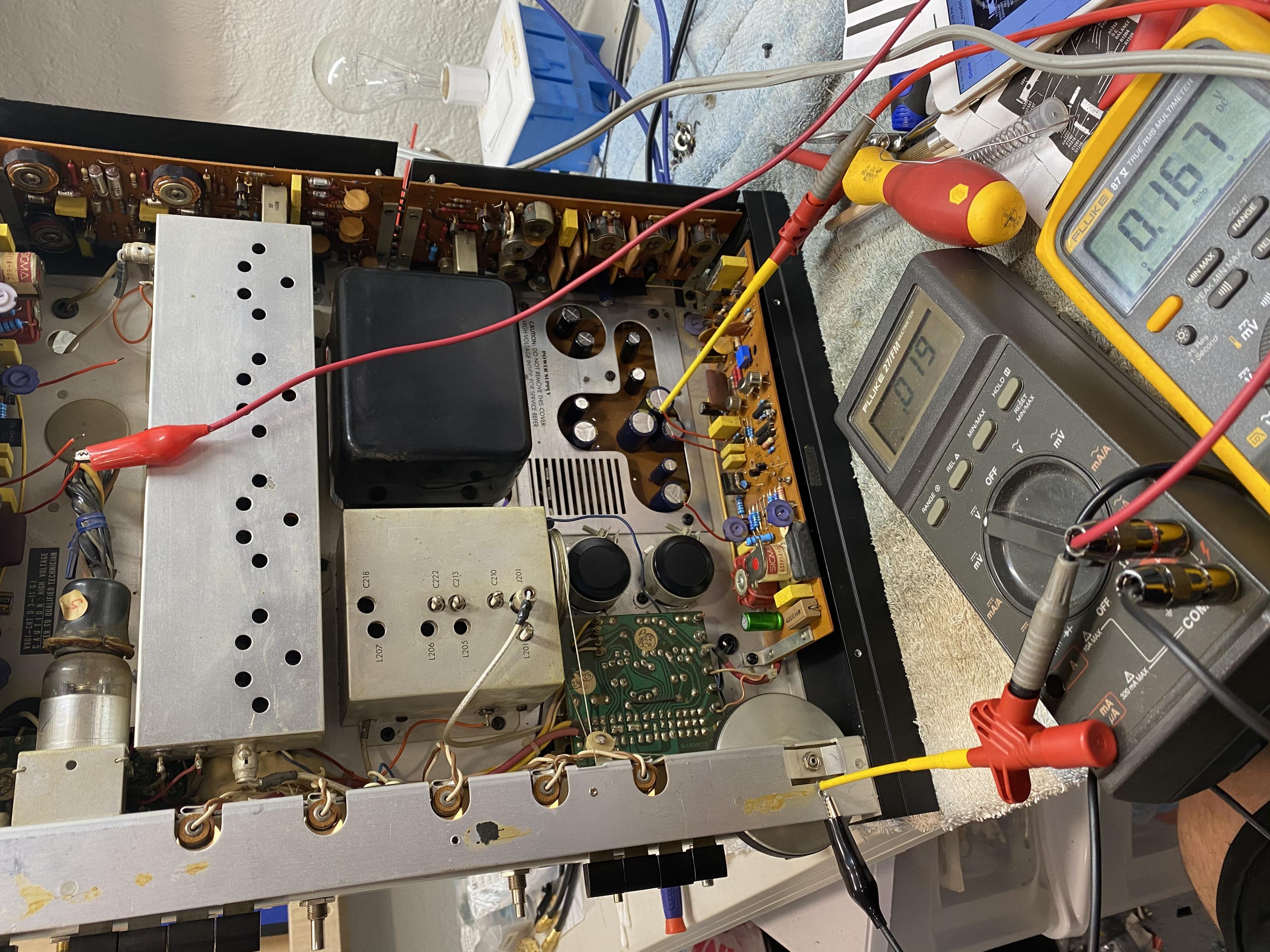

The supply voltage, measuring at the filter caps is a +35.74 Vdc and -35.81 Vdc. At the actual driver board
The good channel:
At 1209 I have 35.46 V
At 1215 I have -35.38 V
The bad channel:
At 1209 I have 35.48 V
At 1215 I have -35.44 V
At 1204, both channels are the same, start at +28 V and as I bring the volume up into heavy clipping it drops to +27, +26, +25 V and both channels drop equally.
As I bring the volume up both the positive and negative rails drop to 34 V then to 33 V, both channels drop equally. If there is somewhere else I should check supply voltages let me know.
Dan

If you are sure the driver board is faulty :
- R1231 sets negative current limit.
- Adjustment range is small, but the pot has to be ok.
- Does the clipping occur without load also ?
- if so check Q1207, Q1208, R1221, CR1203;
- expect about 1.8V on CR1203, 1.2V on R1221.
- Neg.output is driven by Q1204, it must be fine to do that.

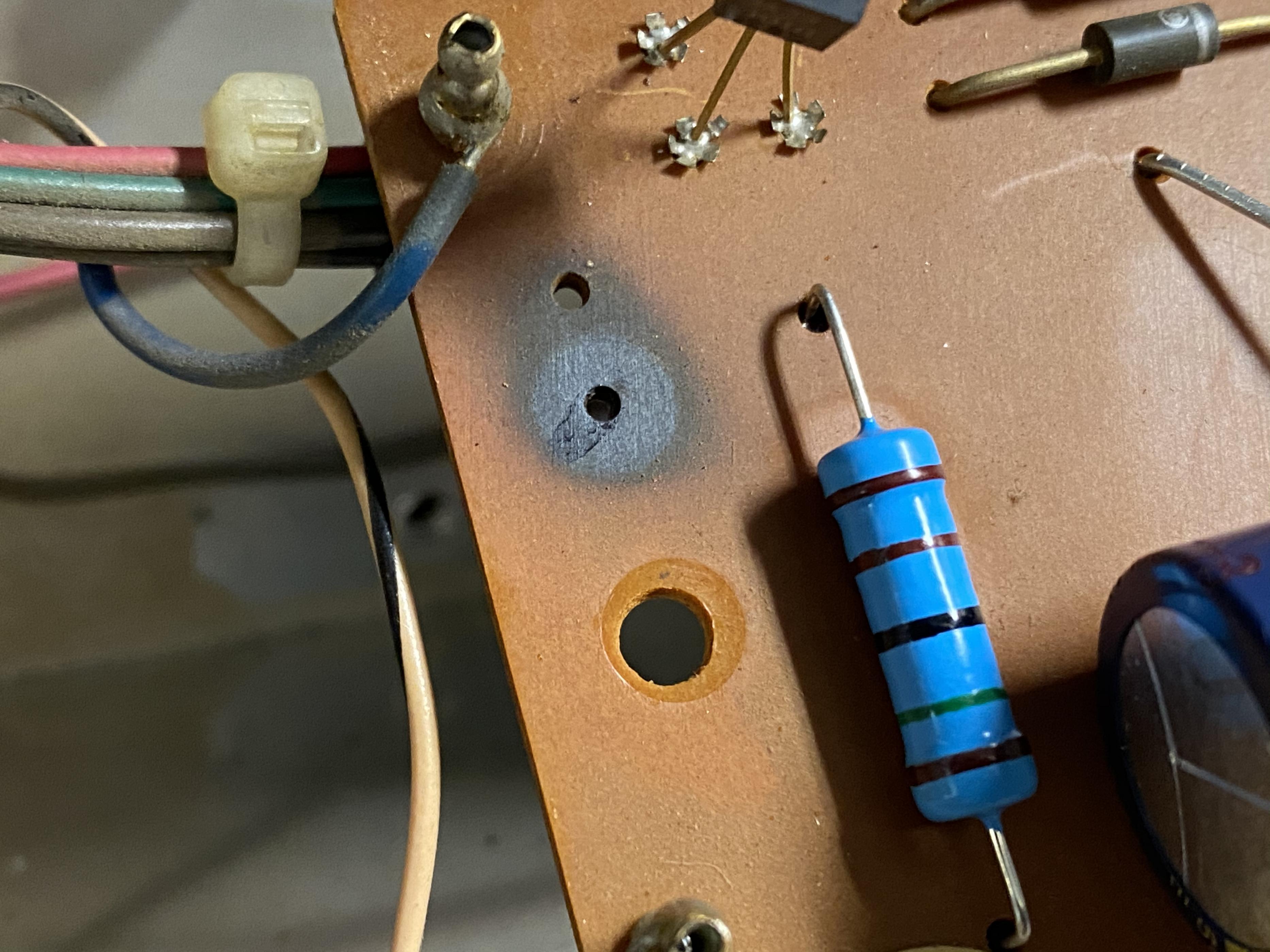

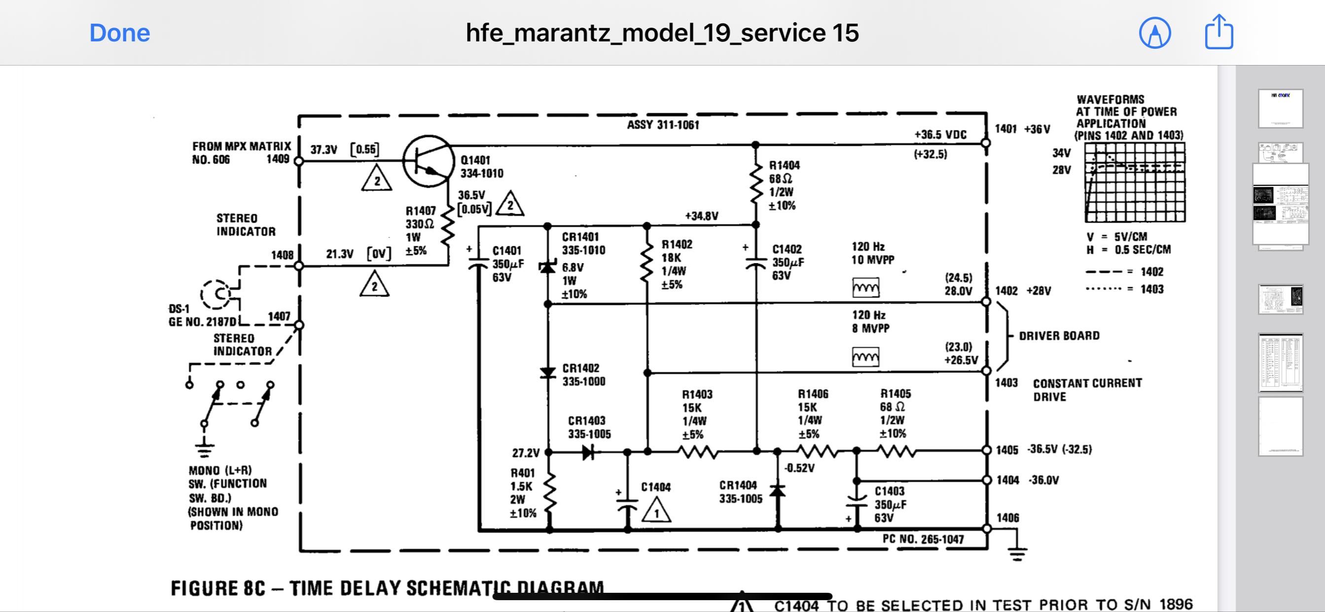

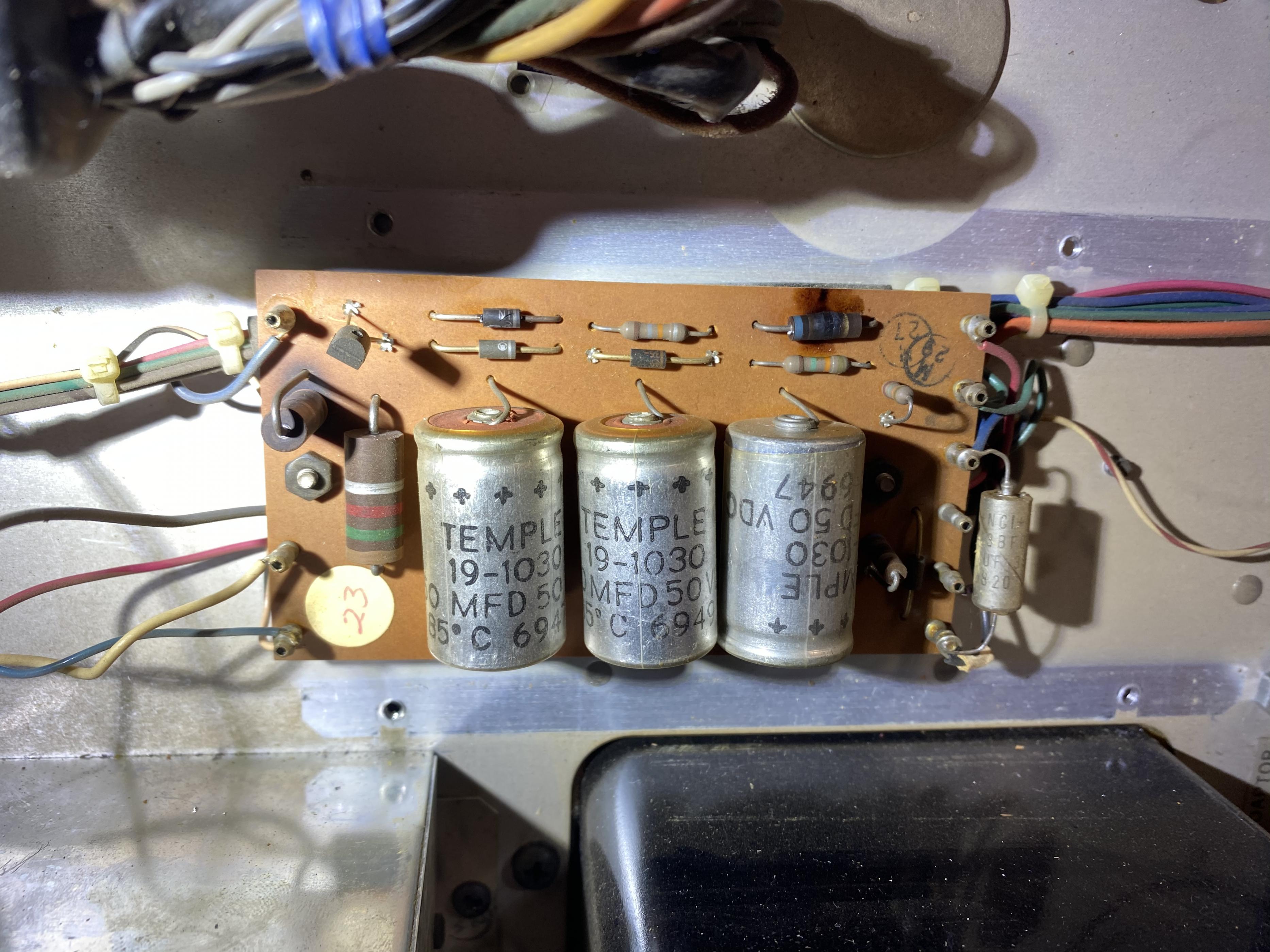

So are the driver boards in some way tied to the time delay board? This receiver is trying to defeat me I know it. I’ve never had trouble as I’ve had on this unit.
So I had output from both channels. I dismantled both channels so that I could bend the boards back in order to remove the small wire leads I had placed for monitoring the base and emitter voltages and then put the two channels back together. All I did was remove the leads. Powered it back up and again lost the output from both channels. Ugh!!! I check and see no shorts of any kind (wires to the chassis, long component leads, etc) and it doesn’t look like any wires have broken free from their soldered posts.
So I power it back up (this entire time powered on a variac and dim bulb tester) and confirm that I do not have audio output. So I put my scope leads to the inputs of the driver boards and see that I have perfect looking waveforms going to each driver board.
Then I see the dial lights go out and smoke billowing out of the chassis!!! What the heck!!! I see where the smoke is coming from and find a board hidden, the time delay board. The only thing burnt on the board is R1404, a 68 ohm 1/2 watt resistor.
So now I’ll pull the board, replace some components on it and go from there.
So my question, would the time delay board in any way effect the dial lights or audio output? Running a sinewave through a function generator through aux input. If not then i have to figure out why I’m losing audio from both channels by simply touching a soldering iron to three points to remove leads and bending boards out of the way. I can’t let this defeat me.
Dan

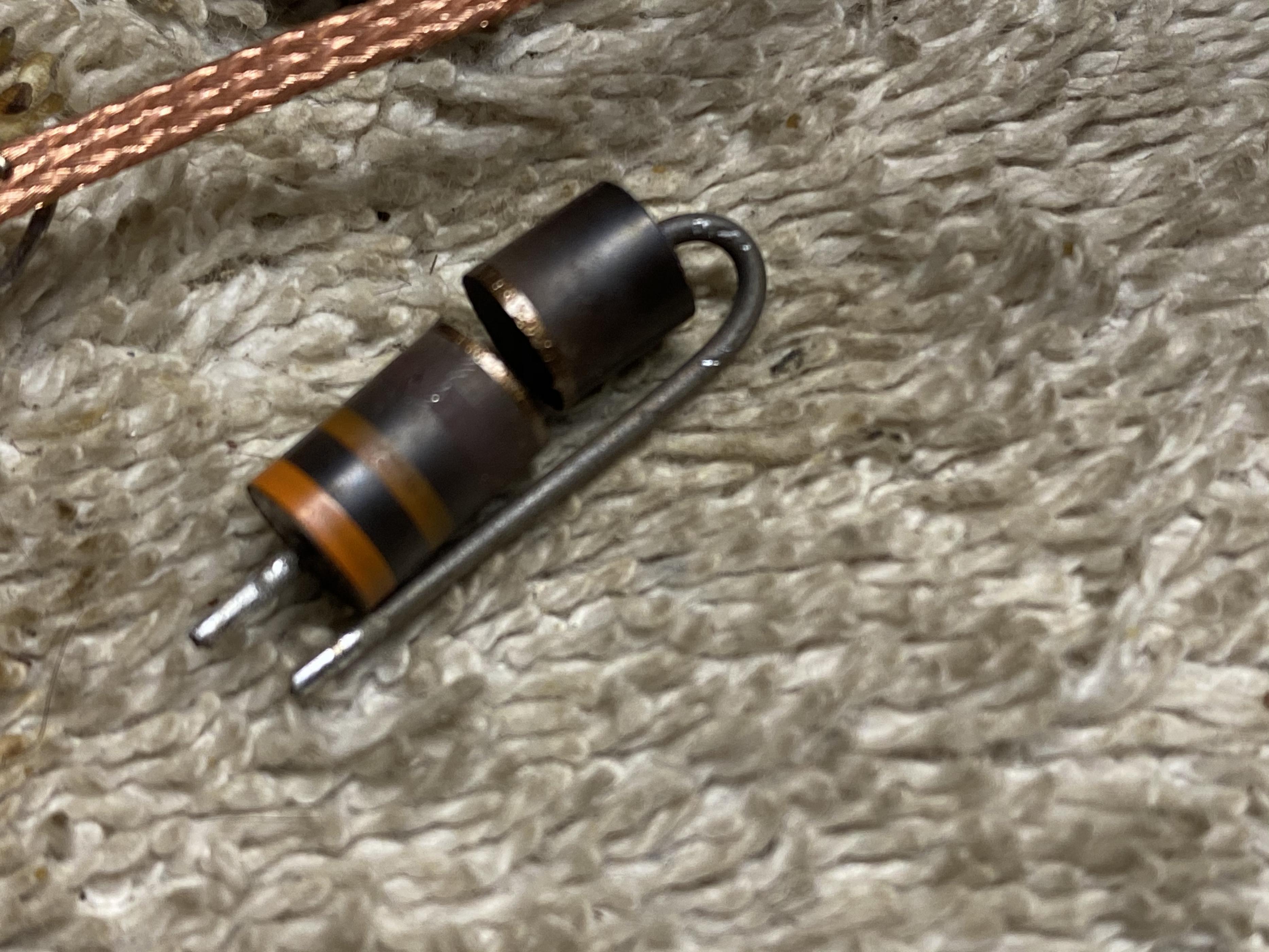

Actually R1407 from that board was crisped a bit as well and fell into two as soon as I touched it. Not sure of that was from when I had it powered up it started smoking or from the years of use, but the charting on the board leads me to think it’s from years of use.
Dan
Dan
I rebuild this audio delay board and I was being cautious obviously, but I powered it up on the dim bulb tester and had it on for maybe 3-4 seconds at most and then powered it down. I checked the temp if R1404 and it was blistering hot. I put a 1 watt resistor in place of the old 1/2 watt and I couldn’t get my finger off of it fast enough it was so hot. What could cause me to lose audio in both channels and cause that resistor to get so hot?

Of course, pinched wires from reassembling the side driver and amplifier boards...
R1404 is no longer getting hot as I don’t have a short to ground on the +28V rail any longer.
And I now have output on both channels now...
Dan
Dan

The clipping does occur with no load on the outputs, but does not occur when current limited on the variac/dim bulb tester.
I check the devices you suggested and it is without a doubt Q1208, thank you!!!
I swapped them between the channels and sure enough the issue swapped channels. I measured it like 5 times on my Peak Atlas DCA75 Pro transistor tester and it tested out perfect every time. So no I need to find a replacement for a MPSA56.
