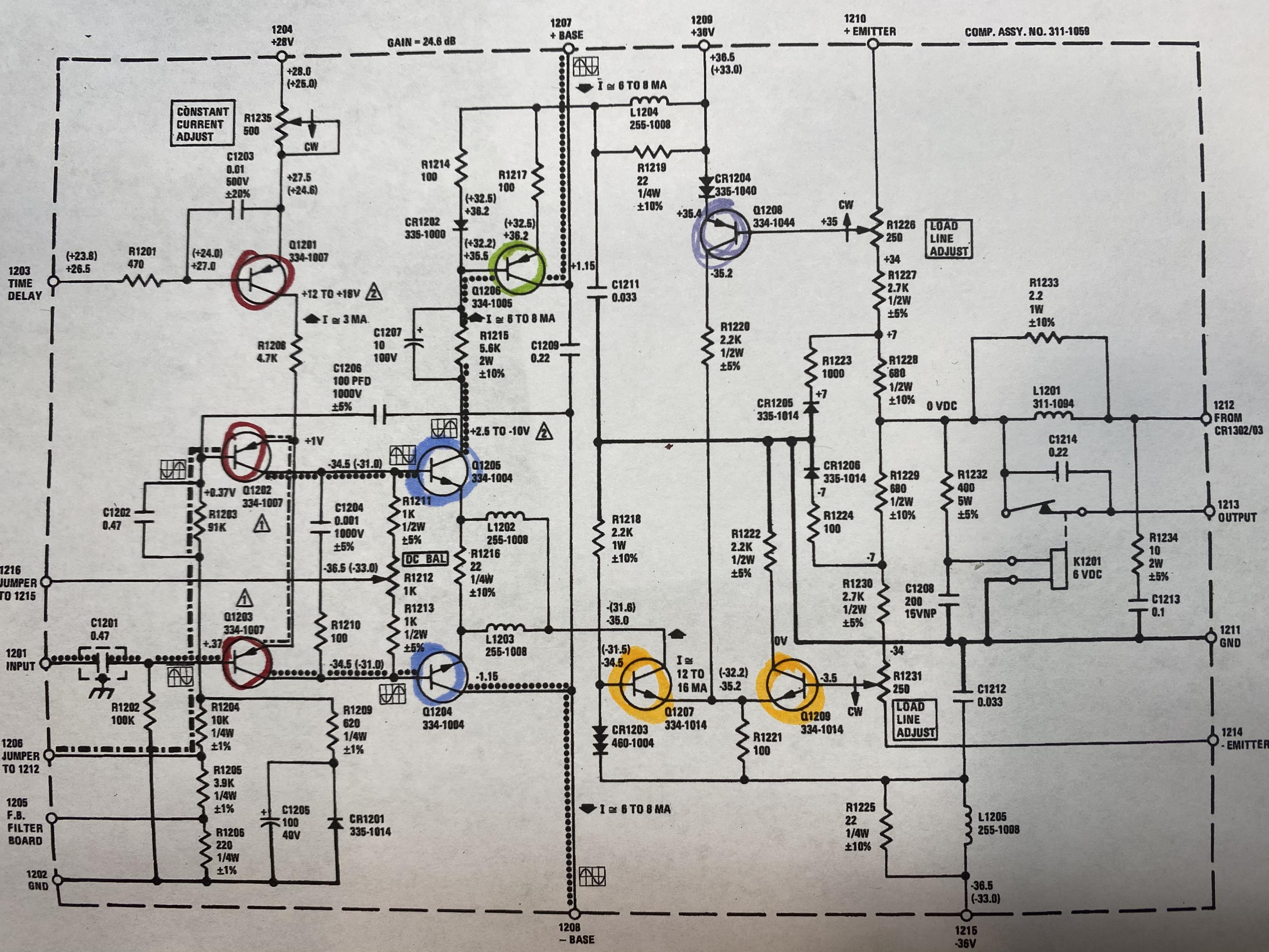

Here is a pic of the circuit and have colored the transistors
34-1004 Blue
34-1005 Green
34-1007 Red
34-1014 Orange
MPSA56 Purple

Instead of going after Transistors, check R1235 VR, R1221 VR R1226VR and as already as_audio have placed it, R1212

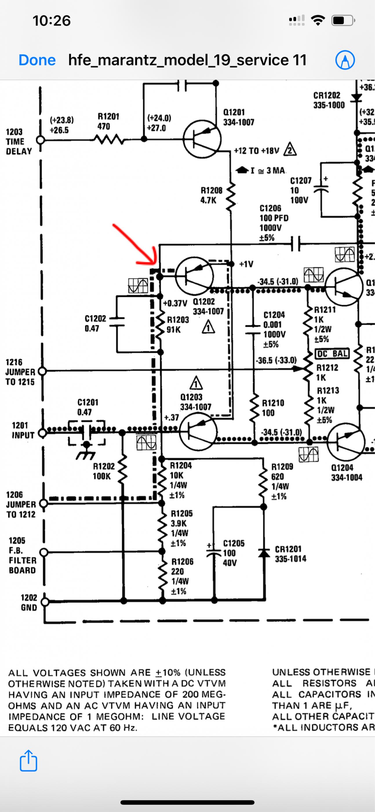

I’ve run into a new issue that was revealed. The bottom side of the waveform on channel B is severally distorted/clipped. I started by measuring the input of both channels and figured I’d work my way through the circuit. At the input of each channel the sine wave looks perfect.

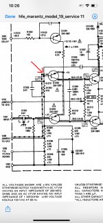

I moved to the base of Q1203 on each channel and both channels look perfect. I then moved to the other transistor in the differential pair and measured at the base of Q1202. This is where I saw first evidence of the issue. The signal on channel B at the base of Q1202 is severally clipped on the bottom half while being perfect on channel A. I’m trying to figure out what is causing it. I don’t know exactly how the circuit works and where that signal is coming from exactly. It looks like the clean input on the driver board doesn’t feed Q1202?
On the schematic attached I marked in red where I am first seeing the distortion.
Dan

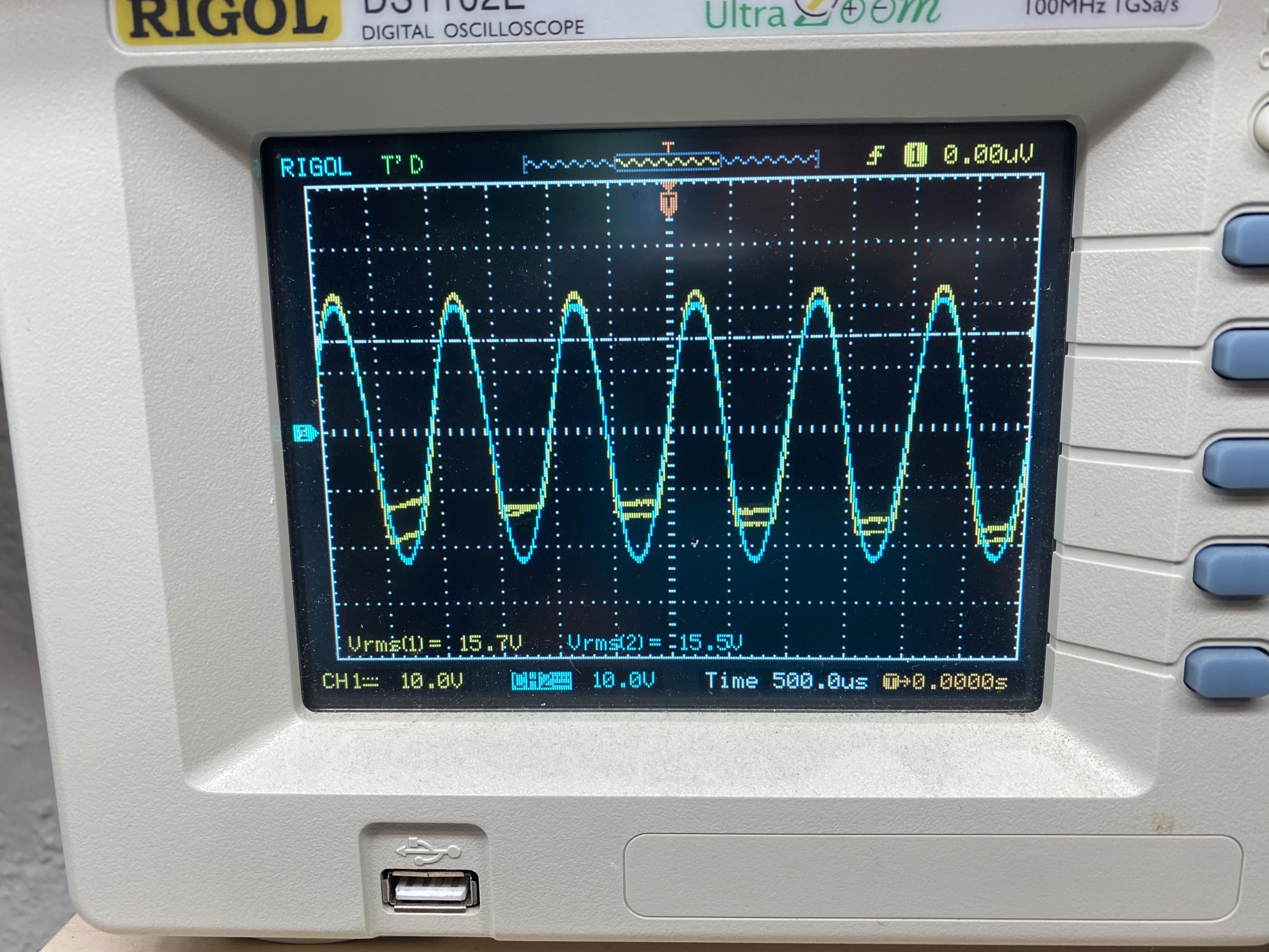

In order to see what is going on :
Display one full cycle only (set osc. to 1100 Hz).
Show the output waveform in comparison.
This is sort of clipping. Check the voltage where it sets in.
Or is it independent of level ? Give us a hint about the levels.

The form of clipping indicates neg supply is limited somewhere.

Hopefully I’m doing what is asked of me, I set my oscillator to 1100 Hz and then adjusted the display of my scope to show one full waveform only. One pic of just when the clipping starts and one where it’s a little more severe.
The voltage where it sets in? Do you mean the output voltage? The clipping starts right at about 5 V output, into an 8 ohm load about 3.125 watts. Below that it is clean, hopefully that’s what you were asking. I checked voltages throughout the driver board. At the perimeter of the board schematic it shows voltages at

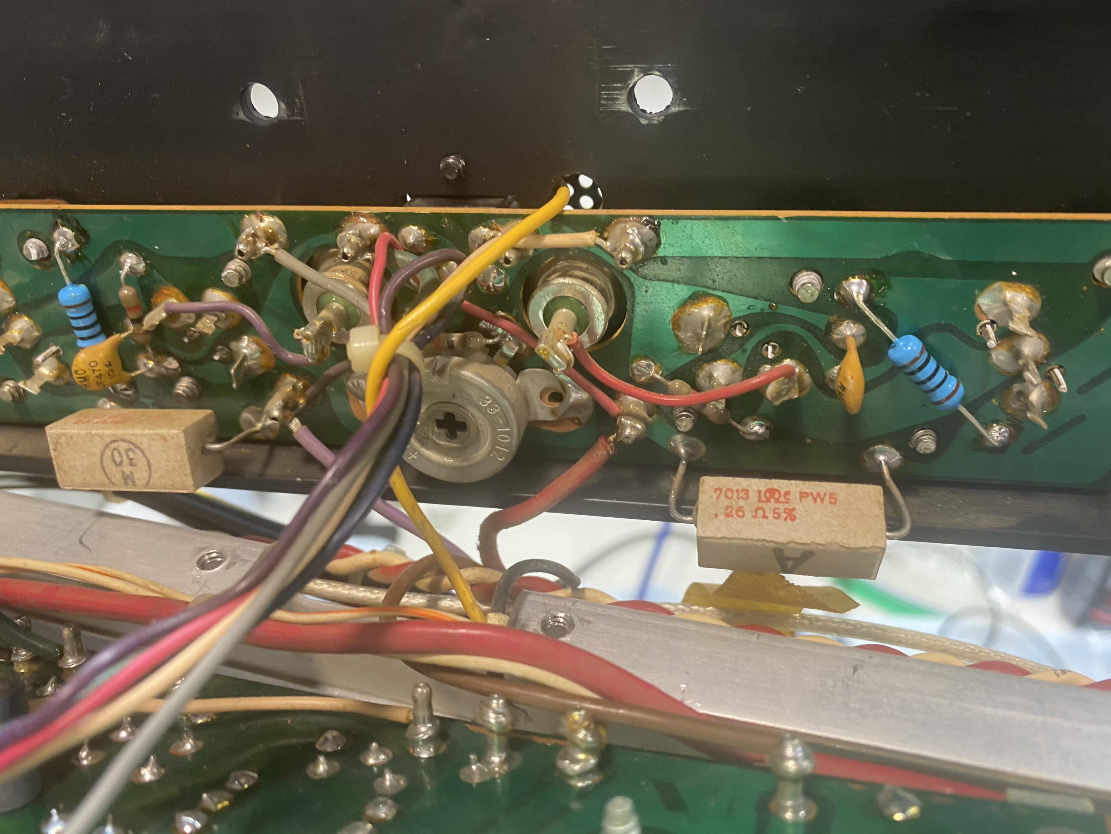

I’ve got it definitely pinned to the driver board. I desoldered all of the wires going to each driver board and swapped them, channel A going to B and channel B going to A. Prior to installing the boards I went through a flower all of the solder points just incase. Sure enough the clipping issue is now on channel A, so it swapped sides.

Checked Q1204 and L1203, both measured good, but swapped the components between the channels for good measure. Didn’t change, still have the clipping issue on channel A.
Is Q1207 conductive? I measured the resistance between the legs of Q1207 on each channel and here are my findings. There was a difference in the readings depending on which probe was where. So, if the positive probe was on the base and negative on the collector I would get a different reading than if the positive was on the collector and the negative on the base.
Good channel:
E to B - starts at about 2.2 Kohm and climbs no matter what prove orientation.
E to C - 353 Kohm with + E and - C
C to B - 360 Kohm with + B and - C
If I reverse the probes when measuring the E to C and C to B it starts out at around 35 mohm and counts down quickly to about 7 mohm to where it stalls a little, but still counts down slowly.
Bad channel:
E to B - starts at about 2.3 Kohm and climbs
E to C - 325 Kohm with + E and - C
C to B - 326 Kohm with + B and - C
If I reverse the probes when measuring the E to C and C to B I get nothing, my meter just says open lead. So that is a difference from the good channel.
I pulled Q1207 from each channel and measured them. Both measured as an NPN transistor with zero leakage, but the one in the bad channel measured with about half the hFE of the one in the good channel, 64 vs 119. I swapped them between the channels as well and the clipping is still on channel A.
I measured the voltage at R1221, I’m guessing you meant across the resistor as there was -36V when measuring to ground.
Across the resistor on the good channel I’m seeing 1.336V
Across the resistor on the bad channel I’m seeing 1.260V
