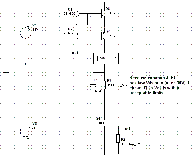

I`ve designed a modified current source which consists of a JFET current source, and the modified wilson current mirror(which is 100% undependent of the supply voltage).
At lower railvoltage, the JFET current source source could be a stand-alone.
But with railvoltages with over +-30V it`s impossible to use the
JFET source alone, most JFET`s avaliable have a Vds,max around 30V, the largest Vds I`ve seen is 60V...now that could become a problem.
Thats why I designed this circuit, you could easily use a 20V JFET, and high voltage beta-matched BJT`s, with no loss in preformance compared to the JFET current source alone. The wilson current mirror replicates Iref 100% (and Iref is 100% undependent of rail voltage), and operates at the Vce,max of the BJT`s).

Nope, this configuration is used in some op-amps (a simplified , and a bit different version in f.ex. 741, not with JFET). The JFET current source is something I have seen before (I actually found it yeasterday in an old schoolbook lying around).
And I wonder why I haven`t thought of this before, the JFET gives a 100% stable Iref at all times and is totally independent of variations in the supply voltage, and the wilson mirror gives a 100% excact copy of Iref.
There is nothing wrong about this schematic, I`ve done a lot of simulations with this circuit in the last hours, and it`s working perfectly. The tail current in my input stage is rock stable, to say the least.
I`m going to do a lab with this one in a couple of days, I`ll let you know....I really don`t understand why you think this schematic is wrong, I`m 150% certain that you have misunderstood something, because I`m 150% certain that this works. Calculation, simulation and common sense tells me that!

Shouldn't R2 be in the source of Q1 instead of the gate? It looks like the IDSS of Q1 is about 80mA according to the Philips data sheet of the J108. Since your current meter shows around 5mA, I'm assuming you may have transcribed the schematic, inadvertently moving R2?
Also, since Q4 and Q6 are not part of a matched pair, I think it would be a good idea to have small emitter resistors to help equalize the currents. I've played around with current mirrors in simulation by having transistor models that are identical except for tweaking Is for a 10-20% variation between devices (making the current ratio approximately the same as the ratio of Is values in the absence of emitter degeneration). I don't think individual discrete devices track well enough to be able to get away without them. Just a thought, not meaning to nitpick here.
Another thought - have you seen the Hawksford cascode circuit? He wrote a neat article where he shows 20 dB improvement in Vas distortion from a fairly simple mod. I saw a very similar improvement in simulation. It's an interesting article to read, even if you don't use the circuit. I'd be glad to email it to you if you send me an email (since the forum email doesn't seem to work with attachments).

YES, of course, I did that in my 50W amp schematic (http://www.diyaudio.com/forums/showthread.php?s=&threadid=23673), don`t know why I put the resistor there???Shouldn't R2 be in the source of Q1 instead of the gate?
(Sorry abot that John Curl!!!!!!!)
The reason there is 5 mA, I because I pasted the wilson from the amp schematic.....
I don`t think you just can use at the datasheet when determing Iref, I`ts better to replace R2 with a potmeter and measure the voltage over R3 or just put in some values the way I did..
And yes, I`m very interested in that schematic!!!!!

I think your current source is not as rock solid as you think. In your simulation with ideal battery power supplies the output current will be stable. In the real world any power supply ripple will modulate the current ouput of the JFET, since Vds will be modulated. The (almost) ideal Wilson current mirror will just copy the input modulated current into an output modulated current.
I also wonder what the purpose is of using a negative current source (i.e. with reference to the negative supply voltage) and then mirror it to get a positive current source. In this way you will have trouble to get rid of supply ripple. Why not just start with a positive current source? That could even be the same JFET. The JFET doesn't mind about polarity (being a floating current source) and will also act as a current source delivering current from its source.
Furthermore C1 in your diagram (in parallel to R3) makes no sense. It will only destroy the JFET during charging, since the JFET will get the full supply (minus 2Vbe from Q4/5).
Steven
