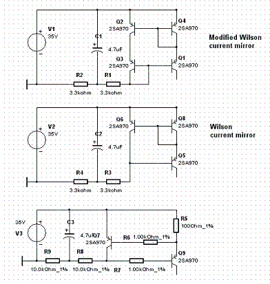

Sorry about the confusion, it`s wilson current MIRROR, and wildar current SOURCE. My mistake, I`m mixing them too...
Ref.:
-Micrelectronic circuits 4th ed." by Sedra/Smith
-"Analoge kretser og komponenter" (analouge circuits and compnents) by Rolf Ingebrigtsen
When we desire a current source I<10uA, wildar is perfect, output impedance >10Mohms. (these values are very ca. and are solely dependent on beta and Va
A modified wilson has output impedance >1Mohm`s (assuming high-beta BJT`s). An ideal current source has infinite output impedance, this is specially important in the input stage (differental amp).
Higher output impedance in the current source means higher CMRR and PSRR, and greater linearity, combined with an active load (current mirror), the preformance is second to none -whatsoever!!!
Compared to the "shcoolbook" design of the diff. amp with resistors (and even the transistor-diode current source) the difference is 1/100-1/1000 and often more)!!
Regardless, there are people claiming otherwise, but that`s wrong, you can`t cheat on physics!!
Ref.:
CCS
Hi PanzerLord,
Thanks for the pic.
The seccond one is the one I'm using(without Q5) but didn't know the name of it.
I'll mod it and will report later.
Thanks again!
Audiofanatic 😉
Hi PanzerLord,
Thanks for the pic.
Thanks again!
Audiofanatic 😉
-Your case (without Q5) output resistance is ro=Va/Ic
-My case (with Q5) The output resistance for the wilson is Rout=beta*ro/2
=beta*(Va/Ic)2
Assume a Va=100V, and Ic=1mA and beta=200:
-Your case:
Rout=100V/1mA=100kohm.
-My case
Rout=200*(100V/1mA)/2=10Mohm.
I can assure you that preformance will be improved! (CMRR will in theory be doubled)
=beta*(Va/Ic)2
-Your case:
-My case
PanzerLord said:-Your case (without Q5) output resistance is ro=Va/Ic
=beta*(Va/Ic)2
-Your case:
-My case
THANK YOU!
Audiofanatic 😉
I have now replaced the modified wilson current mirror with a standard current mirror (two BJT`s ).
If I have replaced the active load (a standard wilson current mirror) on the input diff. amp. on both cases, the difference would have been far more noticable...
.The seccond one is the one I'm using(without Q5) but didn't know the name of it.
A standard current mirror Rout=ro=VA/Ic
Since some confusion seem to still be around, and I found out
what confused me, maybe it can help somebody else.
As is well known, a current mirror can be used as a current
source by tying a CCS to (or elsewise draw a constant current
from) one half of the mirror. The other half will then replicate
this current source, more or less perfectly depending on the
mirror topology etc. When Panzerlord referred to a Wilson
CCS he actually meant a Wilson current mirror used as a CCS
in the way described above. I just had never heard the term
Wilson CCS before, but the concept is well known, of course.
Then is the question what is won by this since the constant
current to be replicated seems not generated by a CCS in
his case but by an RC net, but his simulations seem to
indicate advantages.
Yes, good point.
You can also use the Wilson Current Mirror as a current multiplier by configuring non-symmetrical emitter degeneration. I have seen this done with triodes to effect impedance transformation without a transformer. VERY cool!!
However, I've done a lot of work on current mirrors, which are yet another elegant engineering solution to a problem which scarcely exists. The problem is that they are an active load, and this introduces more non-ohmic behavior into the mix at the point where the diff pair drives the voltage amplifier. I have shown mathematically, some year or two ago now on this forum, that even with a perfect current mirror, the single ended take off drives the diff pair into asymmetry; precisely what we don't want. I have found that PP SS amplifiers sound better without them.
Hugh
Hugh
