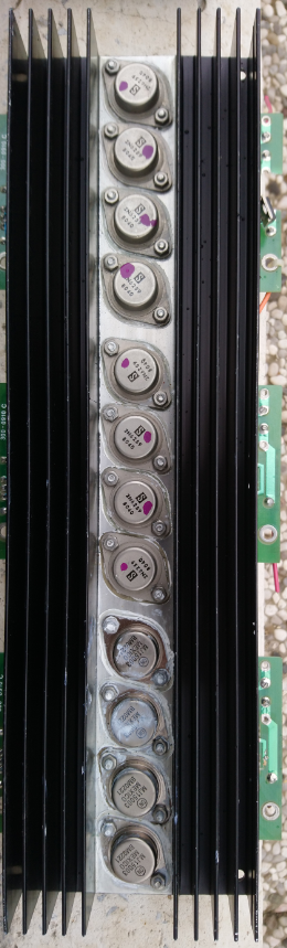

This is what real 2N6259’s look like. ALL of them were pulls, from equipment which calls for them. The last two are house numbers - likely selected for higher Vceo.

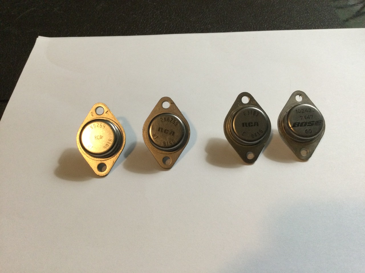

I have some old RCA transistors that look exactly like this - these 2N6472 and 2N6247. I have used 2N3773 in an early amplifier build this was a Motorola equivalent. The compensation scheme involved a 220pF capacitor from the Vas back to the inverting input terminal. The collector load was a bootstrap capacitor. The supply rails were +/- 50 Volts. The closed loop gain (over unity) was 22 times.

I posted that for reference, in case OP needs help deciding if his are real or fake. I have about 40 of these (all of them pulls) - saving then specifically for rebuilding any old Bose 1800/1, BGW500/750, or Phase Linear 400 or similar amp I might run into in my lifetime. Some of my stash has already found it’s way into those old amps. New construction I use MJ15024 or 21194 -as all my new stuff has complete SOA protection. The 6259 is one of the *only* transistors proven to survive without it (or with minimal protection). The others are all Japanese, and even harder to come by these days.

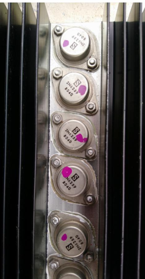

So, i finnaly got around to take some photos of the modules i have.
On one module i also have MJ15003.
2N6259s i have dont look suspicious to me, i think they are authentic,
because the look older as well. What do you think?

Signetics had an S logo like that but a black letter (not white on black background). But I think they were taken over by Philips before 1980?, which is the date code. Not sure, because Solitron also may have had a logo like that. Solitron is still going but no sign of a 2N6259 - these old devices are slow, and many stopped producing them at least on the original process (hometaxial or a near equivalent) by about 1980. They look genuine but they're certainly not RCA. They are probably the last of the species and only available as NOS (very expensive; an MJ21194 would be better) or pulls.
If you want the best out of them it might be worth driving them with modern drivers such as MJE1503x) (TIPs are no use) and use a low base-emitter resistor to help them respond more quickly. 200kHz fT is really slow but these can be made to work with a high base drive (blow and suck) but in quasi configuration, suck means a low base resistor.

The min. gain should be 4, if significantly higher the device you have MAY be epitaxial (RCA changed from hometaxial to epitaxial for many devices around 1978) and may nto be quite so rugged.
Solitron made lots of those old Hometaxials back in the day. I have a bunch of their old 3055’s, and used to have 3773’s before I used them all. Plenty rugged. May not be the proprietary “Hometaxial” process, but were at least a version of single diffused (where the Home part of it comes from).
This is the sort of thing that I mean by “pulls”. If they are in equipment that was working, they’re almost guaranteed not to be fake. Back in 1980, fakes weren’t rampant anyway. I could buy Toshiba C3281’s and D424’s from anybody that had them and get real ones.

Those S logo parts, I used to see them in Lambda DC power supplies & maybe Power-one. Too obscure to be worth counterfeiting. Solitron maybe?
