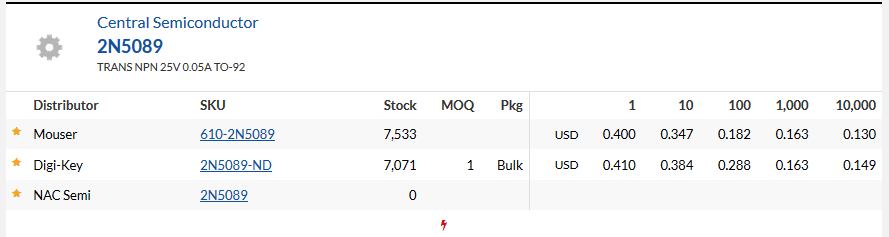

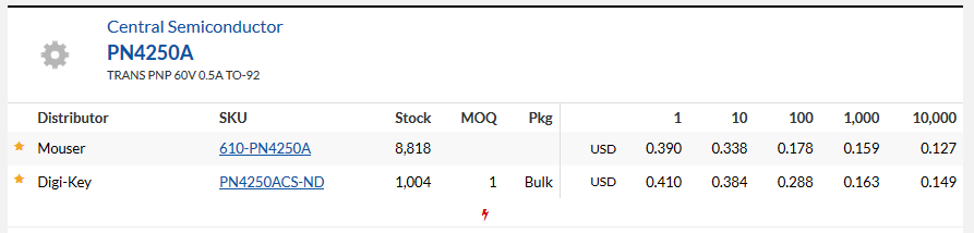

Octopart.com was able to find current production devices for the Bongiorno design, see figures below.
Its gain is set by feedback resistors R16, R17, R8 whose values you, the year_2016 circuit designer, can set however you like. Since this isn't a RIAA phono amp you would naturally omit switch S1 and omit the entire "G" signal path (R13, R14, R15, C7, C8).
It is interesting that Bongiorno feels his regulated DC power supply is more elaborate than the power supply designs in other 1972-vintage preamps, AND he feels this is crucial to the ultimate performance of his design. Maybe you could add your own year_2016 innovations and improvements to this portion of the circuit, and get something even better than Bongiorno did, 44 years ago.
