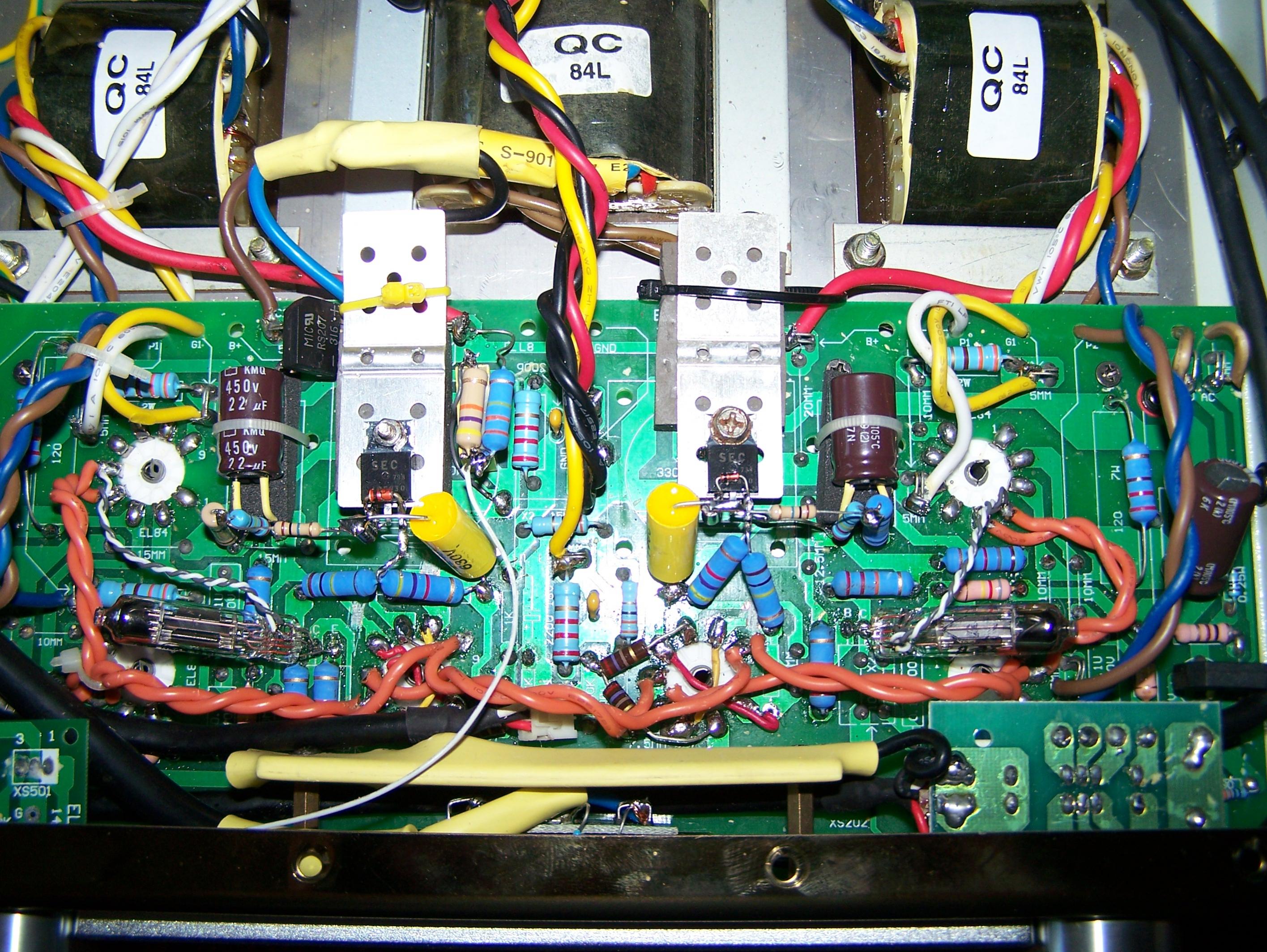

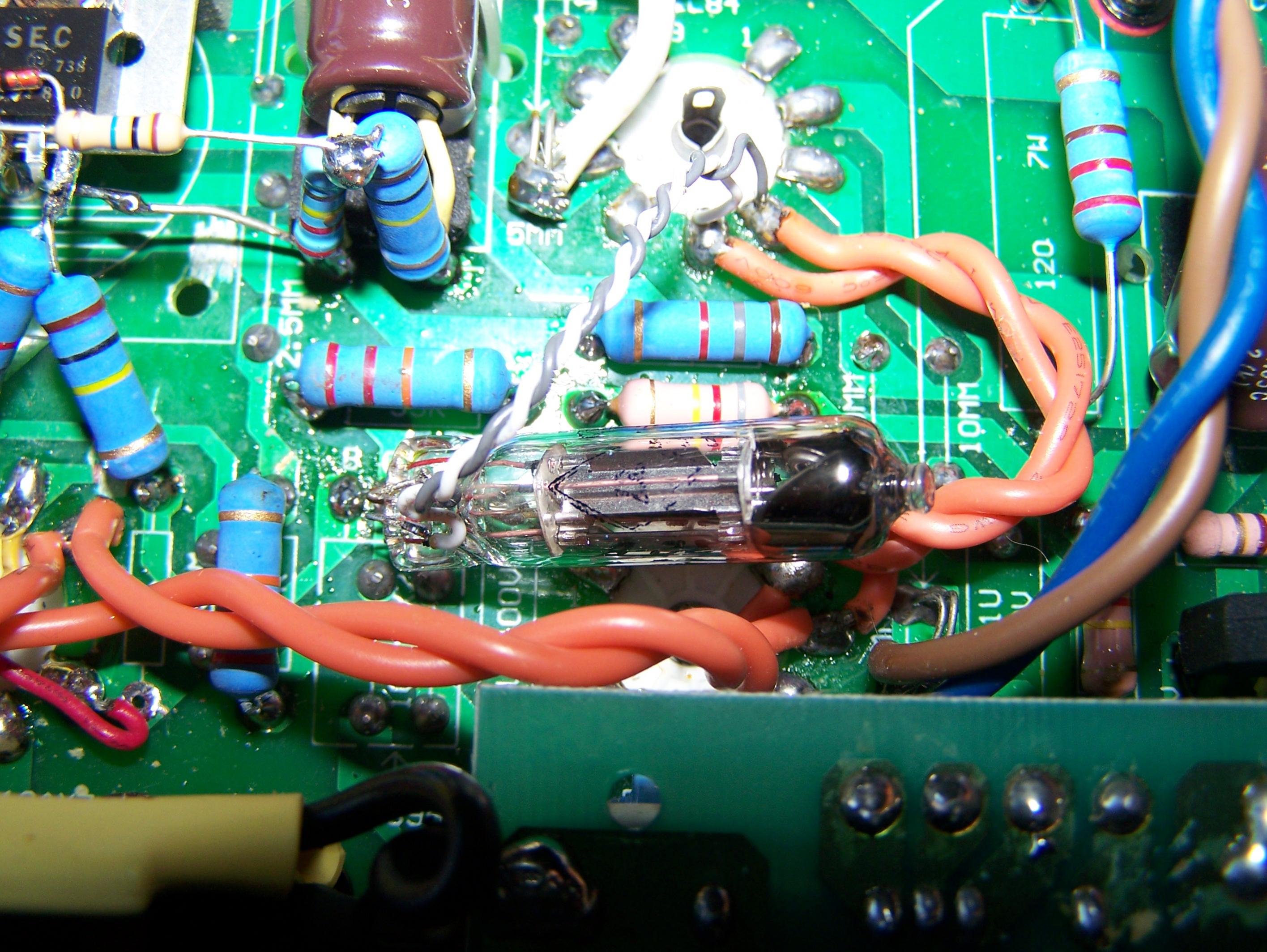

Nah--Pulled the Transistor, and bunged a Tube in its place.....
(Wire-ended 6C3B-V,--bit like a 6SN7ish,--one for each channel)
22K cathode/anode resistors, then DC Coupled to the gain stage, 12AX7/ECC83 dual triode--which is strapped in Parallel and with a MOSFET on top, signal taken from the source!
Deleted the cathode decoupling cap from first stage too.
Also changed the G1 resistors of the EL84 from 220K to 820K, and the cathode-resistors of the EL84 to 220 ohm.
Now its sounding Nice!
Here you go, Very untidy, need to make up some small boards for the MOSFETS and their associated circuitry, but needed to prove concept and listen to the modifications....
