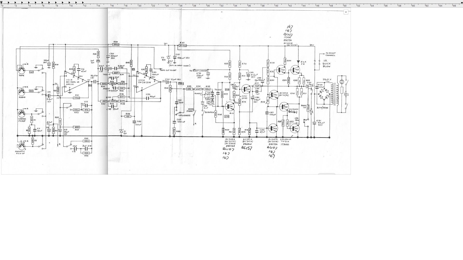

I have been restoring an old integrated amplifier.
I found various problems which have now been remedied, and I have replaced all the electrolytic capacitors, transistors, and both ICs.
I think that I have finally got the bias set correctly, although it seems to be a very delicate balance between distortion and running very hot indeed.
It sounds very good with CD as source through either Tape or Radio input, but output is very low when used with the MM input. I have tried a few different cartridges with no noticeable difference, and I know that CD output is always much higher than MM (and probably higher than tape or tuner outputs when the amp was made) Since it is not very powerful, but still sounds very good with a high level CD signal, my question is: can anything be done to modify the MM input circuit to increase the gain? I am not sufficiently knowledgeable to be able to understand the circuit, but I am able to use a soldering iron and DMM, and I would rather modify (if possible) the circuit than use a separate phono stage, and use it principally for playing records not CDs.
I would be very grateful for any advice!

Decrease R20, if you're sure you won't connect any high level source to it ever again.

If you close the switch connected to R23 it should give you the required gain for MM inputs.

I'm not sure which of both switches drawn beneath IC1A engages a RIAA network, as such networks usually consist of two resistors in series, paralleled with a capacitor each. Anyway, make sure one of these switches is thrown and working correctly if the phono input is used. If still too quiet, decrease R20 to, say, 680 Ω. Try other values, if necessary.

Re R23 - are you sure about that? When the switch is in the down position and R23(?) is selected that looks like RIAA EQ. When its in the up position, R20 is shunted by R27 and R25 - difficult to read the values.
The network with C19 must be the RIAA network, as it's the only one that defines two poles and a zero together with R21.

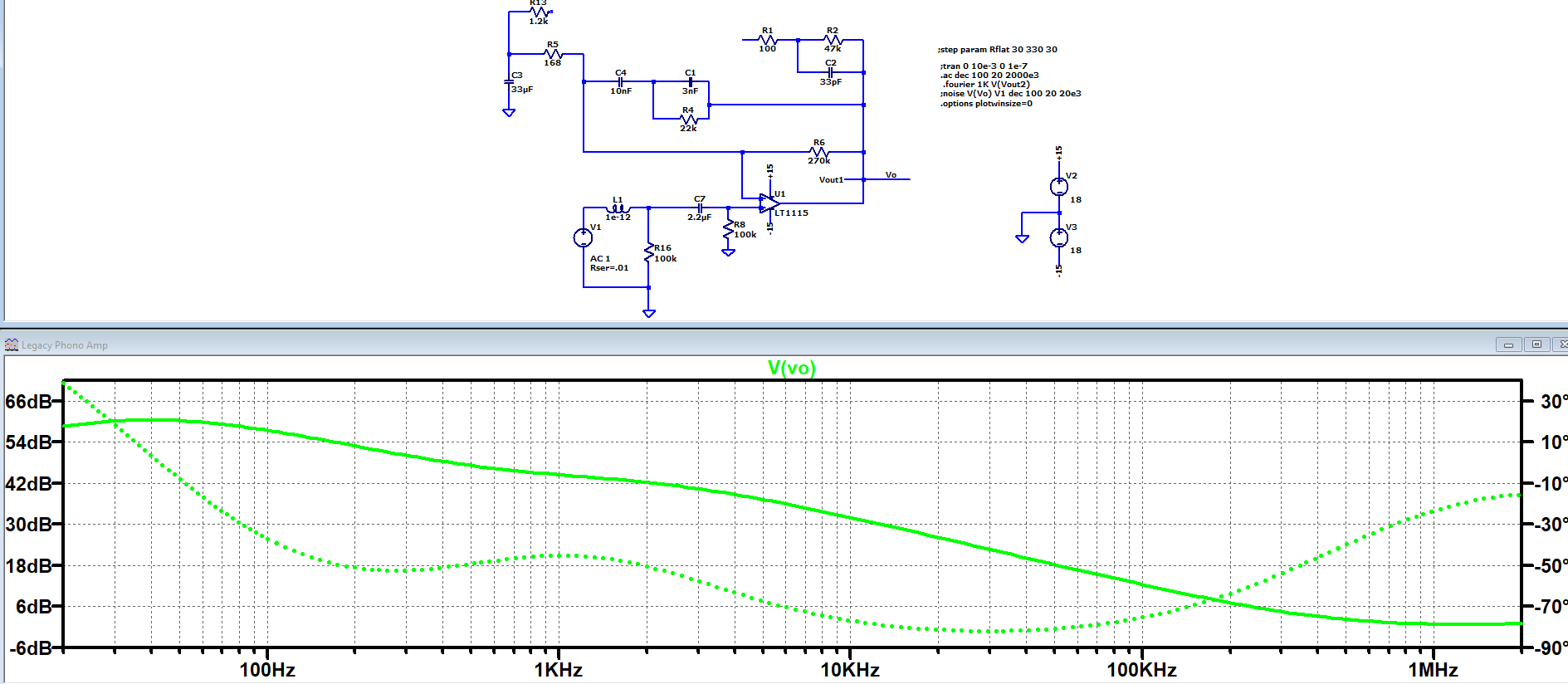

Yes -you are right. Here is a quick and dirty sim - I might have some of the values wrong though. The 1kHz gain is 45 dB

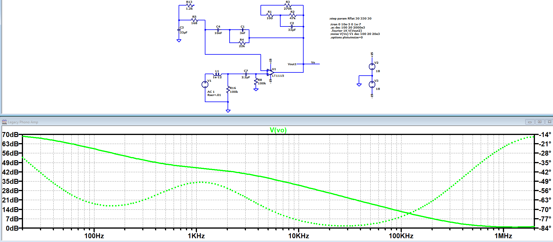

Here - mid-band gain essentially unchanged but the <50Hz response cleaned up. If the op can get the MM fixed, it should be ok gain wise with a 5mV cart.
With R20 = 1200 ohm, the gain must be about 7 times less than with 168 ohm, so around 27 dB rather than 44 dB at 1 kHz. That's rather low.
If you want to reduce R20 and keep the shape of the subsonic response the same, increase C15 by the same factor so that their product stays constant.

R20 in the original circuit looks like 1200 ohm to me, no idea why they chose such a small ratio of the feedback impedance to R20. Lower line levels and more sensitive MM cartridges? Too low open-loop gain of the op-amp?
The switch connects to R23 at the same time as the switch to the left of it on the diagram - the ceramic cartridge input. When the magnetic cartridge input switch is selected it automatically disconnects the ceramic input and connects the switch to the right of it as well, connecting R20 to C19 (is this the RIAA EQ for the magnetic input?)

Ah, that means both switches drawn beneath the gnd line are actuated the same time, as well as the pair above this line? The circuit drawing lacks some clarity here 🙄. Hence, there's some equalization for ceramic PU's also?
But what does R27 (68k) do exactly? It appears to be superfluous.
