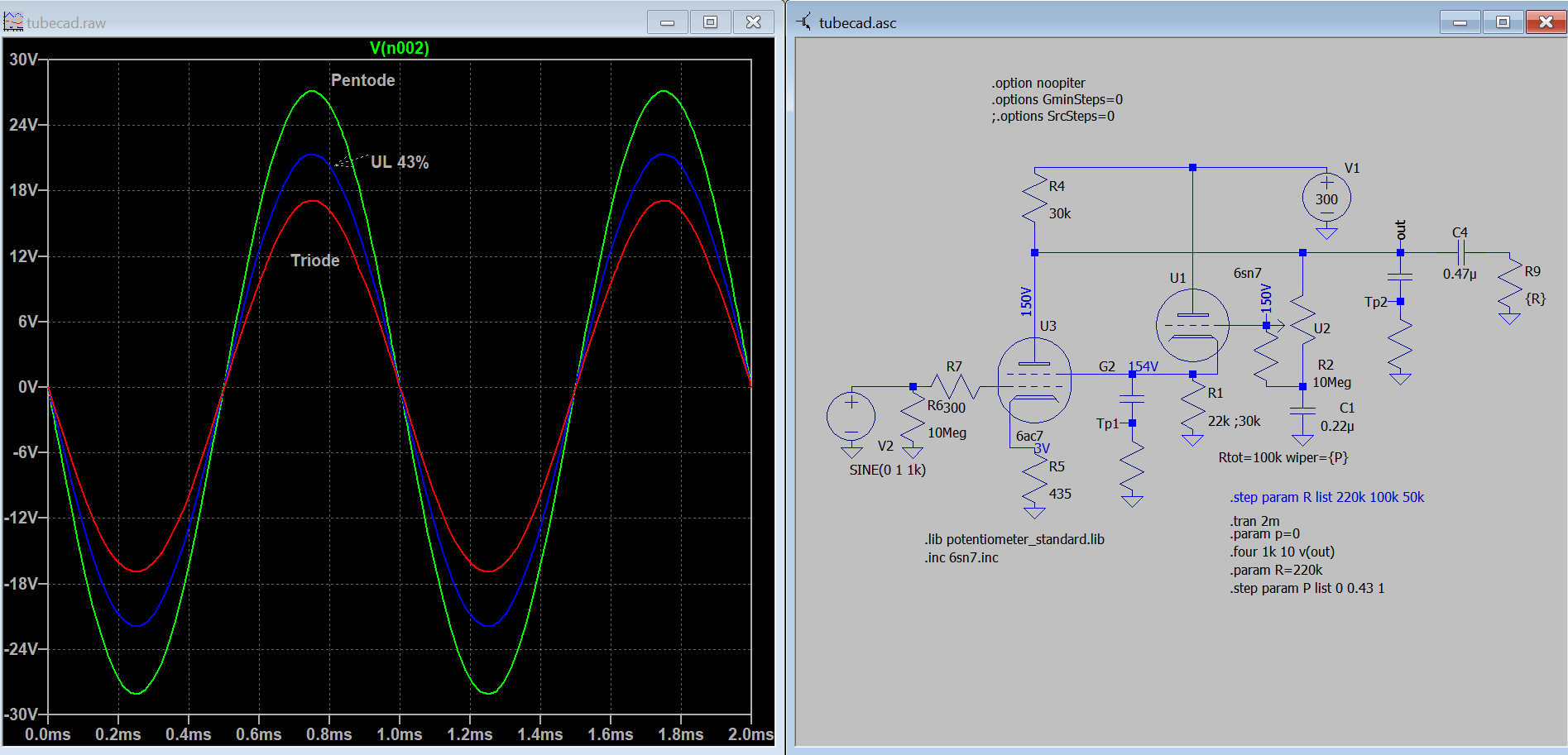

Transformerless ultralinear?
What definition do you subscribe to?
I/V curves that are midway between pure triode and pure pentode modes.
Yes, your model needs a fixed DC voltage in series with the screen grid in addition to the feedback voltage.
As I posted on #19, I know there's has to be a DC voltage. But take a look at the two links to tube cad journal:
The Tube CAD Journal,Ultra-Linear Output Stages
I don't see any g2 fixed DC voltage. Is there?
Would you consider them as ultralinear circuits?
I don't. The simulation results attached to my first post show I/V curves lower than triode's (and not between triode and pentode mode).
Would this sim helps you to see if it claimed what it does? I hope you compare the UL curve plot to actual UL curve from original manufacturer to see it's any differences, that is the best way I think.
If that is your preferred definition then the Tubecad cascode circuit is not UL, it's just local feedback around the upper triode.
However, the Tubecad pentode circuit is UL, since it has a fixed DC voltage applied to the screen in addition to the AC feedback (150V is stored on the .22uF capacitor), so it will be somwhere between triode and pentode mode.
Yes. It helped me to simulate transient response instead of just doing a spice dc simulation.
Yes, that capacitor is the "magic" that solved the mistery for me.
Thanks for pointing that out, Merlin.
Edit: why that 10 Mohm resistor in grid of the 6SN7 (pentode circuit)?
