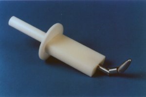

Actually UL is not as picky as some would think. It is basically about 2 things. First, don't shock people. Second, don't start fires.
As long as an item is designed durably in accordance with its intended usage and reasonable accidents; you're good to go. That does assume that live parts are tested for access... or perhaps lack of access.
They use an official finger thingy ($250😱 ) to test for access. The tip of this thing has childish proportions:
Now... if you decide to take a bath with your speakers or cut your amp in half with a chainsaw; U.L. could not care less about you getting shocked. In that regard, they still support Darwin. They would however, still be a bit cranky on the fire side of things.
