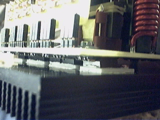

zenmasterbrian said:Anatech, the Class-D thread has been reopened.
You can't depend on the thin layer of mica for your power mains isolation if your heat sink is on the back of the box.
The "thin layer of mica" may block 5000 V quite easily. However, it has to be thick in order to reduce capacitances from the transistors tabs to the heatsink in order to keep EMI under control.
Aluminium oxide (a white ceramic substance) is routinely used in place of mica for class D applications. See picture :

Hi Eva,
The problem with relying on mica insulators for this is the workmanship of the next technician. You have to make the assembly inherently safe (within reason).
