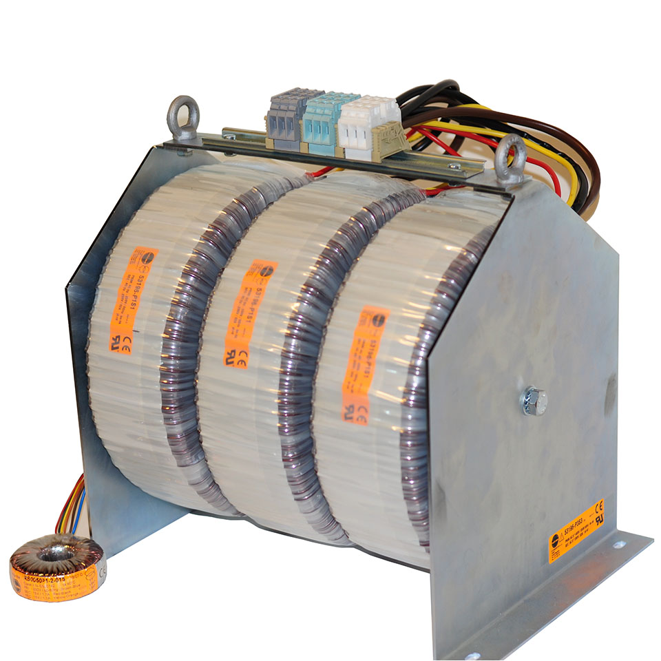

This is just for one channel on my 50w Single-Ended BAF2015 Schade Enabled amp!
attachment.php
