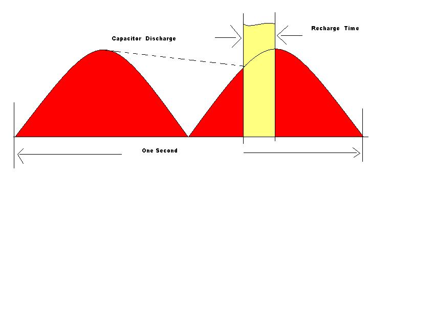

This most likely will be old info but are you aware of the current spikes you will encounter with SS rectification? Rule of thumb is current spikes of ten times load, or 200mA load will get you 2.2 A of spikes. SS is very hard on transformers..and lets not forget start-up surge. You would need a true OFF/START/RUN switch..or go with thermistors, or??
The point is SS has a very short time within the charge discharge cycle to firm up the voltages.
If you play around with Duncans fine SIM program you will see these parameters......I get a real kick out of tweeking the choices of values in the Duncan program...It can all fall under all the ratings if you just keep at it.
