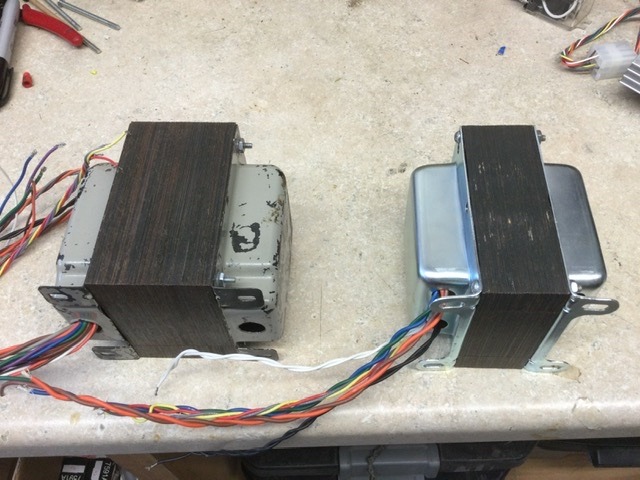

That looks to me like a #19, which is good for about 2 amps in transformer applications. Based on core size for most MOTs you’d need about 2.75 to 3 turns per volt to get the flux density down to something normal so it doesn’t sound like a stalled electric motor while it’s running. If you have 120 volt mains that’s 360 turns. Double it for 240. I’m not even sure that would fit - without a secondary. If you run with less turns per volt, it will probably vibrate itself off the table and run hot. I would find a better donor core than a MOT. Something out of a junked receiver would be where I’d go looking. One with a plastic bobbin is far easier to work with - manual winding works almost as well as machine winding with them.

Both of these were salvage jobs custom rewound for tube amps in progress. End bells are new on the small one. The bigger one is 1.8 turns per volt, the smaller one 2.75. That’s what it took to get them quiet. The smaller one is about the size of your typical MOT.

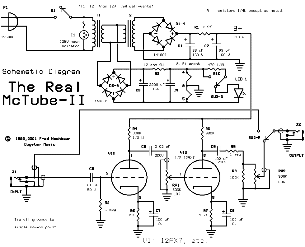

It is sorta desperate way to get high voltage on a budget in the world dominated by the low-voltage solid-state electronics. There is a point in using two transformers with 6 or 12 volt secondary to get also the heater power, but if you intend to use separate transformer for this, than the isolation transformer (230V to 230V) might be more useful and economical.
That + 1000
It always struck me as a bulky wasteful "solution", only justified if you have a shoebox full of pulled/recycled small trafos ... and even so ....
This is an "official" design which got somewhat popular ...and even so notice +V consumption is minuscule, just a couple mA.
Suitable only for a Preamp (in this case a Guitar pedal) and not much else.
Rewinding, salvaging, using back-to backs make sense in places where you can’t import anything (like the relatively inexpensive Antek units) or you want something custom that would end up costing a fortune (like the ones in my pic - which was to give a sense of size vs. how many turns you need). Or if $28 really IS a barrier in your situation. At one time it was in mine. That’s when I was schooled in the art of trafo winding. It was either that or use 9 volt batteries.
But MOTs really are a poor choice to salvage. The only thing I’ve ever recycled them for were battery chargers (which would jump start a car). Took two in series to do it but they were free and I didn’t care that they sounded like a low flying plane when cranking. Of course I kept the original primaries.

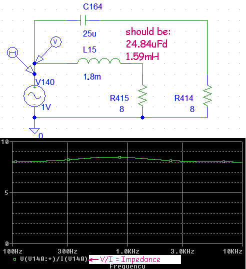

and some of you can help me with this: I have a question that is driving me crazy!!! here’s the thing: if I have two secondaries in a out put transformer ( like sowter does 4 + 4 Ohm for example) in a 2 way speaker, can I connect a speaker, on each secondary? and what will be the impedance at the primary? example: 5k at the primary, 2 + 2 Ohms secondaries, 8 + 8 Ohms speakers. I much appreciate!!!
Thank you PRR, but I really can’t see, the speakers are in parallel and they are seen even they are not concerned by the signal….proper crossover do you mean at
least 24db, and if I heard one note at the time?
No. The result is general. If you send lows to one load, and highs to another load, with any reasonable division in the overlap, the total network impedance is "Flat".
If I use the "exact right" filter values, the line is dead-flat, and it looks like a trick. Here I have a 13% "error" in the coil value which gives a 6% rise of impedance at crossover.
