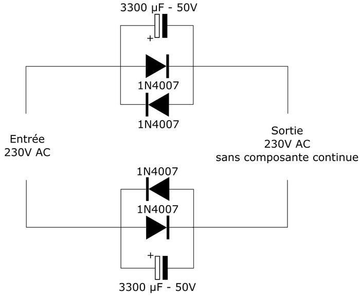

About twenty years ago, I worked on the transformer of my LINN-LK2 amplifier, I used cyanolit-green(and only this one), it is extremely fluid, and is perfect for this kind of use, on the other hand it takes a lot .... guaranteed result.
See photos
Regards

Hello,
In 1970, this type of Cyanolit-green appeared in France, she is a very special glue, because it sticks by infiltration only and it is extremely ultra-fluid and flows a lot so its perfect for isolated and reduce transformer noise.
The Linn-LK2 have a 500VA toroidal transformer, after dismantling I emptied a +/-20 of cyanolit-green tube on the top and the bottom of the toroid.
Excellent results very reduced noise, and a little better in terms of sound.
One of the interests of this glue is its extreme fluidity which allows it to go in depth.
