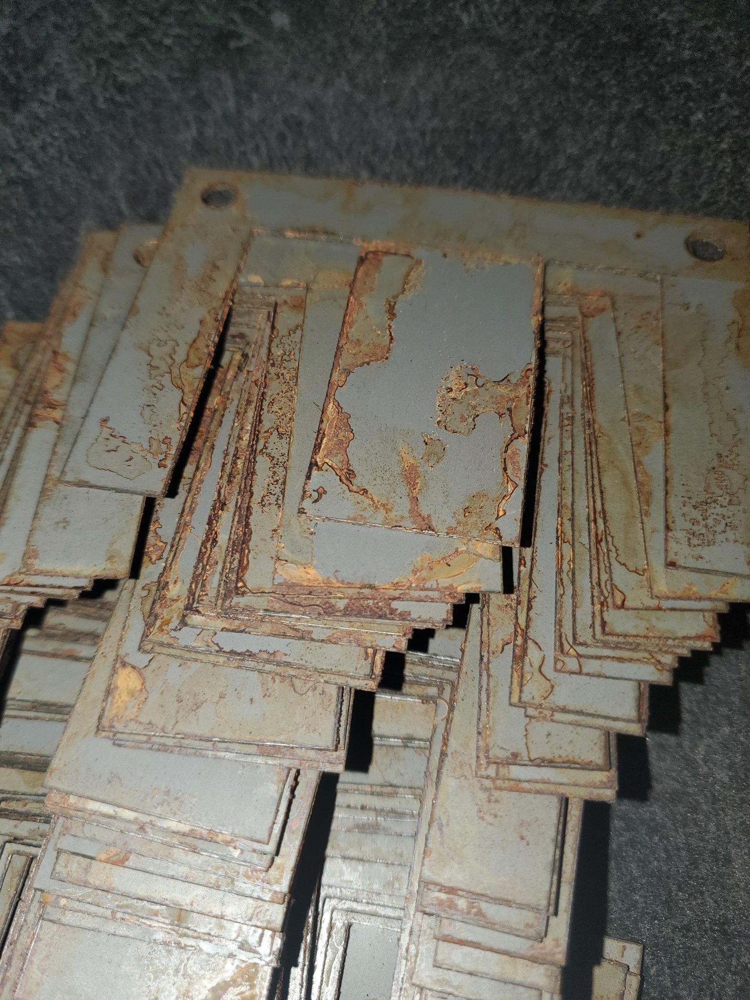

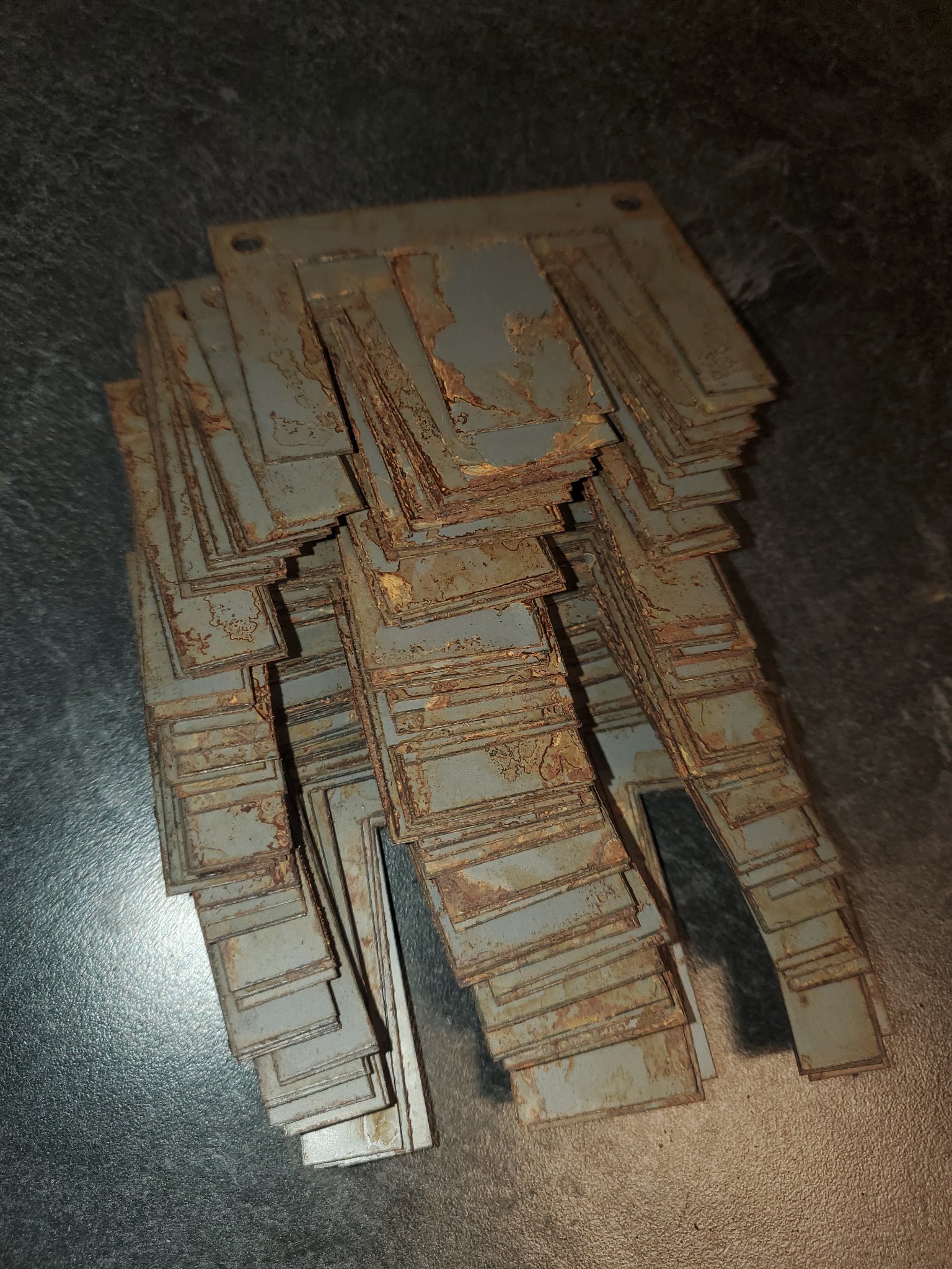

Hello all, I am building some custom output transformers from old iron. It is slightly rusty, is it worth removing, and if so, any recommendations on best way. Preferably without sanding.

I've used a wire brush, then a coat of phosphate rust converter, followed by a second coat of same or a coat of spray paint
^ Absolutely true! In addition, rust means bulging, the lams' total volume increases, you'll expect issues while packing the correct number of lams into the bobbin.
OTOH, just surface rust on a complete lamination stack isn't any problem at all, electrically spoken.

OT laminations need to have an insulating layer/coating at least on one side to avoid eddy currents.
If you remove the rust you'll likely remove the coating.

Yeah maybe I'll strip them, vinegar. Then dip in a lacquer, or something very thin? Would also prevent future rust.
Vinegar is an acid and acids cause corrosion.
So the vinegar treatment should be followed by a neutralising bath in water dissolved baking soda before lacquering.
The solution is vinegar 😁.
Jokes aside, is vinegar low enough in ph ? Sulfuric acid or phosphorus solution, phosphorus solution turns rust into a black coating that prevents rust.
Vinegar ( = diluted acetic acid) is known to attack a number of metals and cause corrosion.
True, hopefully attacking the rust first. Then neutralize and treat for corrosion. The vinegar is acting very slowly, which is good, but its quite a bit of surface area. I wonder if black oxide would be a good idea? And another question, does the hardness of the material change its sound? I could easily harden the plates to any hardness. Soft, to tool steal.
