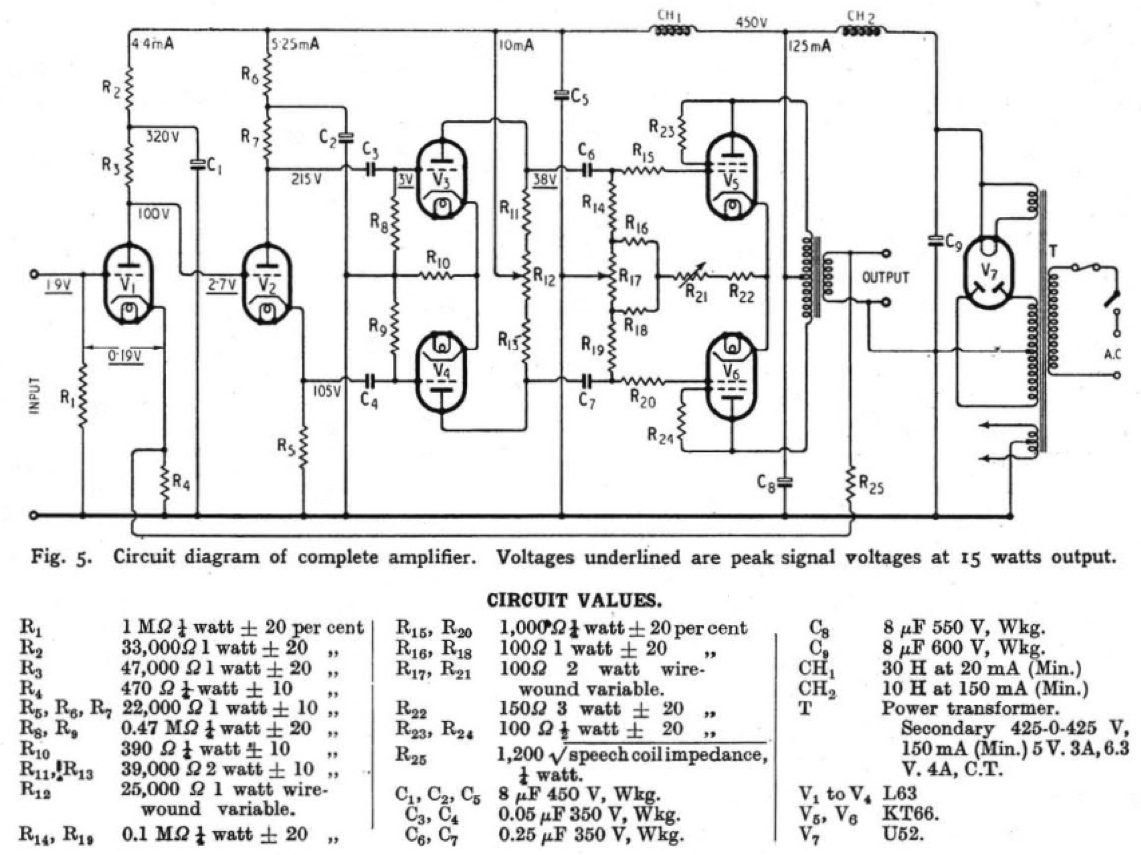

I am trying to build a Williamson amplifier, using 2 x 2 - 807s for the output stage.
How do I decide what output transformer is needed, using the tech data of the 807 beam power tetrode?
The best way is to trace the loadline in the graph, and choose the best operating conditions for the tubes.

Read the Source:
http://www.r-type.org/pdfs/dtnw-amp.pdf
Williamson designed for 10kCT loading, big power tubes triode-wired. 807 is not that different load-wise than KT66. Different supply voltage has significant effect on best loading.

Do not try to pull a new circuit out of the blue, specially if rusty on tube amps.
Either follow your Tech´s suggestion literally, i.e. build a Williamson amp "by the book" or find another circuit that suits your needs and build it.

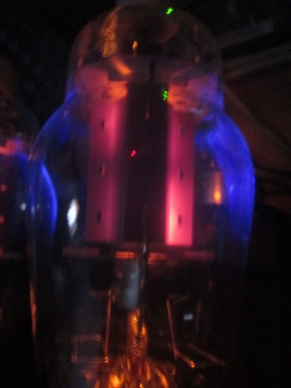

Yes and if you care to look carefully you will notice the maximum allowed screen voltage on 807 is 300V absolute MAX.
Certain by no means all 807s will manage 400V if connected as triodes.
Running them at 450V like in the designs shown will result in almost immediate 100% destruction of the screen grid.

That is a 100% load of codswallop.Yes and if you care to look carefully you will notice the maximum allowed screen voltage on 807 is 300V absolute MAX.

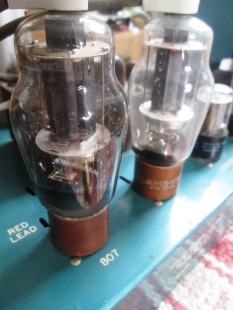

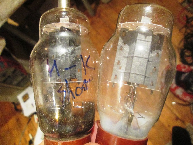

I have to say having tested a load of 807s, that the production spread is enormous, and they certainly don't meet spec.

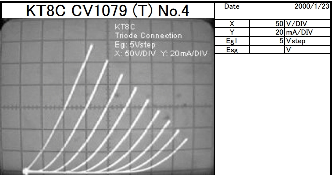

I had loads of them, which is why I chose to use the KT8 which has a much larger cathode.
Another forum member has confirmed the same story having had 100s of them.
The sensible choice is to use 807s in legacy museum amps that are big enough to accept them, and do nice upgrades and restorations on them.

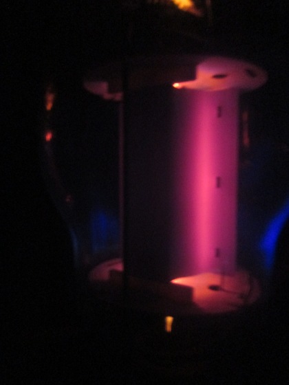

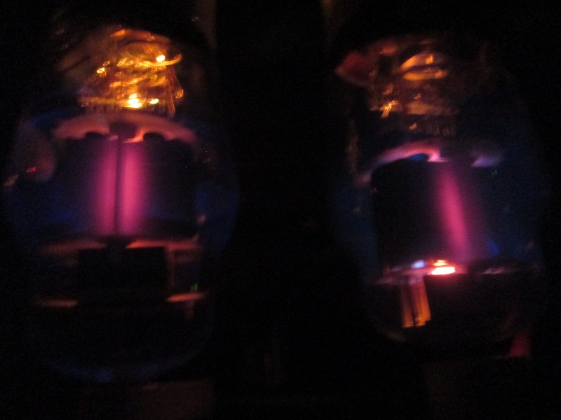

The grey plate 807s will certainly never run as triodes,- they are the first to start to red plate in the anode corners at 17W.
The black shiny anode ones seem to fair better, but oscillation has always been an issue especially if you wind up the g2 voltage.
A few had 6L6GC guts stuffed in them.
90% most of them certainly won't manage 25W without glowing all over red, and once you start doing high power testing would melt the screens as soon as you start doing 1khz square wave stuff.
The only good reliable ones here really are the French Thompson 5933W, but someone else told me that some time ago, not tried to convince me of the impossible.
I tested all I had until I could get acceptable matched pair reliability from just TWO PAIRS, and that running with a fully regulated screen at 300V.

The other 807s I tested are uniquely unsuitable to both triode use as well as ultralinear for the many reasons I won't bother to repeat.

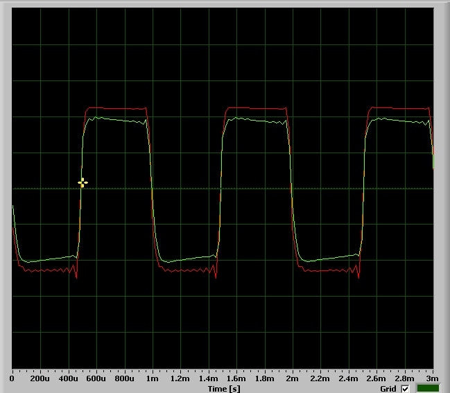

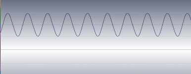

Notice the linearity of the square wave trace at 70W, the input from the centre tapped choke feed, which of course people claimed can't work, followed by the output trace from the output transformer which people also claimed can't work... (can't possibly be a quality transformer can it!).
I always test amps at FULL power, where they have to demonstrate their ability not to blow up or show horrible distortion in any frequency band.
I get a bit annoyed by people who constantly claim they know better but ain't done it, they read the book, but don't see the video, hear the audio or go there... armchair enthusiasts as usual.

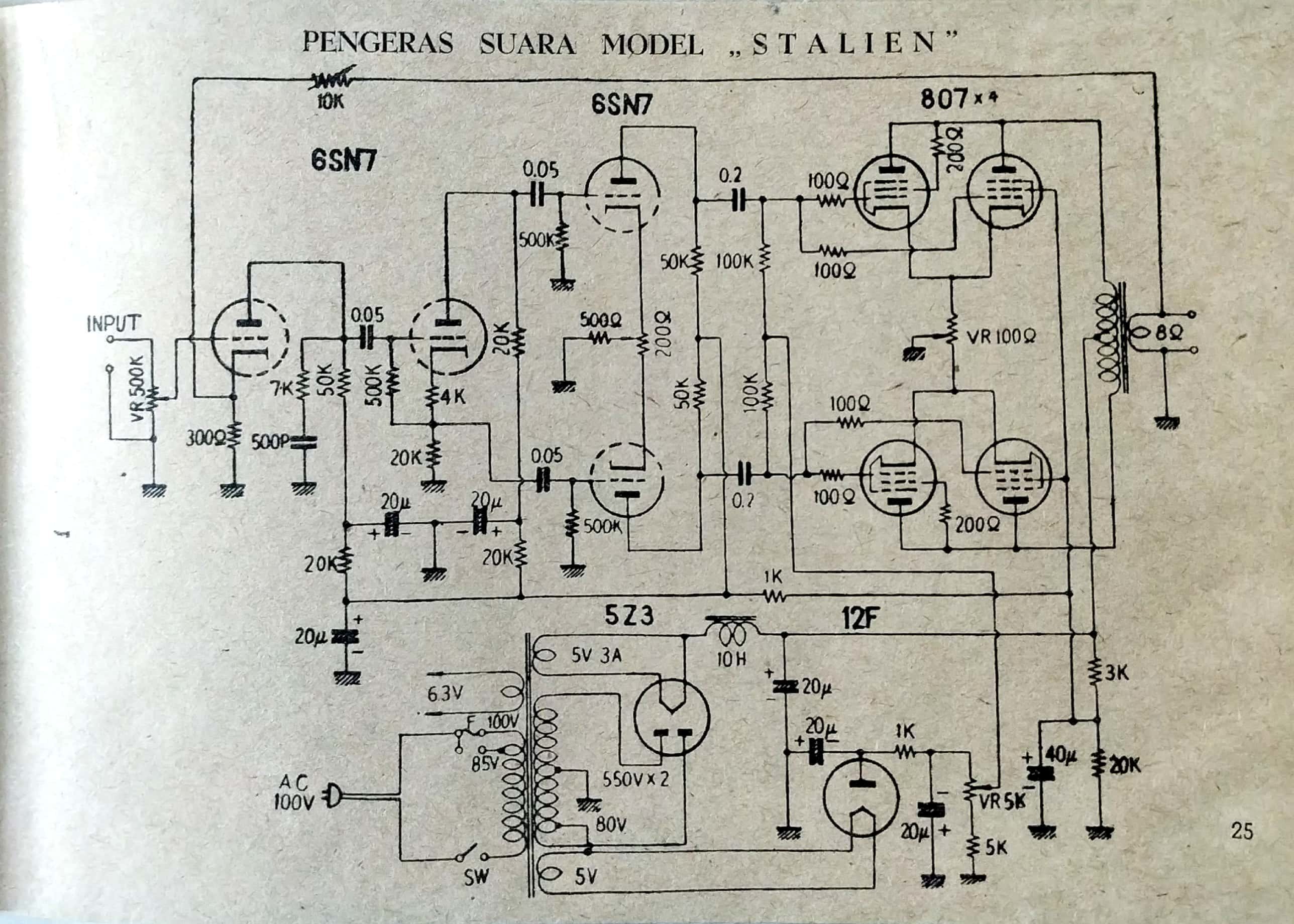

How about this, found here Tube 807 Push Pull Amplifier Stalien - Old Schematics
I don't like how the outputs are paralleled without current sharing resistors, and the grid coupling cap between the voltage amplifier and concertina...
One thing for sure, that design will oscillate like fury (usually at around 1mhz or so) but probably in a fairly nasty pulsing fashion, making it hard to trace, at which point very strange things will be happening in the NFB loop thanks to our friend Miller.
It also requires very carefully matched pairs of valves.
Ask me how I know all that.
I saw a brand new 6x-x8 go into oscillation so fast, by the time the anode had gone bright red it was too late.
