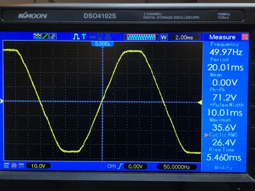

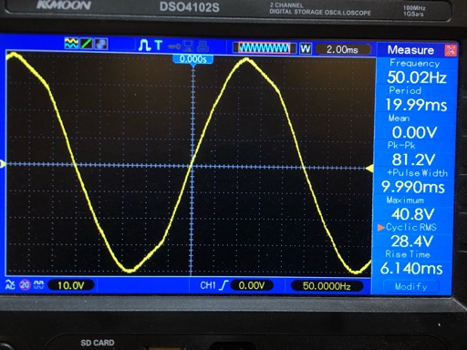

I'm pretty sure I am feeding transformer with 230V, otherwise I would not be writing this. There is 3X230V and no neutral, like in many old houses in Belgium.
My gut feeling is that the transformer(s) are of lesser quality than they should be. Hence, would you be inclined to try:

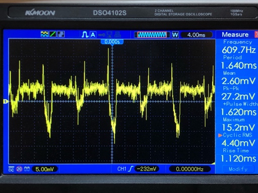

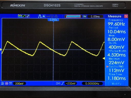

Do you have a scope, and the capability of looking at the quality / stability of the voltage, as being forwarded from the PSU to the amplifier boards? What does the rail voltage actually "look like"?

Preamp shorts the inputs few seconds during power up, still a hum as soon as transformer is on.
I did a test with another 225VA 2x24 transformer, outside the chassis, around 50cm away. It was less hum, but still there. Should I increase the distance?
I also replaced one front end power supply (LM317 based) with another, which is LT3062 based. Hum stayed the same.
