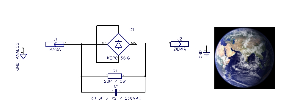

Maybe worth trying?There is no connection between audio ground and chassis. Chassis is connected to mains earth.
This is a parallel connection of
a). A rectifier bridge, 50A/1000V, with shorted plus and minus,
b). 100nF / X2 certified / 275VAC
c). 2.2 ohms resistor, 10W. (as in 2 point 2 ohms: missing dot on the drawing).
The elements are somewhat over-sized, because they need to survive a critical event, that hopefully never happens.
Did you try a Zobel directly on output of each transformer secondary?
Example: 100nF + 75 ohms ?
(series connected)
(series connected)

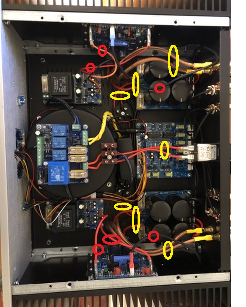

I have another FC100 amp, same PCB layout, pretty much same chassis only bigger. It also does not have audio ground connected to chassis, and yet no hum. No snubber diodes, no wire twisting, etc.
The difference is in transformers only - noisy one uses single 500VA industrial transformer, silent one uses two 250VA potted transformers.
This is why I was inclined to go for transformer change. If it was a BUZZ, I'd start looking at ground loops, but it's a HUM.

I think its due to running unshielded mains wiring above the preamp pcb (if I understand that photo correctly).
Yup. Or at least tightly twisting those two together.Why do you think the hum from the speakers is anything to do with the transformer?
Actually, I missed out on that photo pasted at the beginning of the thread. Looking at the photo now, I see ample opportunity to twist some other leads together too. Pairs. Triplets.
Ziggy would be twisting in there quite heavily.
If my understanding of the cabling topology is correct, I would twist together the ones embraced by painted yellow ellipses.
What I would also do is re-check, that the screen from each of the RCA input jacks is isolated from the chassis: no electrical connection between the RCA outer body and amplifier chassis.
What is the function / role of the single unpaired wires, as marked in red on modified picture below?
Would it be possible to twist them together with their direct peers?
Why does the black one go somewhere totally different, geographic-wise, than the other two?
If these are Rail+, Rail- and Analog-GND, would it be possible to make a twisted triplet out of them?

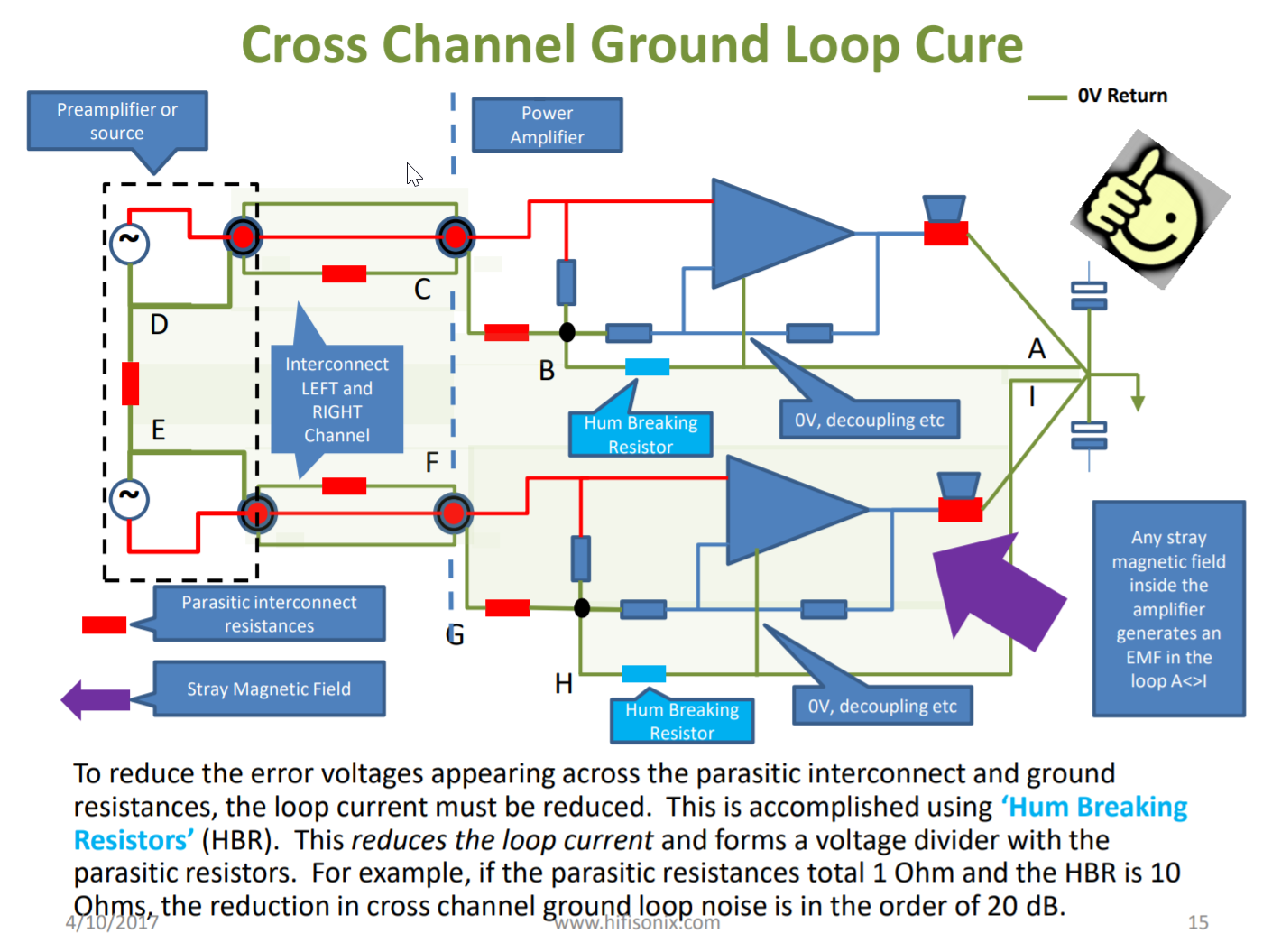

The buzz will very likely need a dc trap to eliminate.
1. Try rotating the transformer. That's what cured my hum finally.
2. How many secondaries do you have? Are the two channels fed by separate secondaries? If not, you will have hum.
Not necessarily, it can be contributory to a cross channel ground loop.Are the two channels fed by separate secondaries? If not, you will have hum.
Yes, that's what I meant. Sorry if the terminology was inaccurate, but the cross channel ground loop will manifest as hum on the speakers.
Yes, separate supplies means that loop can't exist, I was only saying a shared supply doesn't mean it's guaranteed.
