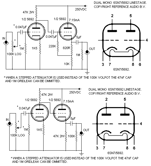

If someone jumped off a cliff would you follow them? To be blunt there are far better preamps out there than this one. As mentioned the 6Sn7 is a very fine tube very linear and very fine sounding and well worth consideration. Check out Frank's 6Sn7 linestage. Its a far better unit to build.
This is far better and will drive the longer cables.
