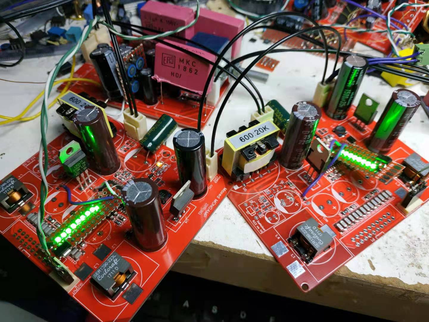

Oooohhhh, I see you have gone for the string of capacitors on output, this can be interesting : ) Did you get to hooking up stage Richard?Started the build last night, not sure whether to go 'denoiser' or try out some new shunt I made for tweaking the sound of my newly-acquired PCM56 DAC. Decisions, decisions....

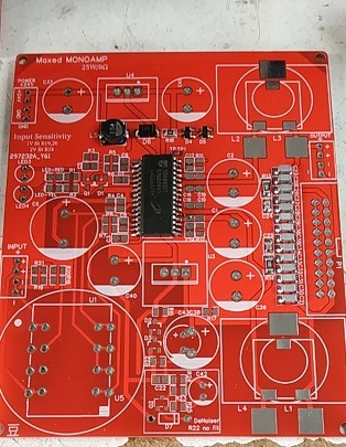

Oh btw @jimk04 the board does already have provision for a bigger inductor - could those be SER2918s?

Just finished the second AMP211 and having a listen. I went for the shunt PSUs in the end which are created out of a string of 9 green LEDs and a couple of transistors. I guess the next step up is the SER2918s? Oh and going up to 15,000uF for C6. The boards are arranged at such a jaunty angle because I didn't make the interconnecting cables long enough.

My immediate reference isn't the previous incarnation, rather an experimental enhanced version along the lines of @IVX's idea over here : https://www.diyaudio.com/community/...essimistic-review.277130/page-32#post-5527982 That one did sound slightly more transparent than the original monoAMP, on this I've not noticed a step backwards yet so I suppose that's quite promising. I'll need more long-term listening, and directly against monoAMP before putting any impressions down in writing. I'll also be interested to know which mods give the most improvement, I'm guessing the lower noise PSU contributes more than improved output inductors so I might experiment with just introducing the shunt to the original.
Hi Richard, awesome! Great to see the new boards in action. When comparing to the original are you using the same setup as references - the new input trannies, capacitor string output and board cap values? All things equal, that would be a solid comparison : )Just finished the second AMP211 and having a listen. I went for the shunt PSUs in the end which are created out of a string of 9 green LEDs and a couple of transistors. I guess the next step up is the SER2918s? Oh and going up to 15,000uF for C6. The boards are arranged at such a jaunty angle because I didn't make the interconnecting cables long enough.

I'm not using the denoiser at present, rather my green LED shunt together with the original LM317 configured as a CCS. I'll work on a retrofit of the shunt into a pair of (old) monoAMPs to work out whether that alone is giving an improvement. I have previously tried the multiple paralleled output caps and didn't notice the SQ change.
This sounds very fun! : )I'm not using the denoiser at present, rather my green LED shunt together with the original LM317 configured as a CCS. I'll work on a retrofit of the shunt into a pair of (old) monoAMPs to work out whether that alone is giving an improvement. I have previously tried the multiple paralleled output caps and didn't notice the SQ change.

Got an order in from Mouser and so I have the big coilcrafts now, they do line up to monoamp quite nicely as shertzy proved. Just the 3rd NC mechanical strain relief pad nowhere to go but obviously that's easy to sort a reasonable solution for for now.
