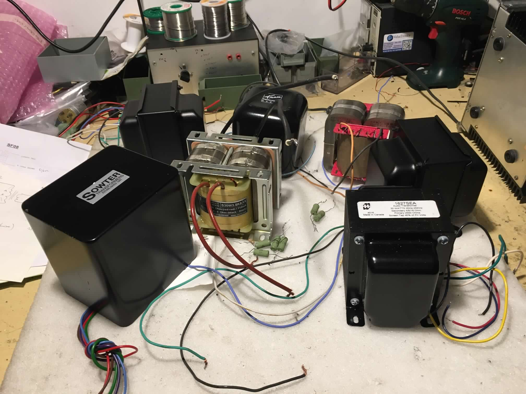

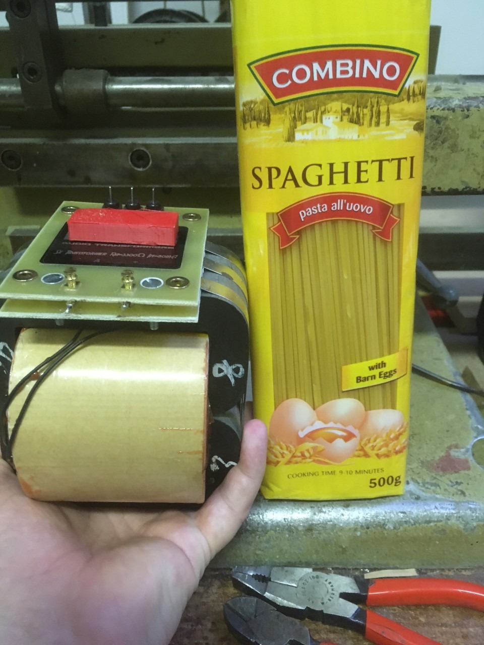

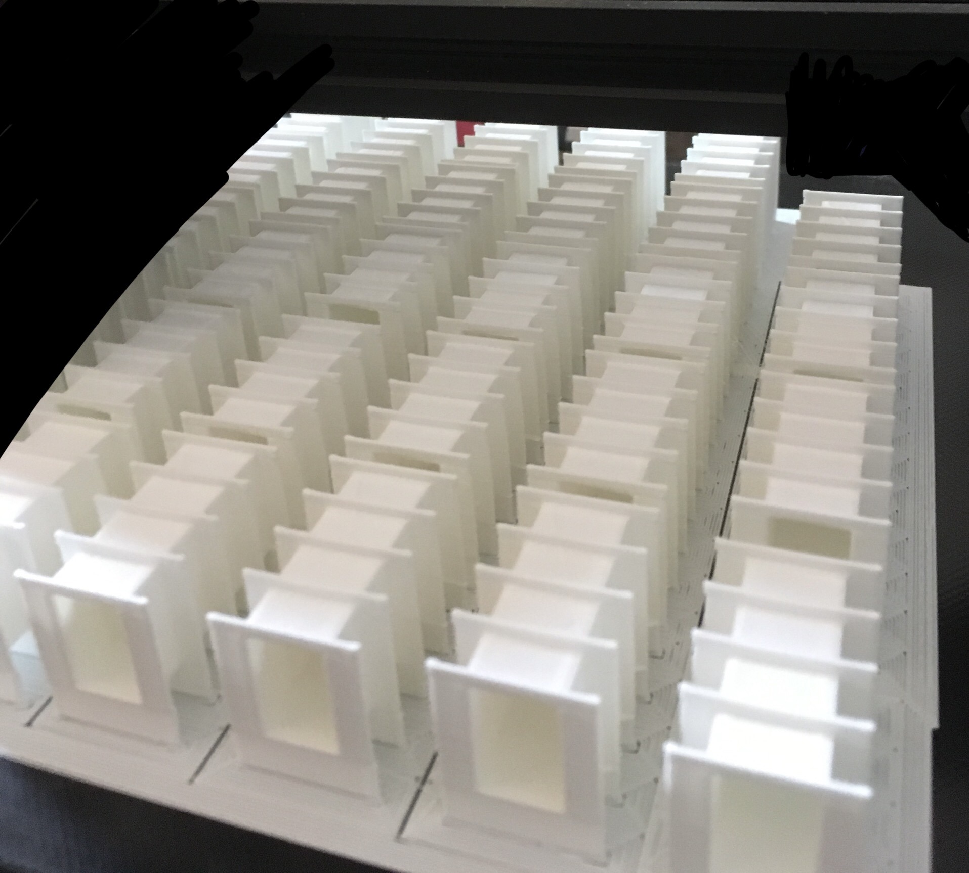

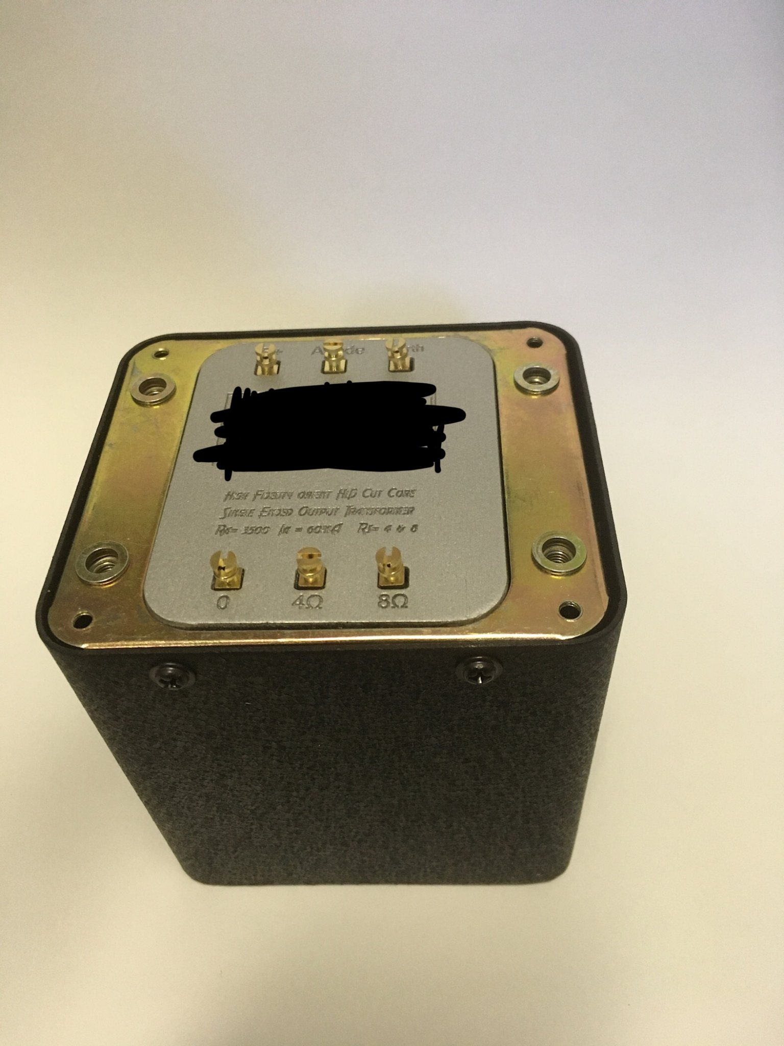

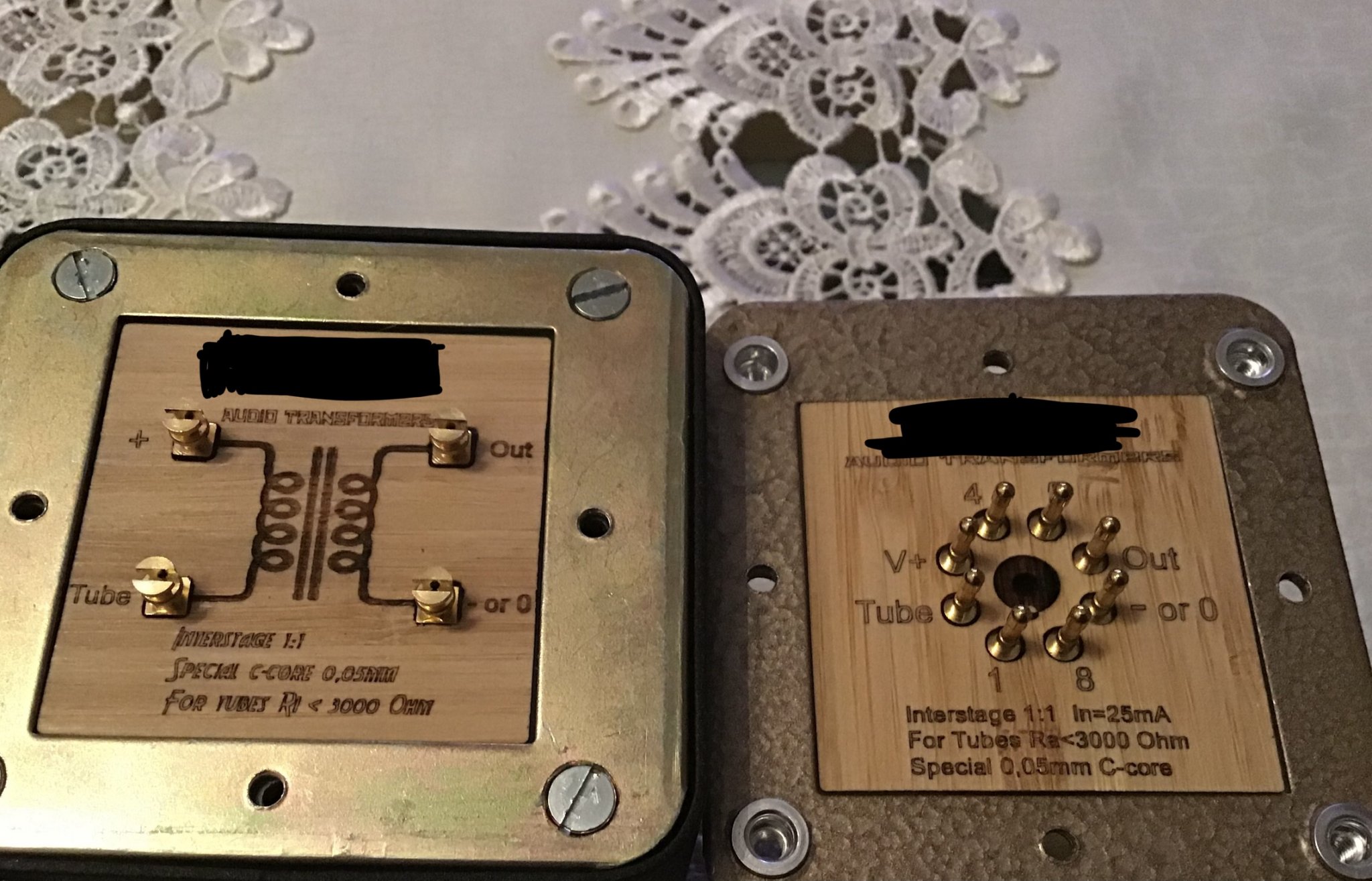

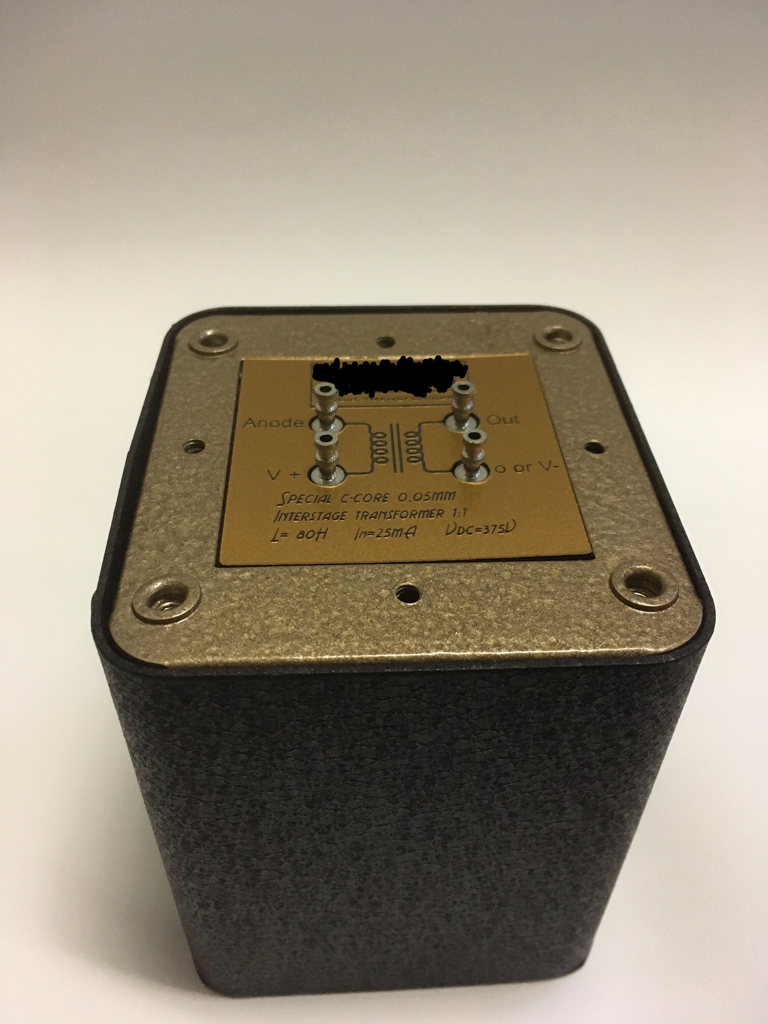

These are some of my OT s.e. I am playing with test

Juso another consideration
Each OT trafo is a bi-directional device.
Then it is funny that a tech consideration from who sent a square wave of +/- 80 mV can explain the life of one OT trafo.
Is the same if we demonstrate that a fomula 1 car at 50 Km/hr can go at the best at 300 km/hr.
Incredible!
Ciao
Now are Kg not mV?
My Sowter SA08 ( on photo ) weights 6,4kg. And now?
What does it means?
The transformer of Sowter is potted so minus 2 kg , the Sowter is EI core, so minus another 40% ( at least) . So the real weight in c-core is about 2,6-2,8 kg max!
This means less transformer efficients. This means less low frequency performance, more saturation problems. And also high frequency performance will be less because it isn't a high quality c-core.
Walt, don't try to be an expert here because you are NOT.
