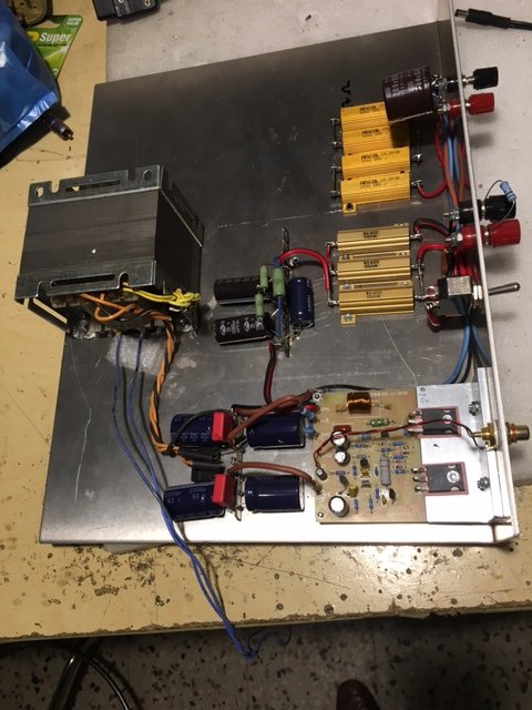

Please try to test really with revers method as described in other thread; you will find that is a very good method that can give you all the information you need.
I have shown the frequency answer with a standard metho ( very limited) and reverse metohd and the curves are perfectly similar; of course the standard method can't have the same swing, same Zout and frequency answer that the reverse mode has.
Regarding the dc current I hope to explain soon the proto I made .
In attach the photo
