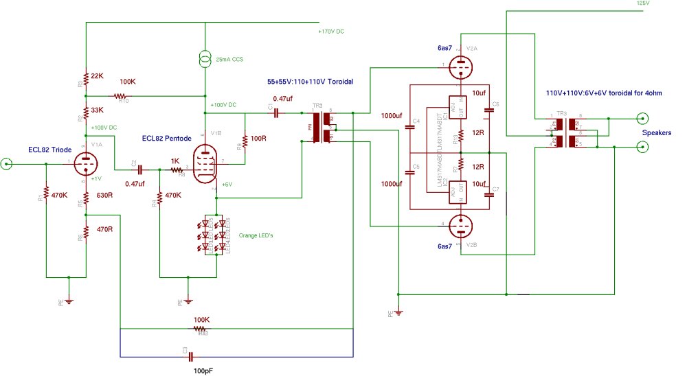

Looks like an excellent candidate for a partial feedback driver stage. Run the first stage at 4mA -1V bias. I have attached a schematic of how I used to do it.
Shoog
i read the "55V + 55V : 110V + 110V" for the interstage transformer and also similar but different numbers for the OPT? what does it mean? thanks.
I use a mains toroidal as my interstage transformer and my output transformer.
The interstage is a 55V + 55V : 110V + 110V. The 55V windings are wired in series and the 110V windings are used as the phase split side. IN this way I get 1:1+1.
I use mains torodials as the outputs with the 6V secondaries as the output secondary.
These work well in this setup.
You need to post your schematic so that we can see if there are any problems with it.
Shoog
Shoog
Yeah I know about the missing grid terminating resistor. I had to add a 1meg once I changed to real 6as7's. It did fine with late model Phillips 6080wa with floating grids though. I think I mentioned this on a later post on the referenced thread. As far as A2 operation I had an email once from some one accusing me of over-dissipation. All I can say is this amp has had flawless operation since 2002.😀coresta said:and how about the missing V3 grid resistor ?![]()
Is your v3 runnig A2 ? 😕 🙂
