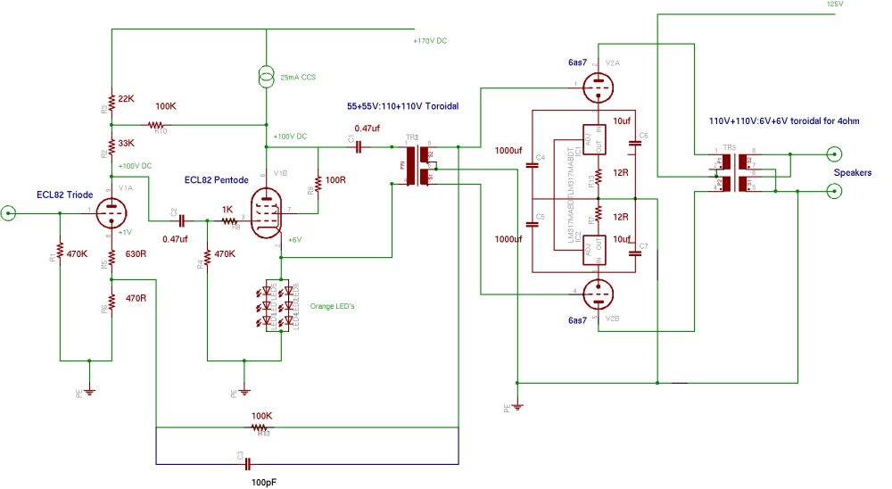

Looks like an excellent candidate for a partial feedback driver stage. Run the first stage at 4mA -1V bias. I have attached a schematic of how I used to do it.
I use a mains toroidal as my interstage transformer and my output transformer.
The interstage is a 55V + 55V : 110V + 110V. The 55V windings are wired in series and the 110V windings are used as the phase split side. IN this way I get 1:1+1.
I use mains torodials as the outputs with the 6V secondaries as the output secondary.
These work well in this setup.

coresta said:
and how about the missing V3 grid resistor ? :bigeyes: :hot: Is your v3 runnig A2 ? :confused: :)
Yeah I know about the missing grid terminating resistor. I had to add a 1meg once I changed to real 6as7's. It did fine with late model Phillips 6080wa with floating grids though. I think I mentioned this on a later post on the referenced thread. As far as A2 operation I had an email once from some one accusing me of over-dissipation. All I can say is this amp has had flawless operation since 2002.:D
