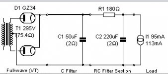

OK, I am slightly confused but this is helping...
The CCS is adding current flow to the circuit? Because they both need to return through the same ground?
So if one channel of amp is passing 75mA and the CCS 1mA is entering the cicuit at the cathode of the triodes then....
The current gets added to B+?
S

Ok, am building the new PS with a 50uf - 180R - 220uf
Then the plan is to split the B+ here for each channel. As I have the circuit open I thought I would put an ammeter in. I used a final dropper of 390R and connected one channel.... and I'm getting 100mA!! And I get 100mA when I repeat this on the other channel
Not good... I thought each channel would only draw 60mA

Er..
You only had one channel connected....so current drawn was not correct..
So only a guess but B+ was high..
You must keep the situation the same..when measuring one channel..
B+ is dropped across your resistors..so if you disconnect one channel and power up the current is different and the B+ will rise..Its only a guess because I can't see what your doing..
This is the difference with the Circuit with the FET,,,its not dependant on current drawn to drop the voltage...what will happen if one channel of your amp stops working to the other channel? B+voltage will change..what will that do to the OP tube bias?
you need to look very carefully at this situation..is it beacuse you only had one channel connected? Not both or is the bias way out?

Thanks again for the help....
So never trust a multimeter that can't handle the voltage when taking current measurements....
My PSU is attached.... I connect this to the OPT's via one 390R in each channel...
I measured the voltage before and after the 390R for each channel
one channel was 333V dropping to 312V (21 / 390) = 54mA
other channel was 333V dropping to 310V (23 / 390) = 59mA
Now I am happier, I can't believe the DVM gave me 156mA, I've been putting this into Duncans PSU designer as a load and pulling my hair out as the results didn't match up..... They do now!!
I will be adding a final 47uf 450V cap to ground after each 390R.....
So I am back on track, have lifted the tag boards and drilled 6 8mm holes around the valve sockets for extra cooling. I have also moved some of the coupling caps out of the way to allow for extra cooling. I have also increased the bleed resistor and split out the dropper resistor...
All of this to reduce heat.... I will test tomorrow night and see how long it takes before the amp is untouchable due to heat!!
I'm dreading someone telling me that my valves are too close together.... I have 1.5inch between center to centre of one channel
and 2 inches between center to center (valves) of each channel.... In hindsight I would have moved the vlaves further apart .... is this going to cause my amp to only be useable for a few hours at a time?
S

Regards Valve distance..
The rule of thumb is that all tubes should be at least one tube width apart(Min) one and a half is better, one tube width between each tube..so you should be able to put another of the same tubes between any on the top plate.. In layout its always better to keep high gain and preamp tubes away from transformers and AC voltages..the mains Tx is a real pain if its by any high gain stages.. And preamp stages away from OP sections.
This is important..
The voltage of your B+ is set by the current drawn (VD across Resistors)
You have minimised this by using seperate droppers for each channel..however the VD across the 180 ohm will alter should one channel go open due to heater fail etc..(B+ may change if this happens) and this may effect your bias in the channel that is still running..Its easy to work this out just calc VD across the 180 Ohm with only half current drawn..is the VD acceptable or not..
To reduce heat further you could reduce the idle current of the OP tubes..bias adjustment as suggested by JMFahey. If the volume you are running it at is acceptable there is no point in running the bias hotter than you need it..
Regards Distortion...Your droppers will drop voltage across them dependant on current..so as the amp draws more current more VD >>more volume..this will change (Sag)..in the power rails..Remember the FET B+dropper>>> VD is not current dependant..its constant.
This may or may not be of interest depends how its running.. 🙂..if you reduce the bias of the tubes again you would/may need to change the value of the dropper resistors..VD will change..so perhaps better to stay with what you have if its running..If you wanted to be able to adjust your bias with fixed bias then you would have to think about B+ VD across your power supply resistors..so you see what a pain using droppers can be..they are current dependant..
So if you get distortion with volume turned up check the power rails and see what voltage you have ..the problem may be Sag..By using a constant voltage drop that is not dependant on current you will still get the heat dissipation in a fet..you can minimise this using two stages shared VD..however you could address the current dependance and Sag..and your bias adjustment would not effect rail voltage..
