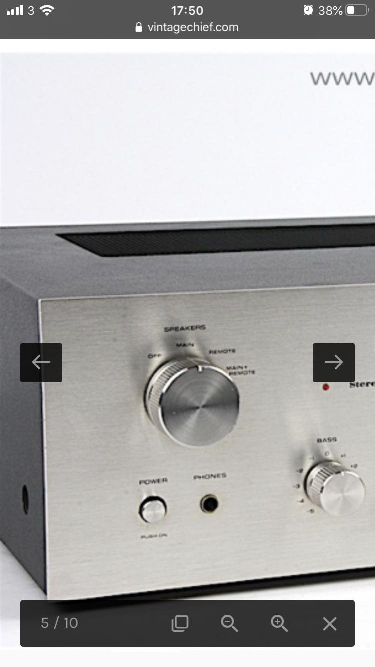

I’m looking for a 10mm diameter latching push button 240v 8amp switch. I have looked on RS and Mouser but cannot find what I am looking for. I want just a cylinder coming out of the face of my amp like the amps from the 70’s and 80’s. At the moment I have 2 metal toggle switches that I don’t like the look of so I want to replace them. One to a rotary selector switch and the other with the switch described above.
Any suggestions would be super helpful.
Something like this. Why is it so hard to find!

These ratings are not common in small, low cost switches. You can use a low voltage,
low current switch of any type you like, rotary or push type, to control a relay with the
needed rating, which does the heavy work.

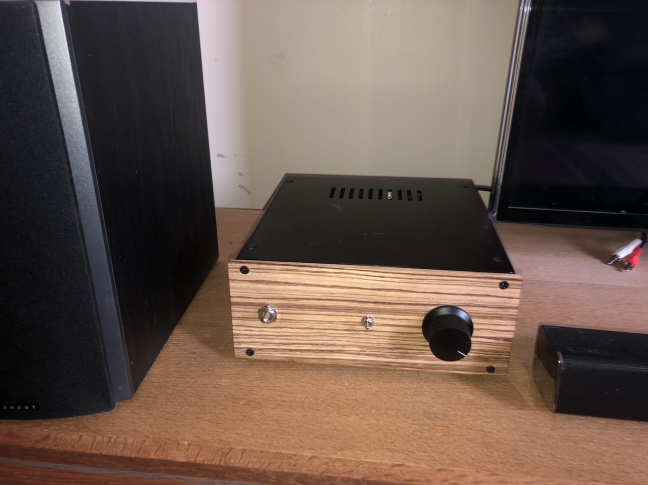

Here is my amp, I don’t like the silver toggle switches. I want a black push button power switch and a black selector knob (the selector will be easy). I like the zebrano wood but it is expensive and will be changed to oak when I do the switches.

Hmm. Maybe the switch-factories aren‘t focused on „our“ on-off switches anymore.
should we instead search for a switch that ha the values we want/need (voltage/current/mechanical touch &feel) and construct the body ourselves?
It's a terrible shame there are so many different relays for you to go through. Fortunately, it is often possible to avoid unpleasant tasks by finagling internet strangers to do them for you.
230VAC relay coil, 30 ampere contacts, £10.08 price in qty=1:
230VAC relay coil, 8 ampere contacts, £3.96 price in qty=1:
If you have an always-on source of DC power which is available when the front panel switch is "Off", you can select different relays having DC coils instead of 230VAC coils.
