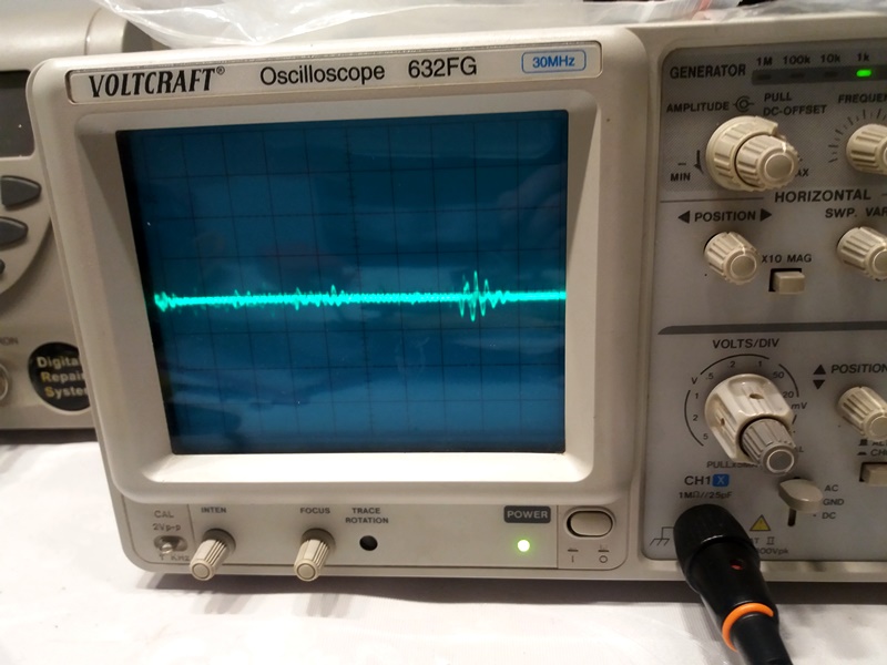

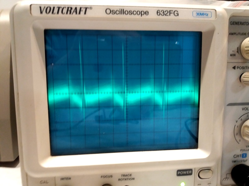

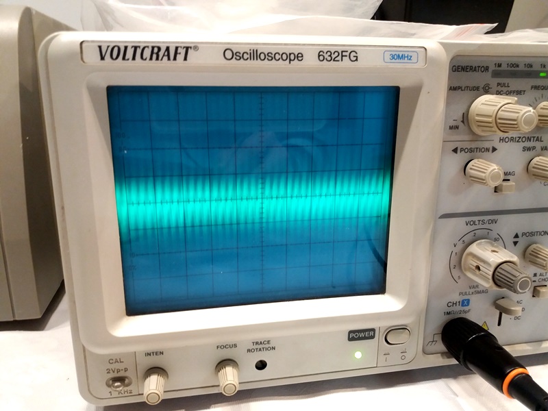

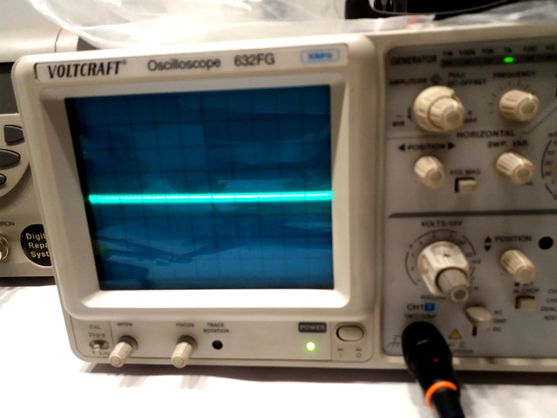

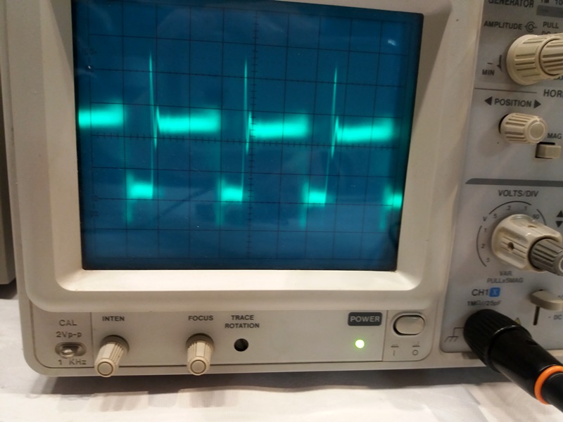

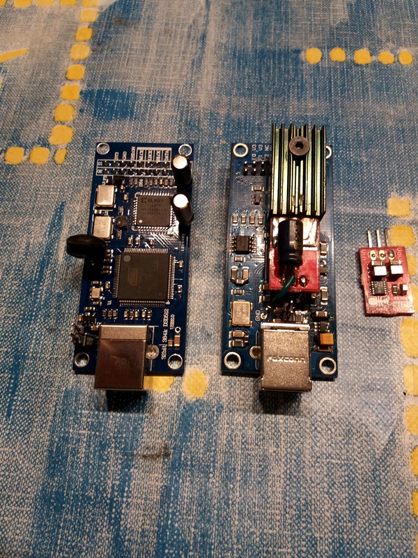

I have chance to try new 3pin lt3045 regulators from Aleš in various positions in building another ak4495 dac.
This regs are excellent... easy to implement and nice sounding. My scope could not measure noise compared to reference gnd pin.
I use mixture of both regulators Tps7a4700 and lt3042/45. I have tried lt3042 on all positions and sound is maybe maybe little to slow (excellent for harsh, overhyped Sabre dacs)... but is full, good transparency, sweet, although on the other side Tps7a4700 is little more dynamic but little harsh, not so controlled, like a wild dog, after let him from appartment 🙂 so you must choose right combination for your gear.
Today I made 1V regulator for xmos usb card.This core supply pin is very important for xmos U8 performance. At last dac that i made it with average NPC regulator (no 1V TPS7A4700 reg exist), but it was hard because of heat dissipation and small experimental board. But it was worth. Sound is more liquid, less harsh, more dynamic, more analog sounded.
With Aleš 3 pin regulator it was simple and see the result... excellent.
First 3 pictures 1V supply pin, 3,3V supply pin and 5V supply pin original design modified with some caps improvement.
second 3 pictures same position with Lt3045 installed. Supply was with batteries. I modified boards that now i have jumpers to choose between usb supply and external supply.
