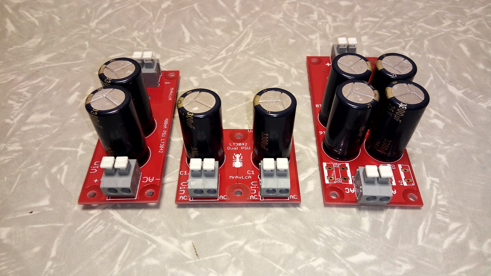

LT3042 and LT3045
Just small update what it is in preparation.
1. Dual 200mA LT3042 PCB
2. 2x LT3042 400mA with CRC filter
3. 6x LT3045 high current output 3A board
These PCB will be ready at the end of next week. Stay tuned for update😉.

Interesting, what output voltages?
Ales.
Looks great. 😀
I guess standard voltages will be 5V/3.3V -- right?
If I'd need e.g. 3.6V for the Sabre, I'd have to change a resistor on board - correct??
Looks great. 😀
@Studley & soundcheck: There will be most common voltages such as 3.3V, 5V, 12V. Other output voltages are also possible by changing set resistor.
@Theodosis: You can always connect two outputs together to get let say +/-12V or you can reverse voltage , but in last case own transformer is a must and ground must not be connected to common ground.

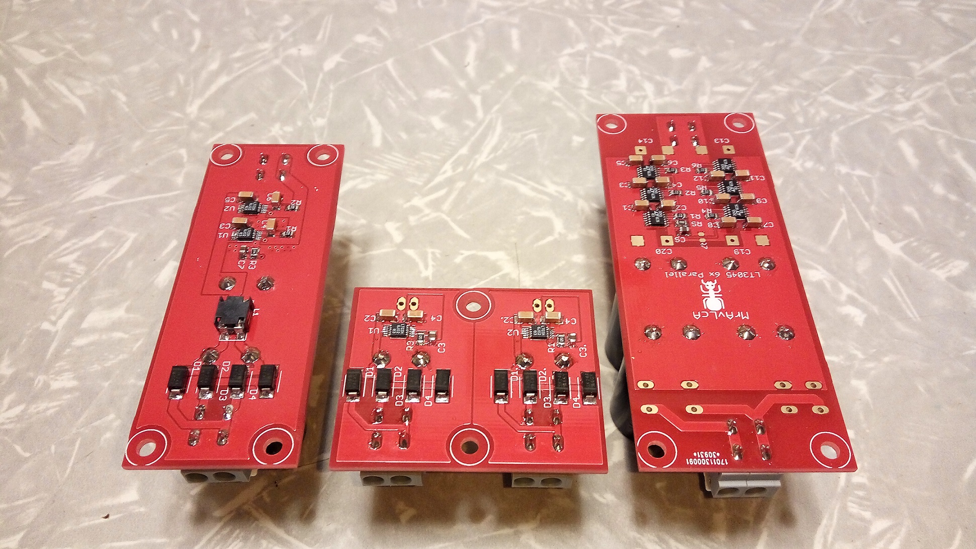

I once more had a look at the new boards .
Some comments/ideas that popped up.
1.
Did you leave out the holes after the rectifier on purpose?
To me these made sense if I want to bypass the rectifier and solder wires right to the board.
2.
I see a common mode choke just on one board. Hmmh. Why is that?
3.
Beside that, I see that you pretty much removed all other filtering stuff known from the TPS7A4700.
No way to add some small Wimas or similar anymore !?!?
4.
Why do you suddenly use the ground plane as ground after the 2nd buffer cap?
Wouldn't it be better to keep the trace shape symmetric towards the LT3042 ?
Similar questions I have when looking at the output. Why using the ground plane?
But hey. I'm not a board designer. Just read this or that application note from this or that device.
5.
Would be nice to have some additional holes at the Rset.
This would make live much easier to introduce all kind of resistors for setting the voltage.
Especially sourcing high-quality throughhole resistors is much easier.
E.g I'd have to use two Rs (e.g. Vishay-Dale CMF55-143 20&16,2k) in series to achieve the 36k for e.g. 3.6V out.
People for sure will have to play with different R combinations to achieve this or that voltage.
You might consider this on the layout.
6.
From what I know, there is this "capacity/10" rule when paralleling caps for power supplies. You always seem to use equally sized caps.
Any pros and cons?
7.
I don't know how other people see it. I would like to see the terminals
out by default to avoid associated parasitics. At these quality levels everything counts.
You can just put them in the bag. People can solder them in - if they like - later on.
Anything else? Hmmh. For the moment I ran out of questions/ideas 😀

Just to follow up on my comments.
By coincidence I stepped over a Salas LDO board image.
It seems they are not using the groundplane as common ground.
Interesting.
I think people want a clean/defined return path.
And also separate the buffer cap charging section (input/high current section)
from the rest (low-current) of the board.
I don't know how much impact all this might have.

1. Yes, you can connect DC before diodes. On the 400mA version there is also marking on the PCB.
2. It is because of price reduction and not every board has the same purpose.
3. I don't quite understand what filtering do you mean? To fit some bypass caps over diodes? If that is the case you can still do that and solder caps directly on the diodes. Now there is more space between them.
4. There is GND ground plane on both sides of the 400mA PCB. It helps to spread the heat evenly across PCB and better sink function. I try to avoid those heatsinks, as folks really know how to make a mess with them.
5. This resistor is critical for performance of the LT3042 and LT3045. So inserting through hole resistor is bad idea. Long leads will just bring noise into the circuit. I am sure that almost every electronic store has 1% 0805 resistors for every common voltage setting.
6. Can you point me to this rule? Anyway there are always smaller capacitors after big ones. TPS7A4700 has 47uF tantalum to avoid ringing from SMPS, but a lot of folks are afraid to use SMPS in audio, so it is a bit of waste. I excluded it from LT3042 PCBs to reduce price and also because LT3042 performs worse than TPS7A4700 when it comes to SMPS.
7. Pictures attached were for reference only. When PCBs will be shipped, big capacitors and connectors will not be soldered into the PCB.
Interesting.
Unfortunately most of us are lacking some serious measuring equipment to evaluate such case.

1.
Diodes add their own parasitics and cause a voltage drop. That's not necessarily a good thing.
Especially if you feed DC only.
And. Why is just the 400mA version different? You had it right on the TPS!?!?
2.
Price reduction?? Come on. People who buy your devices look pretty much for no compromise solutions.
Why going up a step up with the LT3042 and then several steps
down on the peripherals. That doesn't make any sense to me.
The boards differ only in the current capabilities? I'd expect the very same layout for all of them.
What does a "different purpose"has to do with it!?!?
Except you want to cut cost again.
3.
You had taken provisions for additional capacitors in the past.
Beside that.
Do you still have ferrite beads in place to fight e.g. spikes ??
4.
Using a large area, which might be the RF shield, as heatsink is IMO OK.
But it shouldn't interfere with (temperature) sensitive (ground) pins.
The IMO probably best approach would be to have ground traces in place
and to keep the shield/heatsink separate.
Different currents, noise, temperatures (causing noise again) etc. shouldn't be mixed up.
Obviously all different grounds would have to be stargrounded at the optimum spot.
And again. I'd apply the same structure to all boards!

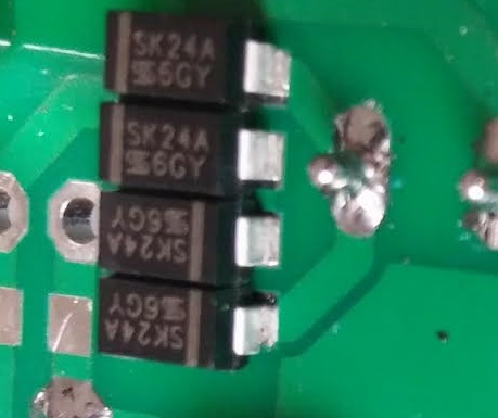

2.
3.
Beside that.
4.
