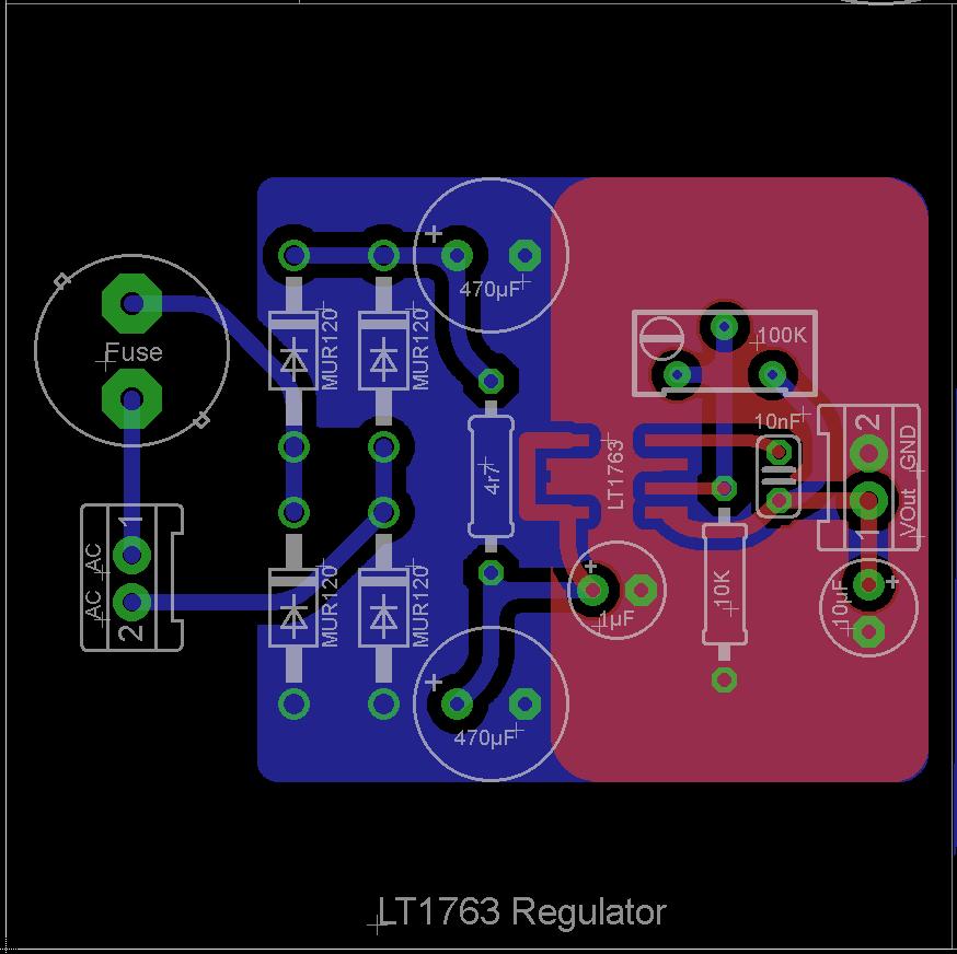

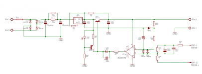

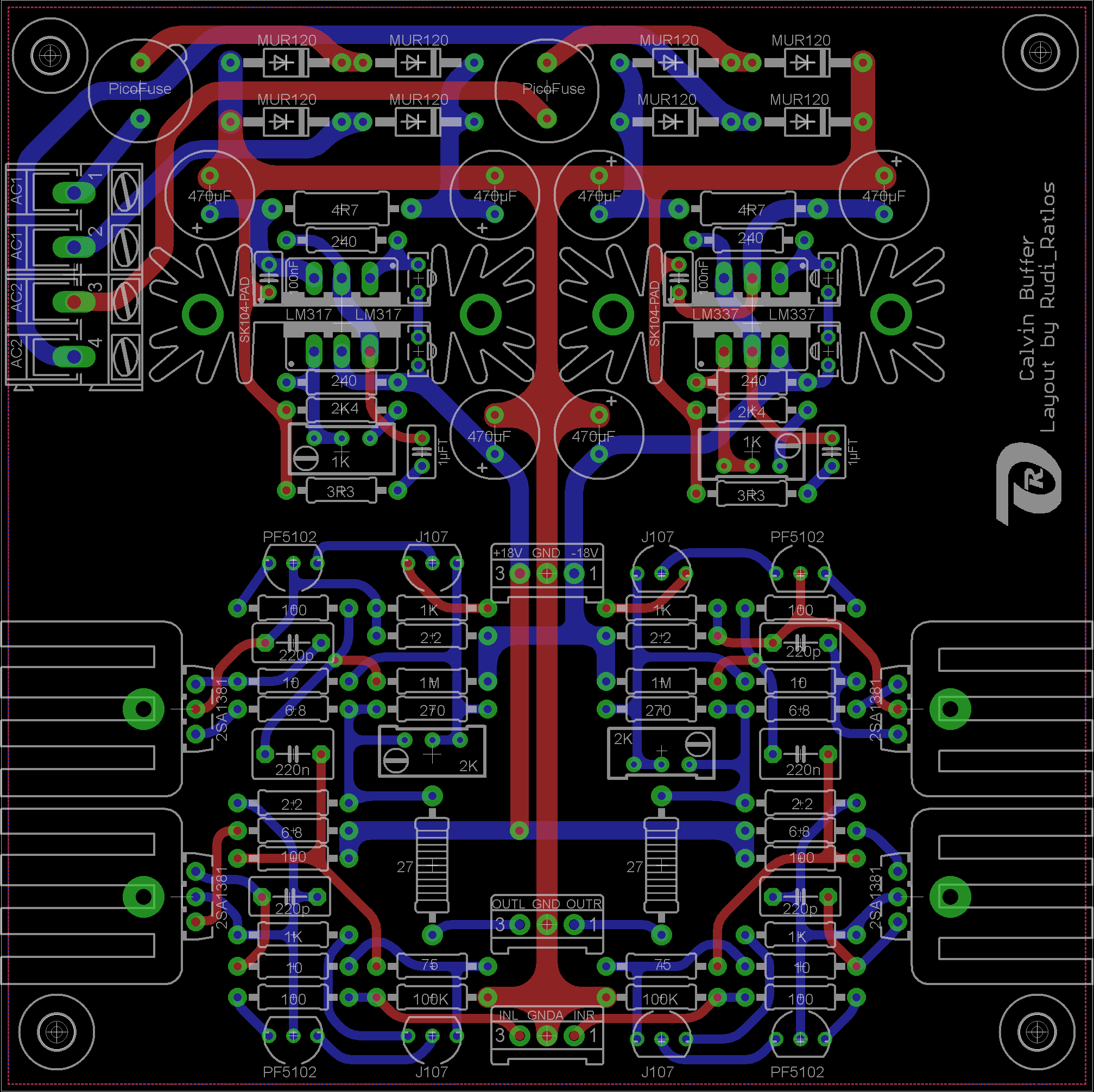

@ K i n g P i n: I have received a couple of the PCBs, shown in image 1, some days ago.
The results that you have published, look very promising !
But: I will never be able to solder the TPS7A470x - regulator in its QFN package. I do not have the means to do this!
I do not dare to ask Ales (mravlca) to solder the TPS7A470x on the few couple of PCBs that I have, since I do not want to compete with his offers in this forum, ebay, ...
Ales: be sure that I will not offer the shown PCB in this forum!

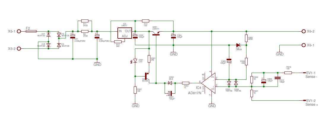

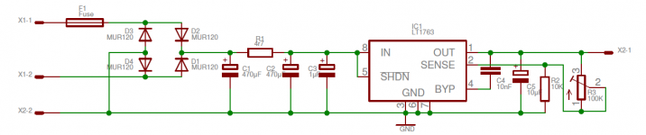

But, to go on with my own needs: I did a nice (?) layout of a symmetric LT1763 - LDO - regulator (image2) and wonder , if it will do a nice job as well!
Best regards - Rudi_Ratlos

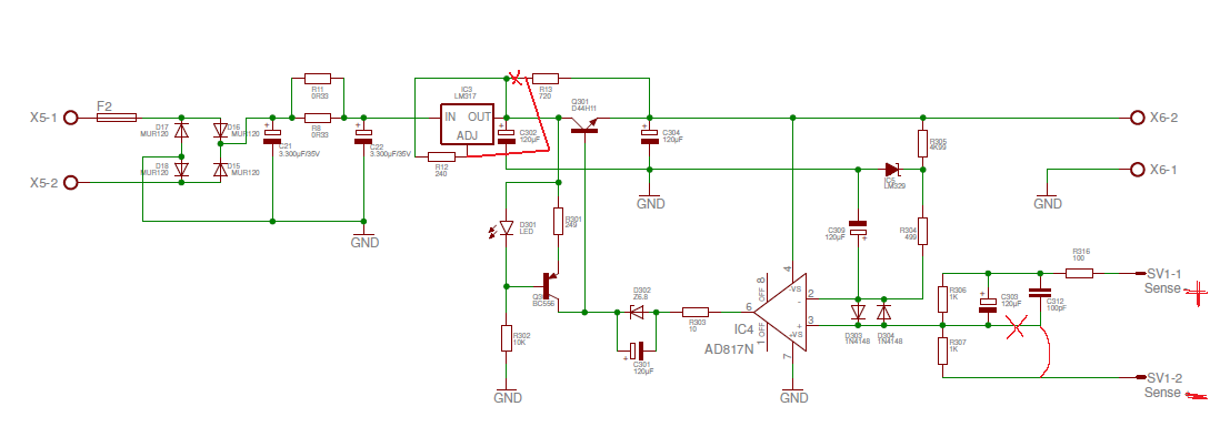

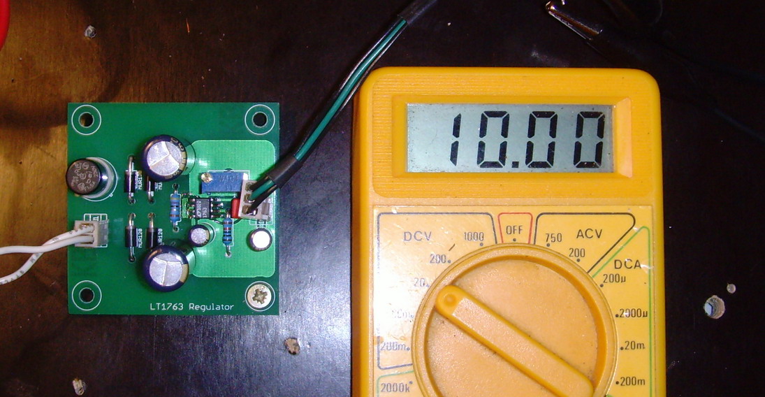

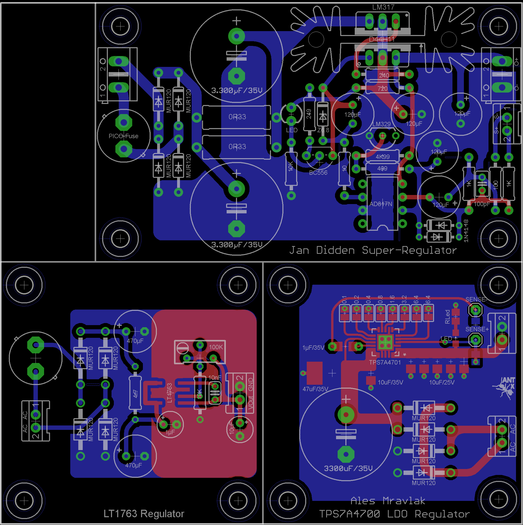

Ales: thank you very much for your kind offer! I will take it - for a very few PCBs only.
As you know, I am not able to "measure" the performance of the PSUs that I have, but maybe that I will "hear" some differences.
From left to right, see images below:
1) SALAS Shunt Reg
2) TPS7A4700 based PSU
3) LT1763 based PSU
I will connect the TPS7A4700- and the LT1763 - PSUs to SALAS' "Hypnotize Pass-B1-Buffer and will tell you (compare) the differences that I hear (if any).
But this will of course take some time!
1) SALAS Shunt Reg
3) LT1763 based PSU

rhythmsandy: I am sorry that I did post the result of my comparision.
I have indeed tested the Pass B1-buffer being operated from 3 different PSUs:
- from a SALAS shunt regulator on his "simplistic B1-buffer" PCB
- from a dual LT1763 PSU operating my RPRE - B1-buffer (image 1)
- from a dual TPS7A4700 PSU operating my RPRE - B1-buffer (image 2)
Even though the output of the SALAS buffer looked very good on the oscilloscope, I was not able to listen to it, because my setup is producing a much too big volume.
It is not able to play quietly. This is of course a problem that I have caused myself, but I did not yet find the solution for it.
Concerning the LT1763 vs. TPS7A4700: both PSU regulators produce a very low ripple current (30-40µV vs. <10µV) and have an excellent load and line regulation.
I do not "hear" any difference.
But since the TPS7A4700 is near to impossible to solder, I will stick to the dual LT1763 version.

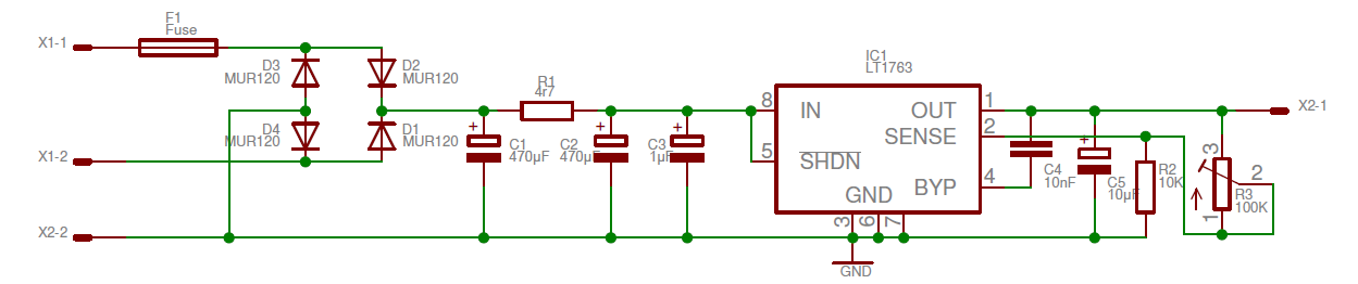

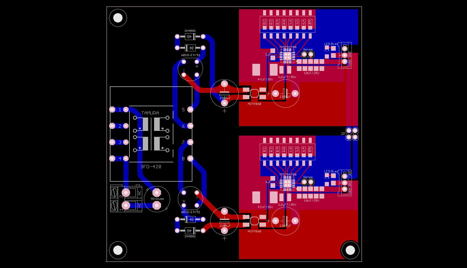

dual LT1763 version what you mean by that?
Fillipowich,
Dual-LT1763-PSU means: putting two LT1763-based PSUs on a single PCB (size of which is 50 x 100mm).
You can either configure the outputs as two separate +VDC outputs or - by putting a cap on jumper JP1 in case you are using a transformer with two separate secondaries - you can configure it as +/- VDC outputs.
I - for example - need a +/-10VDC PSU to operate my Pass B1-buffer.
