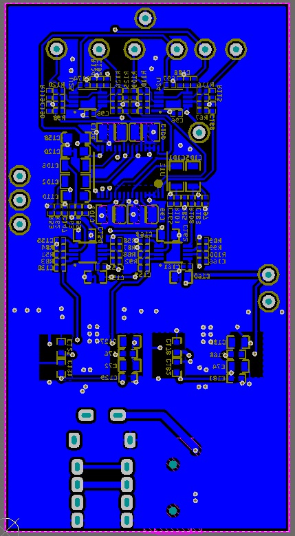

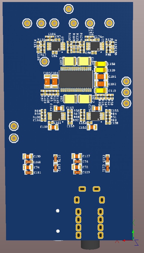

Can you post a circuit and a picture of your PCB layout- very difficult to help without this basic info.
Can you post a picture of your layout?

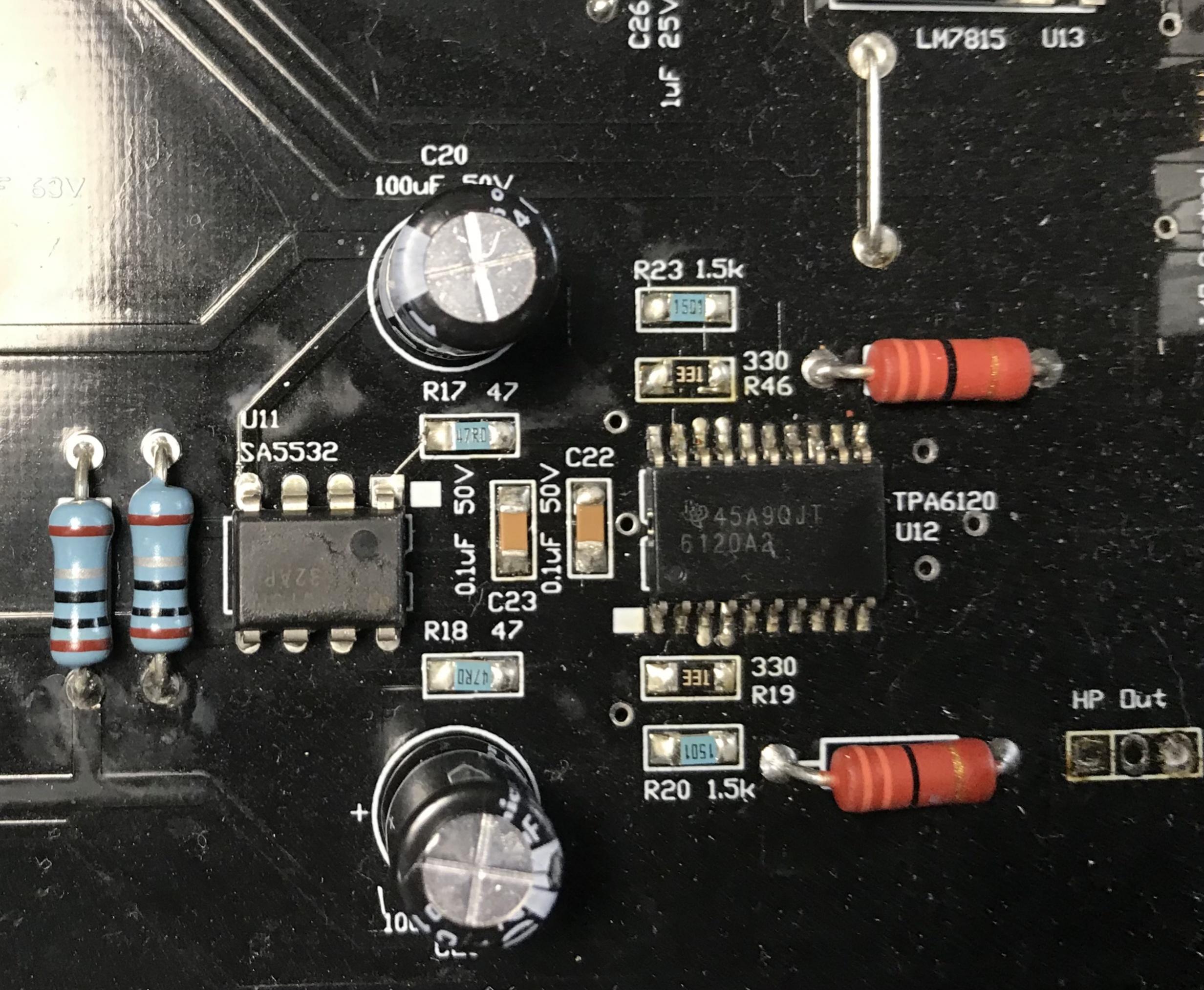

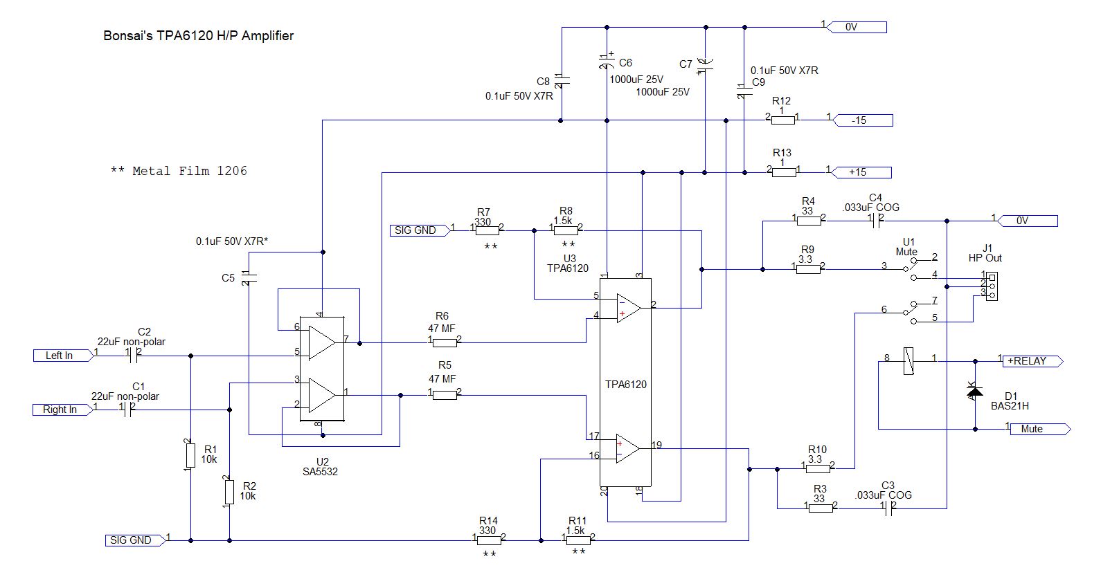

Here is a picture of mine. My gain is set to 6x and it works superbly.

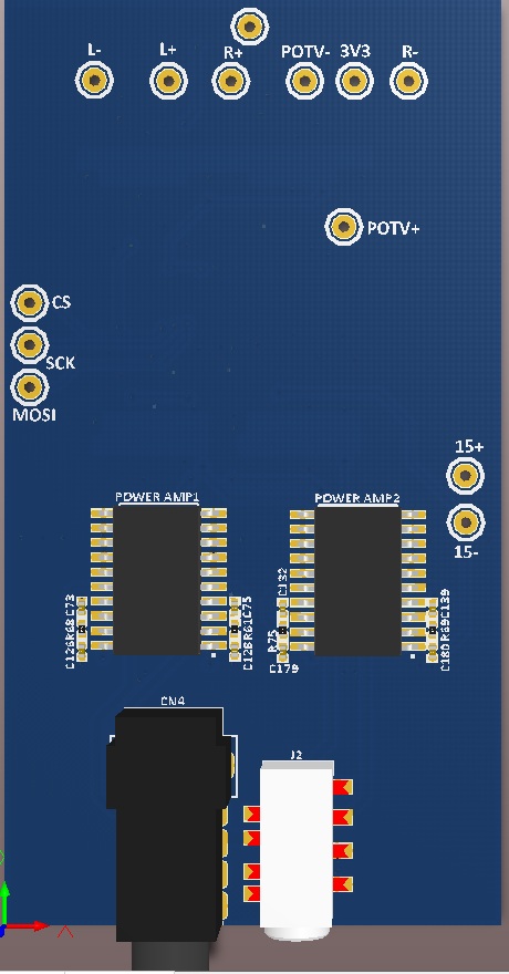

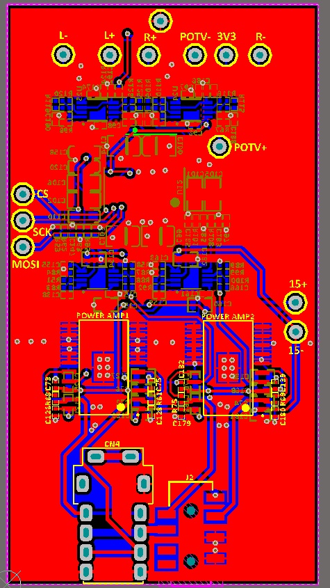

Pictures are attached.

These schematics are confusing as hell. Did a circuit of this relatively modest complexity really have to spread out across 4 entire pages, out of order no less? And who in their right mind orders their input pins L- / L+ / R+ / POTV / 3V3 / R-? First rule of differential signalling, always treat your signal pair as one and keep + and - closely together.
You are using the TPA6120A2 is a noninverting unity gain configuration, why? This is not how these are normally used (see datasheet) - they presumably are not optimized for high common-mode input voltage swing and can be hard enough to keep stable in the regular inverting unity gain configuration with its lower bandwidth. (There is a reason why the datasheet suggests 10 ohm series resistors, although apparently lower output impedance is very much achievable.) This is just begging for trouble, especially when you could go inverting and switch your input signals around accordingly. (Don't forget adding the resistors!) Oscillation can manifest as excessive noise.

Pay careful attention to the Zobel network and the 3.3 Ohm resistors in series with the output.
In addition, the TPA6120 is a CFA device - so very wide BW. Layout is critical - you don’t want any excess capacitance from the inverting input to ground (or any other supply pin) as this will create an additional zero in the response and lead to instability. So, make sure the ground plane is cleared from around the - input.
I also made a 4-layer PCB, so my idea is to maybe clear all 4 layers under TPA. I had no problems with the last layout, there was a small TPA package.
At this 2-layer test board, I cleared planes under TPA and I still have noise. The conclusion was that it was from a noisy input, don't know where that noise coming from, even when I put 4.7k ohm (or smaller) to the ground on the input, without anything else.

It’s specifically the parasitic capacitance from the inverting input to 0V or the + or - rails.
The TPA6120 must be fed from a low Z source.
