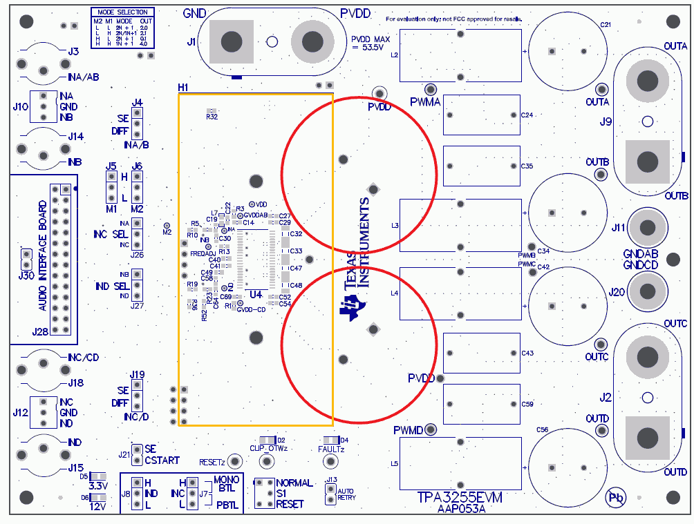

however, i have a case which i would like to mount two of these boards in, but its not quite tall enough ( i dont think, still trying to find out total height of evaluation board).
i will however be removing the heatsinks and have alu plate in place of it, which will be mounted to the extruded heatsink on the side of the case.
looking at the few photos and the documentation, it -seems- that with the heatsink removed, the big rear capacitors would fit on the front face of the board, drastically reducing its height.
could anybody already in possession of the board give it a quick look over.. would the big capacitors fit on the front face? it looks like they would be quite tight with the inductors there..
alternatively i could swap them for slimmer, taller caps, also mounted on the front.
Are those capacitors on the signal path? or are they power related? would mouting them on a daughterboard connected with short (circa 8-10cm) , fat wires cause problems?

from what i can see the heatsink is the only thing blocking them from being on that side anyway, nd i plan to replace that. although id need somebody with the board to confirm this, as they *might* hit the inductors there.. looks close.

if you have the eval bord, would the existing caps fit on the front if the heatsink was removed? not sure if they would hit inductors L3 and L4..

if you look in the pdf for the 3255 you can see clearly the pins for the big caps coming thru to the front, they ar also in a different location to those shown in the board schematic in the same document, which, on closer inspection, is the schematic for the 3251, not the 3255. hence i have no way to actually work it out for myself without buying the damn things
The big caps (4700uF) are there for their ESR performance and current capability not so much for their capacitance.
"High voltage" caps with low ESR and high current isn't something every vendor offers. That's why i am saying, you most likely get away with only 2x2400uF due to their excellent ESR/current performance.
They should fit nicely on the top side.
No, it won't fit:

i am going to pull the trigger and buy these badboys. i will assume i can find a solution to the height issue. either by buying other caps which will fit, or by adding very short horizontal extensions from the solder pads across the top of the board, to shift the big caps sideways until the fit. removing the heatsink will free up a fair amount of space, and i can design my replacement to fit the space i have.
