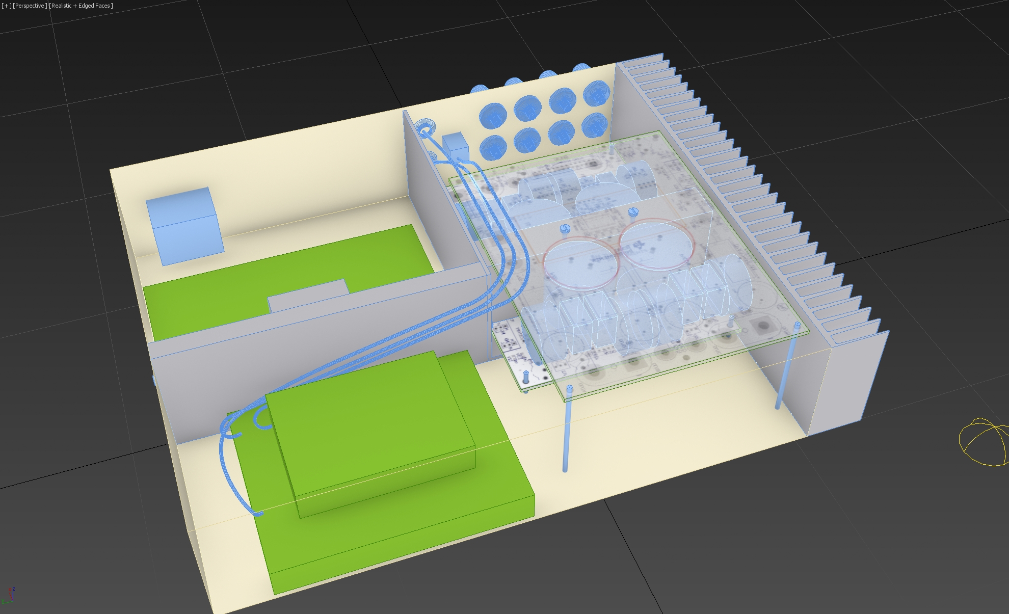

Robin--can you throw out a screenshot of the wireframe (or a quick render?). I'm not following your layout that well. Essentially you're bolting 2 such boards to a 2x4 cm bar stock, which then is end-bolted to the heatsink? To a first order, that seems to be grossly underutilizing your heat sink area on said box. Is there something preventing you from making a larger, if less pretty bolt-on aluminum spacer that would allow you to place the two boards horizontally down the length of the heatsink (and thus actually take full advantage of said heatsink)? Some careful work with sandpaper (up to maybe 1000 grit?) will give you more than enough polish to keep the heatsink paste thin.
yeah sure.. ill knock a quick screengrab out.
from my perspective the main design limitation is the fact of 2 thermal junctions between chip and heatsink.. not very efficient. obviously the size of the first junction is limited by the heatpad on the chip .. the second, by the crossection of the stock i choose, which could be bigger if necessary.
mounting the evm directly to a large heatsink is pretty impossible given the board layout, and even directly mounted, youd only have like 1cm2 of contact with heatsink (the size of 2 of the heatpads)

here is a quick screengrab of my current layout proposal. obviously incomplete..
the top evm is shown ghosted so you can see the alu bar below, and the bottom evm below that.
two green boxes in foreground are minidsp and bluetooth receiver.
green plane in seperate (shielded) compartment at back is PSU.
you can just see an aluminium block on top of psu which replacces heatsink there. this is bolted to 1cm thick plate in front of it, which is in turn bolted/thermal greased to bottom and other side of case. i figured that would be sufficient to transfer psu heat to case exterior..

Can you turn the boards 90 and stagger height/invert as you have already? Then two alloy blocks to thermally mate the chip to the heatsink. As it stands, you're basically not even using the heatsink.
im not 100% sure i follow.. why am i basically not using the heatsink.?
assuming i can get good thermal contact between the end of the bar, and the heatsink, it would be conceptually similar (although not as performant) as a single piece of aluminium with the chips attached on one end, and the heatsink fins on the other. (a big "T" shaped heatsink )
considering the contact area between the bar and the heatsink is 8cm2 (could be bigger of course, i could double it without changing the design too much)
and the contact area of both chips (combined) is less than 1cm2 id imagine the bar/heatsink junction thermal resistance would be much much smaller than the chip/bar junction..
rotating the boards 90 degrees would require a different case and design.. possible of course if necessary.
in the end its the same concept as "heatpipe" designs, just with a massive aluminium block in place of a heatpipe..

My intentional saying is that the conducting area is not limited by the heatsink but the outputstage-FET-area of the TPA32XX IC. (Which is rougly ~15mm^2)
(A not unusual non-native-speaker understandingly problem 😱 - what a sentence..)
Because you're contacting a single 8 cm^2 section in the middle of the heat sink and assuming it will spread the heat out past the couple nearest fins, which is really doubtful. You'll have a massive heat gradient from the center of the heat sink to the fins at the front/back extremities.
Having two point sources and a horizontal heat spreader bar at least helps you get more out of the heat sink you have.
Edit--also what the good doctor wrote, although having a large aluminum block is going to help "absorb" transient heat better than the EVM heatsink.

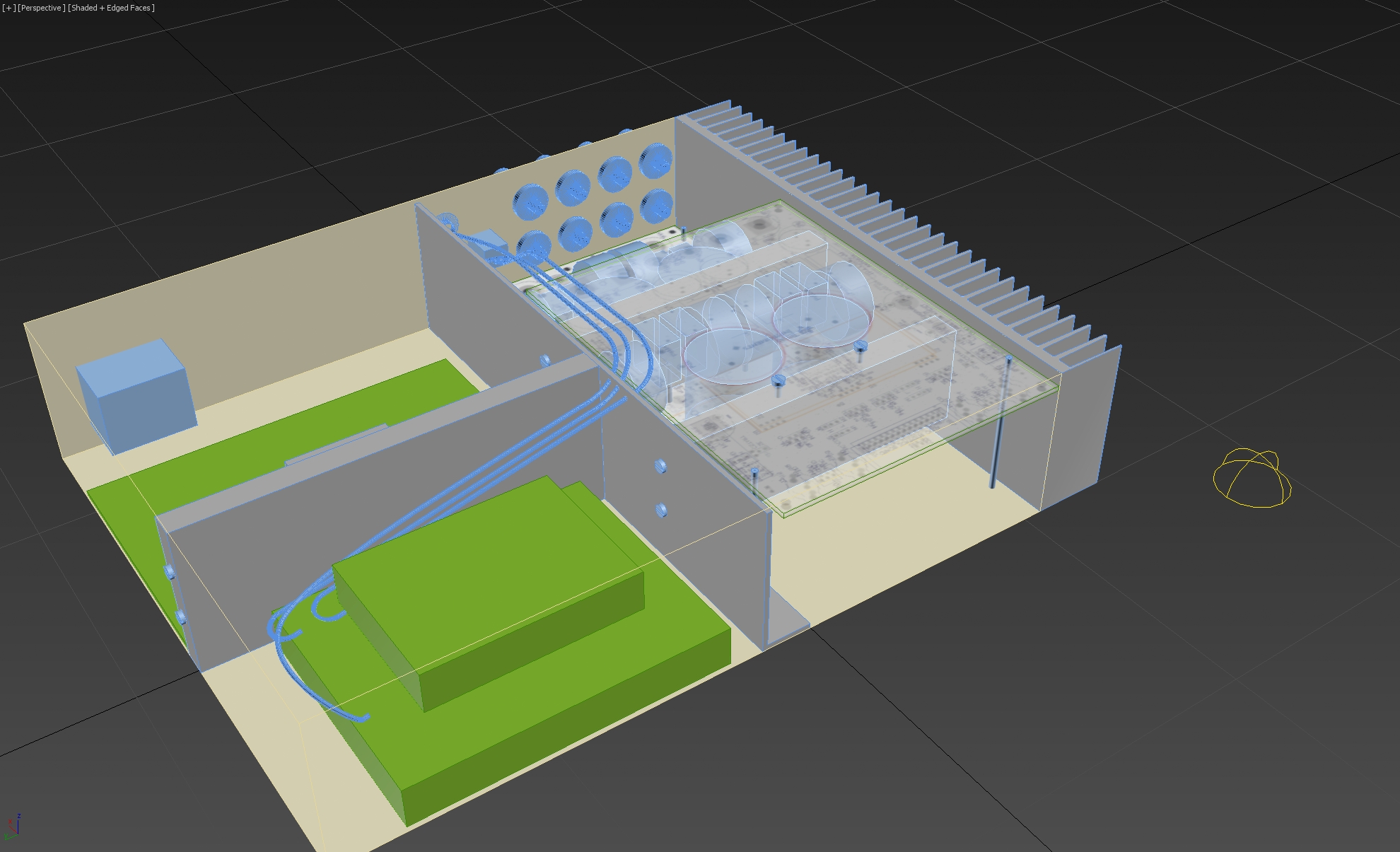

ok.. new version with top amp flipped round, and moved as far to back of case as possible.
this allows 2x slimmer aluminium bars. one 4cm x 1.2cm cross section bar for each amp.
heat should be spread more evenly across heatsink in this case.

Better!
Instead of skinny and tall, can you fit as large a square bar in between the large capacitors and other circuitry? E.g. 2 cm x 2 cm. Essentially trying to get as much horizontal coverage as possible. The giant slug of aluminum known as the bar will definitely help with thermal transients.
with the amps this way round, thats about the limit in the space ive got.. particularly the front amp, there is only 15 mm horizontally between the big caps on that, and the inductors on the back amp.. so i think thats about as far as i can go.

Almost every better CPU heatsink is made from aluminium + copper heatslug. Also most heatpipe constructions are mixed.
Ok a quick update and a change of subject.
Re. Cooling, ive modified the design to use heatpipes, 2x 45w rated 6mm ones for each board. Contact along almost full length of heatsink. I had hoped to use a copper block on the chip side, but i require a machined block 2cmx5x5, and i was quoted 50 euros for it, so im going with aluminium. Hope that a) i can get a tight enough fitting hole drilled for the pipes that i can still slide them into. Guess thermal paste will help on both counts. B) that i can bend then without breaking any! Ive ordered the number i need, as they are not cheap.
