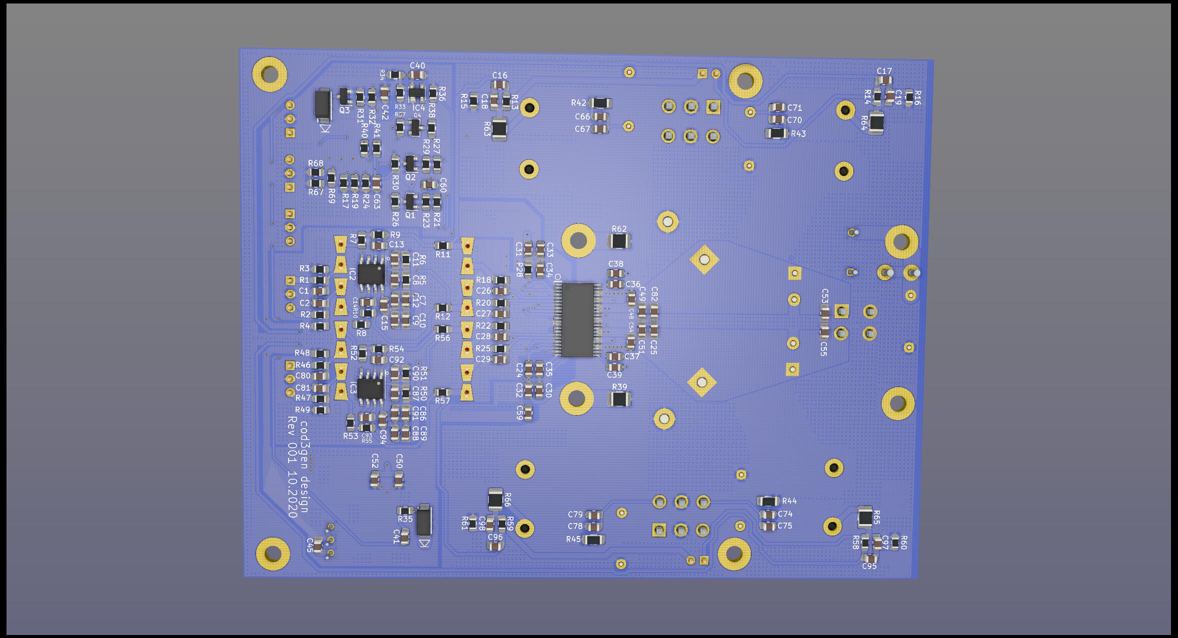

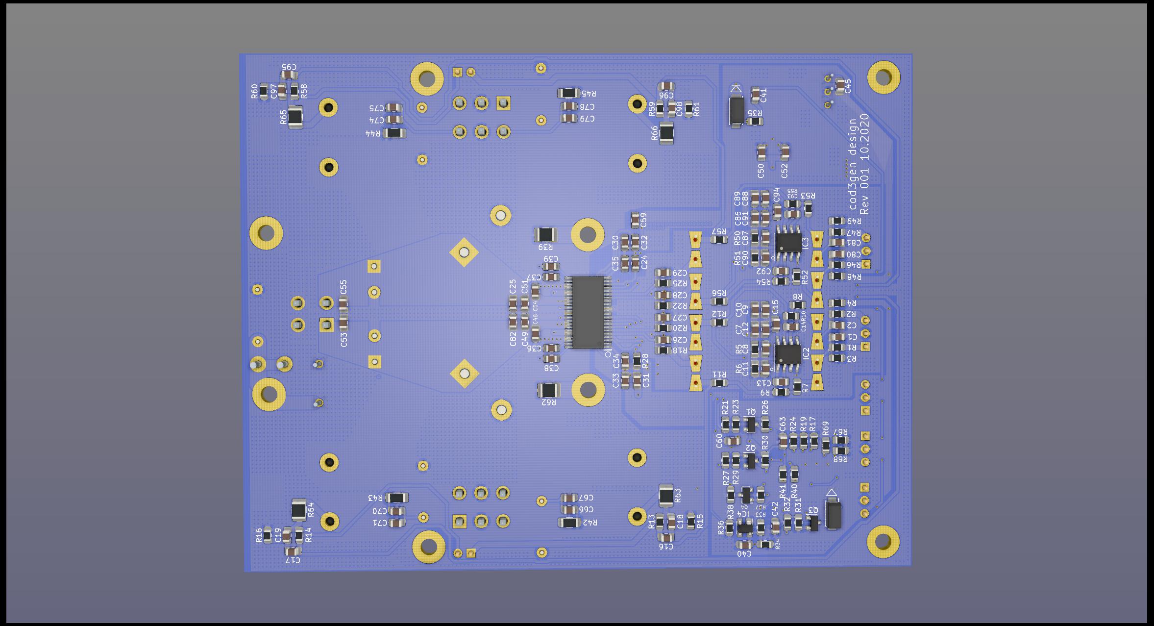

I can drive the board to 44v without triggering !fault. And i have changed my tougths on this, the peaks i hear when playing music may very well come due to incorrect capacitor on VBG(error on my PCB vs. Latest drawing, apparently i have updated some components there after board went into production - mixup is between C24-C26) - Check out IMG_20210206_171233, i have managed to place an 100p C0G here..

Will do a "live" test with 100n on VBG, i was not able to detect change on the scope.
