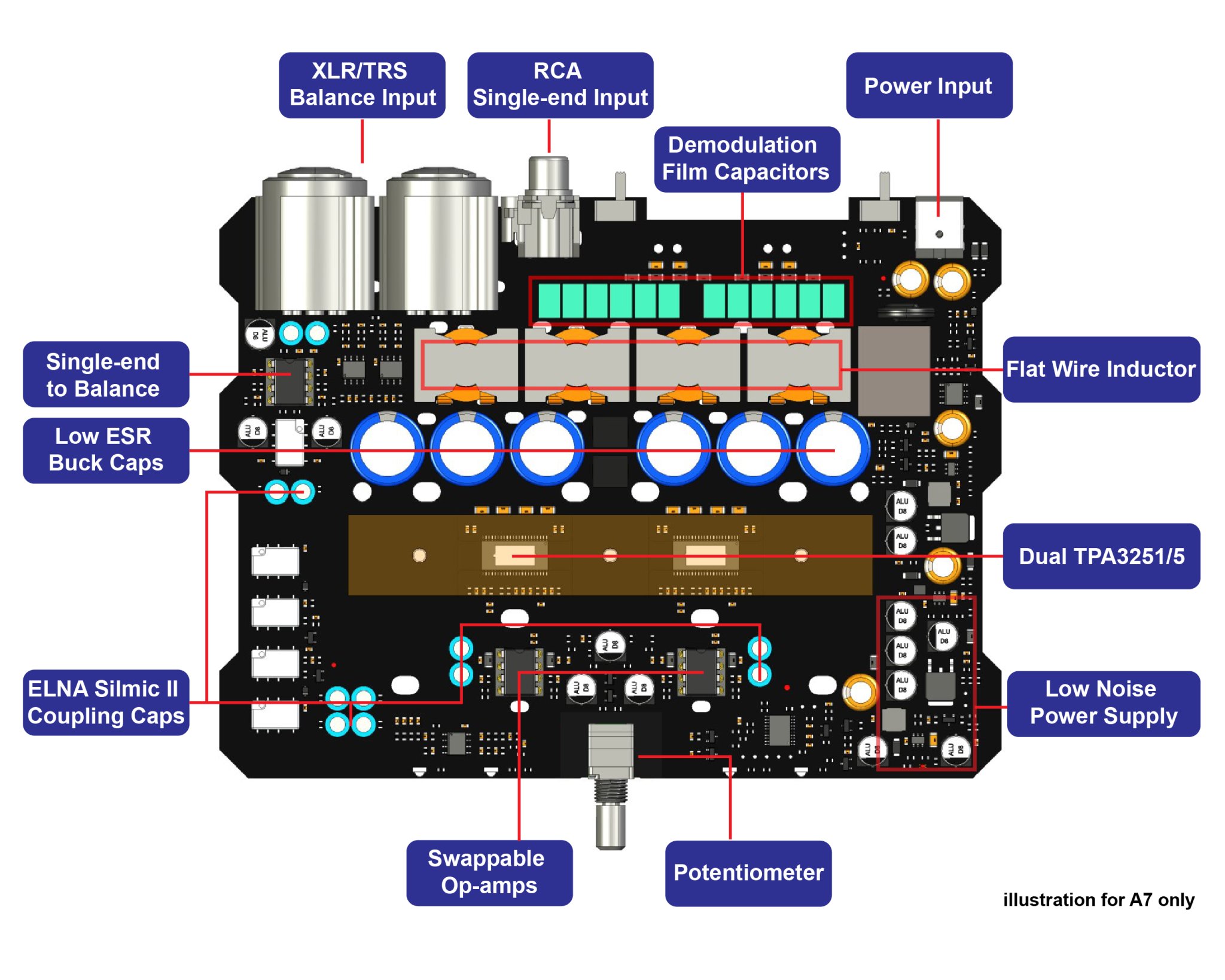

2 questions:
1) Is it better to run and SMPS external to this Board and an all aluminum alloy case, or mount inside with board?
2) Without having to do anything to this PCB, can an Alps 50K pot just be placed between XLR connections and this board?
Thanks all.
Thank you 3e. What would be the best value Alps pot to go with? (I have a spare 50k, but want the best option)
As I'm reading up all the posts here, I believe I'll have to use a 4-gang pot with XLR sockets?
I Would need a basic diagram assisting the hookup. Thanks in advance.
50K is good to go i will say, 10K is typical but may not good for balance DAC and amp as parallel 10K slightly impact on input impedance.
4-gang? you mean the GND pin? you can connect it to enclosure.
I found this thread and assumed I would need 4 gang pot since XLR needs + and - signal attenuated for each channel?
