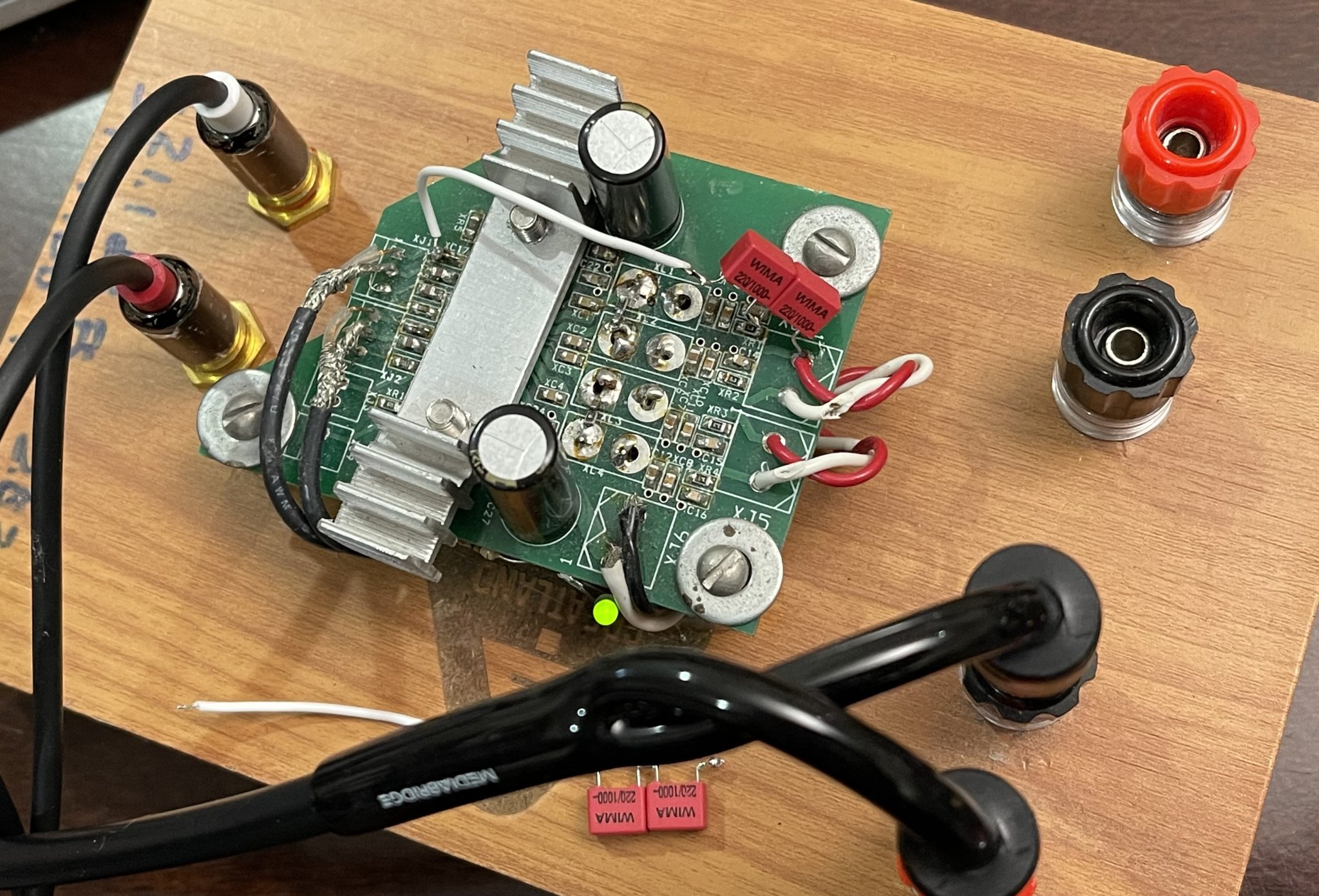

So why does that work as opposed to the whole PFFB from the TI document? Also, would that provide enough stability for global feedback?I do not find the old thread, but here are some essential files concerning TP3118. These things apply also for TPA325x and many others, I assume.
Why specifically a balanced signal? Do you mean just differential or specifically balanced?Those are some really encouraging and amazing results. So it looks like for TPA3118 or 3116, adding a 100pF feedback from speaker out to signal in is what is needed. For amps that are not balanced input (the negative input is tied to GND via a cap), is the feedback cap still the same value?

It is just a different approach. I do not care much about increasing THD and S/N but stress on taming the output series resonant tank -So why does that work as opposed to the whole PFFB from the TI document? Also, would that provide enough stability for global feedback?
without the zobel network.
Should we disable the existing stock TI Zobel for your cap feedback scheme to work? I wired one up on my old first gen TPA3116 amp (layout by member DUG) from 13 years ago (which has a Zobel per the TI datasheet recommendation). Tried listening to it and noticed some distortion on bass peaks and wondering if it is interacting with the existing Zobel? Have not had a chance to look at a square wave response yet on a scope. I am using two 220pF 1000v film caps in series for 110pF. My input coupling cap is a 1uF 100v film cap underneath the RCA, hence I jumpered the onboard 1uF ceramic cap.

To answer your questions I attach my TPA3118 design I use practically for some years in my Li-ion battery powered guitar amps.
Please keep in mind that these modules are designed to be driven by an AFE with 2x2k2 output impedance as part of the compensating network.
With inputs open this board will oscillate wildly and shut down.
